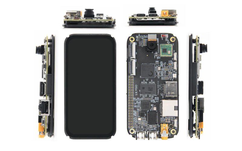

Lilygo has introduced the T-Display K230 development board, designed with a compact form factor ideal for IoT and embedded systems applications. True to its name, the board features a 4.1-inch AMOLED touchscreen display with a resolution of 1232x568 pixels, offering a smartphone-like experience.
LILYGO T-Display K230 Development Board
Lilygo has introduced the T-Display K230 development board, designed with a compact form factor ideal for IoT and embedded systems applications. True to its name, the board features a 4.1-inch AMOLED touchscreen display with a resolution of 1232×568 pixels, offering a smartphone-like experience. Its dimensions are 104x51x15.5mm, and as of March 2025, it is available for purchase at $98.79.
The hardware is powered by the Kendryte K230 system-on-chip, which consists of two 64-bit RISC-V CPU cores—one running at 1.6 GHz with RISC-V vector extensions 1.0, while the other operates at 800 MHz without vector extensions. Additionally, it includes a Kendryte Processing Unit neural coprocessor, designed to enhance on-device machine learning and AI capabilities.
The T-Display module provides a range of wireless connectivity options, featuring a Realtek Wi-Fi module that supports 2.4 GHz Wi-Fi (802.11b/g/n) and a Semtech LoRa transceiver designed for long-range, low-power wireless communication. Additionally, it includes a 2-megapixel Galaxycore CMOS image sensor, capable of capturing 1080p video at 30 frames per second. Connectors are also available for up to two additional cameras.

  • Processor: Kendryte K230 SoC featuring two 64-bit RISC-V CPU core and Kendryte Processing Unit (KPU) neural coprocessor for AI acceleration
  • Memory: 1 GB LPDDR4 32-bit RAM (unclear whether it’s 8 GB or 1 GB)
  • Storage: SD card reader for expandable storage
  • Display: 4.1-inch AMOLED touchscreen with 1232×568 pixel resolution
  • Wireless connectivity: Realtek RTL8189 Wi-Fi module for 2.4 GHz Wi-Fi 4 (802.11b/g/b) and Semtech SX1262 LoRa transceiver for 433 MHz, 868 MHz, 915 MHz, and 920 MHz bands
  • Camera support: Built-in 2-megapixel Galaxycore GC2093 CMOS image sensor capable of 1080p video at 30 fps, two additional MIPI-CSI camera connectors for extra cameras
  • Audio: 3.5 mm audio jack and built-in microphone
  • Ports and expansion: 2x USB Type-C ports, full-sized HDMI port, 40-pin GPIO header
  • Dimensions: 104x51x15.5 mm
