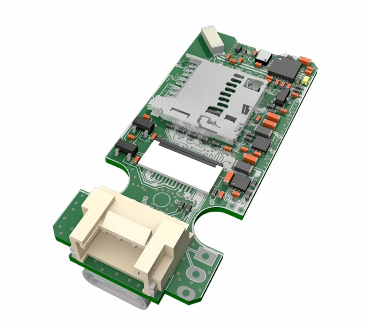

UnitV2 is a high-efficiency AI Camera module, the first M5Stack product that runs on the Linux operating system. The standalone device adopts SigmaStar SSD202D (ARM Cortex-A7 dual-core 1.2GHz) as the core, embedded 128MB DDR3 memory, with 512MB NAND Flash, 1080P camera, 2.4G Wi-Fi and cooling fan.
UnitV2 is a high-efficiency AI Camera module, the first M5Stack product that runs on the Linux operating system. The standalone device adopts SigmaStar SSD202D (ARM Cortex-A7 dual-core 1.2GHz) as the core, embedded 128MB DDR3 memory, with 512MB NAND Flash, 1080P camera, 2.4G Wi-Fi and cooling fan. With rich software applications, hardware resources and easy development tools, UnitV2 is committed to bringing users a simple and efficient AI development experience out of the box.

  • SigmaStar SSD202D
  • ARM Cortex-A7 Dual Core 1.2GHz with Neon and FPU
  • Embedded 128MB DDR3 Memory
  • 512MB NAND Flash
  • GC2145 1080P Colored Sensor
  • Microphone, TF Card slot, UART port, USB-C
  • Wi-Fi 2.4GHz
  • Cooling Fan
  • OS: Linux
