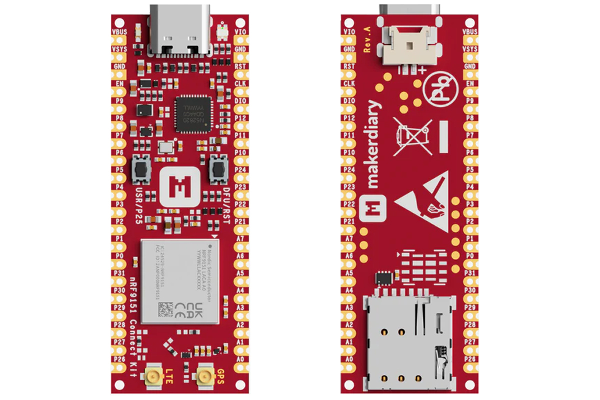

Hardware Diagram (Top)
Hardware Diagram (Bottom)
