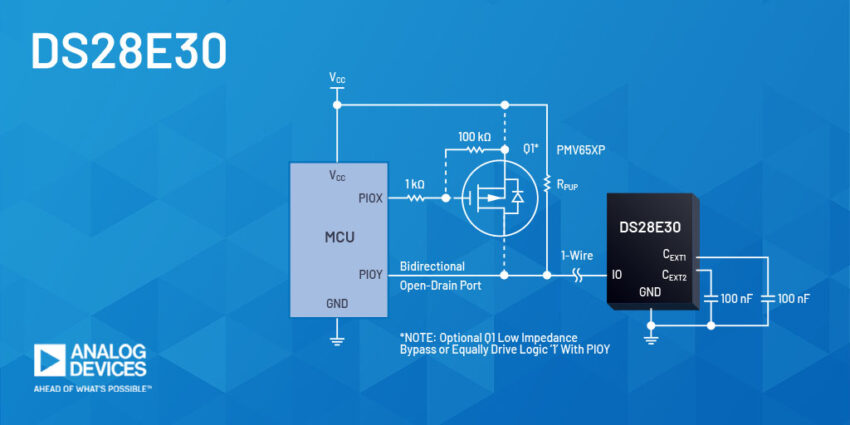

The DS28E30 features a core set of cryptographic tools derived from integrated blocks. These tools include an asymmetric hardware engine, a true random number generator (TRNG), 3Kb of secure EEPROM, a decrement-only counter, and a unique 64-bit ROM identification number (ROM ID). The ECC public/private key capabilities operate from the NIST-defined P-256 curve to provide a FIPS 186-compliant ECDSA signature generation function to support a bidirectional asymmetric key authentication model. The unique ROM ID is used as a fundamental input parameter for cryptographic operations and serves as an electronic serial number within the application. In addition, the authenticity of the chip can be verified with a Maxim-provided public key certificate.

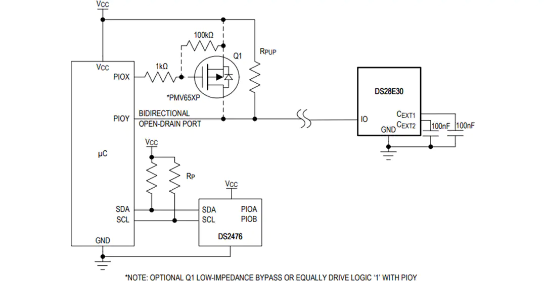

The DS28E30 communicates over the single-contact 1-Wire bus at overdrive speed. The communication follows the 1-Wire protocol with the ROM ID acting as a node address in the case of a multidevice 1-Wire network.
The Maxim Integrated DS28E30 1-Wire ECDSA Secure Authenticator is offered in a tiny 1.2mm x 1.4mm Wafer-Level Package (WLP) ideal for space-constrained applications.

  • 17-bit, one-time settable, nonvolatile decrement- only counter with authenticated read
  • 3Kb of secure EEPROM for user data, keys, certificate, and secure counter
  • Unique and unalterable factory-programmed, 64-bit identification number (ROM ID)
  • Authenticity verification with ECDSA Using preprogrammed maxim certificate
  • Advanced 1-wire protocol minimizes interface to single contact
  • Full-time overdrive communication speed
  • 1.62V to 5.0V input voltage range
  • 5µA typical input load current
  • High ESD immunity of 1-wire pin: ±8kV Human Body Model (HBM)
  • 40°C to +85°C operating temperature range
  • 1.2mm x 1.4mm WLP-4 package
