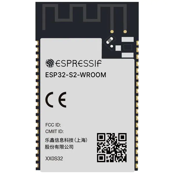

Apart from having an improved security capability, the ESP32 Wifi MCU board, among other features, supports WiFi HT40 @ 2.4GHz and provides up to 43 programmable GPIOs as well as 14 capacitive touch-sensing IOs. It is based on a single Xtensa LX7 clocked at 240 MHz and has a system memory of 320KB SRAM, 128 kB ROM, and 16 kB RTC memory. It also has support for an external SPIRAM up to 128 MB and an external flash up to 1GB. Unlike other ESP32 modules, the ESP32-S2 does not support Bluetooth but comes with an in-built USB interface and has support for LCD cameras.
Meanwhile, the ESP32-S2 is not readily available on Aliexpress at the moment but the board is currently being sold on Digikeyfor just $1.
Digikey also has available in its store two other ESP32-S2 modules, the ESP32-S2-WROOM, and the ESP32-S2-WROVER, both of which are priced for as low as $1.99. The two modules are very similar to each other with almost the same features except for the presence of PSRAM found only in the WROVER module.
Some of the common features and specifications of the ESP32-S2-WROOM and ESP32-S2-WROVER include:
  • ESP32-S2 embedded Xtensa single-core 32-bit LX7 microprocessor
  • 240 MHz Speed
  • 128 kB ROM and 320 kB SRAM
  • 4 MB SPI flash
  • 802.11 b/g/n WiFi 4 with A-MPDU and A-MSDU aggregation, 0.4us guard interval support, bit rate of 802.11n up to 150 Mbps and center frequency range of 2412 – 2484 MHz.
  •  GPIO with PWM, ADC, DAC, and LCD port along with SPI, UART, 12C, 12S communication interfaces
  • Camera interface
  • IR pulse counter
  • touch sensor
  • Temperature sensor
  • Operating Temperature range -40 to 85oC
  • 3.0 to 3.6 V input voltage
