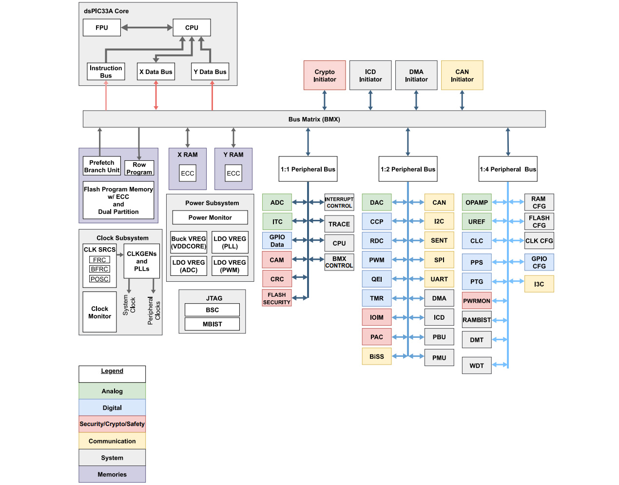

Block diagram of the dsPIC33AK256MPS306 showing its 200 MHz DSP core, memory architecture, high-speed peripherals, and integrated security/crypto modules.
