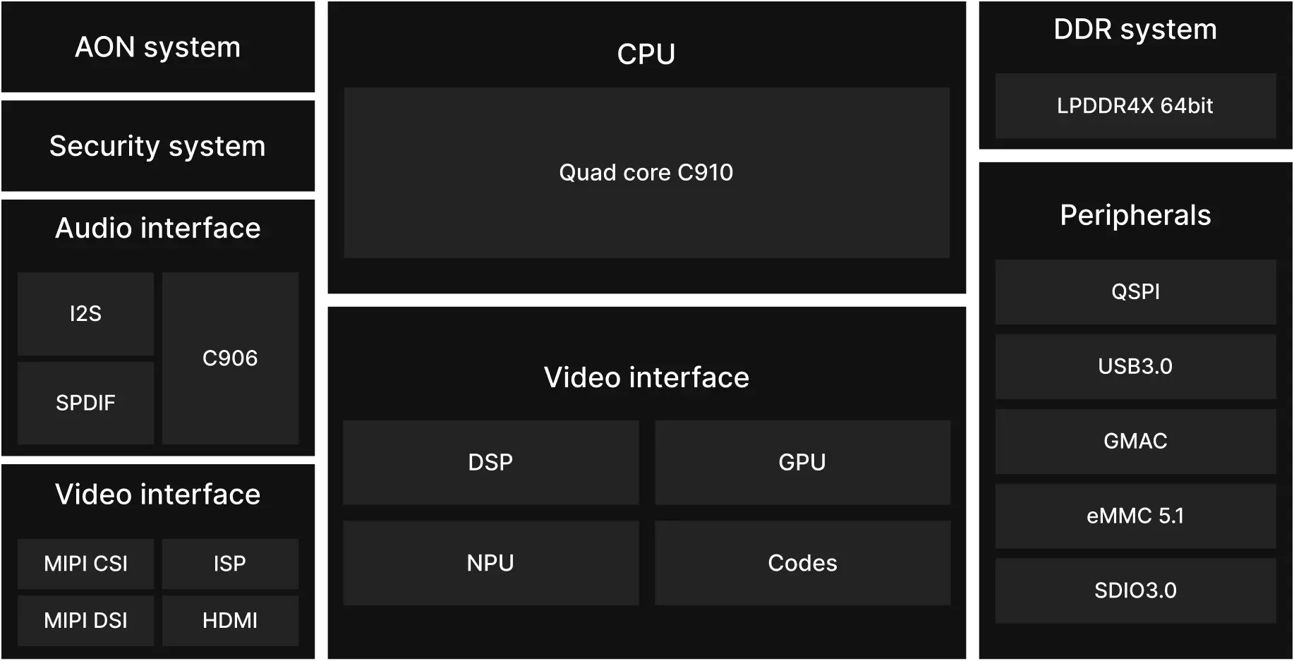

Meles SoC architecture
Regarding connections, the SBC is ethernet-enabled via an RJ45 Port with transmission speeds up to 1000 Mbps, along with WiFi-5 and BTS 5.2. Specs as below give a much better about the SBC. More importantly, the SBC includes robust general-purpose Neural Network Accelerator (NNA) computing power, supporting 4 TOPS (Tera Operations Per Second) at INT8 precision. This high-performance NNA operates at a frequency of 1GHz, ensuring efficient processing for a variety of machine learning and AI applications. This computational capability is crucial for tasks that require intensive data processing and rapid inference times, such as image recognition, natural language processing, and other AI-driven functionalities.
