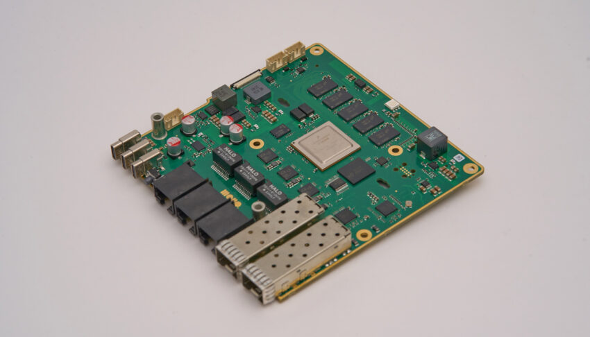

Mono has launched the Gateway Development Kit, a high-performance, next-generation open-source router board built for power users and developers who need advanced networking capabilities. Designed around the NXP Layerscape LS1046A quad-core processor (1.6 GHz), it delivers up to 26 Gbps line-rate throughput, making it ideal for tasks like VLANs, PPPoE, and NAT.
Open-source router board
It features two 10 Gbps SFP+ cages, three RJ-45 gigabit ports, and support for both WiFi 6 and a tri-radio module (WiFi 5, Bluetooth, Thread) via dual M.2 key-E slots. The kit includes 8 GB ECC RAM, 32 GB eMMC storage, 64 MB NOR flash, and robust debugging tools like 100+ test points, a JTAG connector, and a USB-C UART console port. Its polycarbonate case allows easy access to internal components, and active cooling ensures top performance without thermal throttling. Additional features include USB-C 65W PD 3.0 power, status RGB LED, USB-C 3.0 port, and precision monitoring with power and temperature sensors.

  • SoC: NXP Layerscape LS1046A quad-core Cortex-A72 processor @ 1.6 GHz
  • System Memory: 8GB RAM @ 2100 MT/s with ECC support
  • Storage:
    • 32GB eMMC flash for OS and data
    • 64MB NOR flash for bootloader
  • Networking:
    • 2x SFP+ cages for 10GbE connectivity
    • 3x RJ45 Gigabit Ethernet ports
    • Wireless:
      • 1x M.2 Key-E slot for WiFi 6 (2×2 MU-MIMO)
      • 1x M.2 Key-E slot for tri-radio module (WiFi 5, Bluetooth, Thread)
  • USB: 1x USB-C 3.0 port
  • Debugging and Development:
    • USB-C UART console port
    • JTAG connector
    • 100+ test points
    • 8x power sensors and 2x temperature sensors
  • Misc:
    • Status RGB LED
    • Active cooling with fan and heatsink (2x 4-pin 5V PWM fan headers)
  • Power Supply: USB-C PD 3.0 (65W charger included)
  • Dimensions: 120 x 120 mm (Nano-ITX form factor)
  • Enclosure: Polycarbonate case with easy access to internal components
