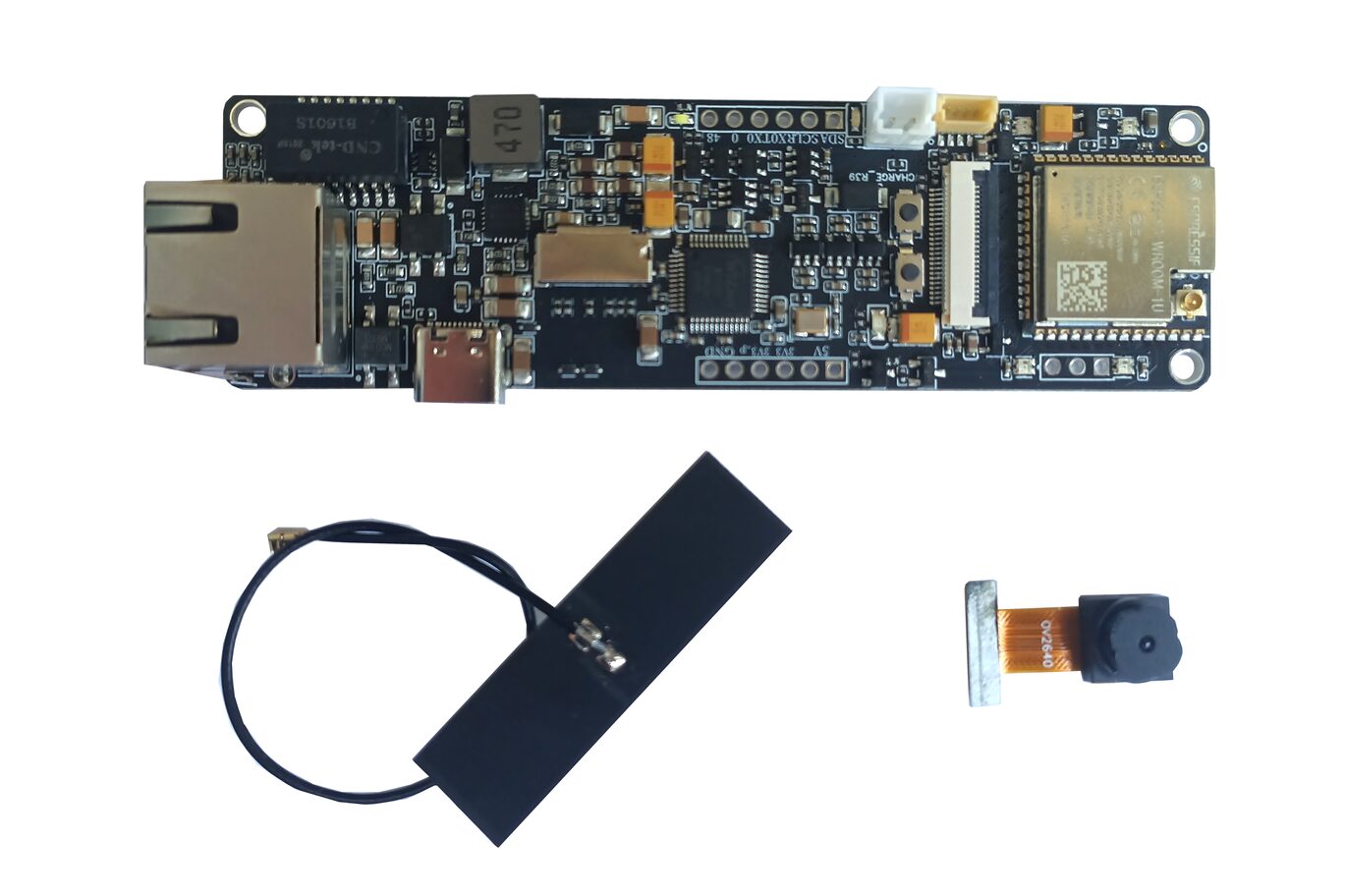

This is an ESP32-S3 development board (16 MB flash, 8 MB RAM) that is compatible with the AI-on-the-Edge-Device framework. It integrates Ethernet with PoE, a micro-SD card slot, a camera with WS2812B back-lighting LEDs, a Stemma QT connector, comprehensive battery management, and a low-power sleep mode that draws just 20 µA.
AI-On-The-Edge-Cam – Image courtesy of github.com/allexoK
Designed by Prokyber in the Czech Republic, the AI-On-The-Edge-Cam is an ESP32-S3-based development board designed to digitize legacy utility meters, such as water, gas, and electricity meters that still require manual reading. It builds on the original AI-On-The-Edge-Cam firmware, while also adding PoE, RGB LEDs, and a microSD card slot.
As the board is built around an ESP32-S3 MCU, it supports WiFi 4 and BLE 5, on top of that it has support for 2MP OV2640 camera, microSD storage, and PoE-enabled Ethernet. and also includes multiple expansion headers (Stemma QT, GPIO, UART, I2C), WS2812B RGB LED, and a USB-C port for 5V power and programming. These features make this board suitable for retrofitting utility meters with edge-based OCR and remote monitoring.

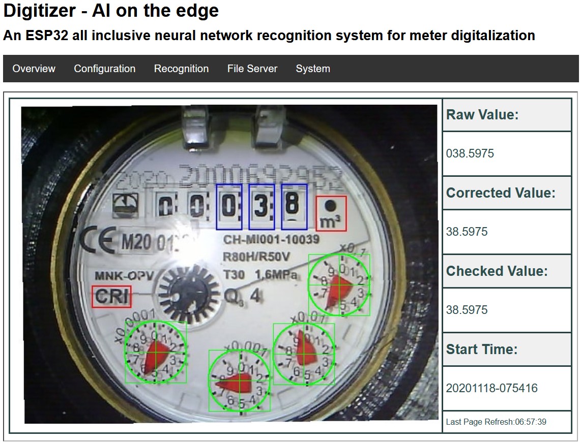

AI Utility Meter Digitizer on the Edge – Image courtesy of github.com/jomjol
AI-On-The-Edge-Cam Specifications
  • SoC: ESP32-S3-WROOM-1U-N16R8 wit dual-core LX7 @ up to 240 MHz
  • Memory: 512KB SRAM, up to 8MB PSRAM
  • Storage: 16MB flash + microSD card slot
  • Wireless: WiFi 4 and Bluetooth LE 5, IPEX antenna connector
  • Camera: 2MP OV2640 camera module
  • Ethernet: 10/100 Mbps RJ45 port with PoE support
  • Expansion:
    • Stemma QT connector
    • 2x 6-pin headers (I2C, UART, GPIO, 5V, 3.3V, GND)
    • 3-pin header (LED control, 5V, GND)
  • Misc: WS2812B RGB LEDs for notifications
  • Power
    •  5V via USB-C, PoE, battery support
    • ~20 µA low-power sleep mode
  • Dimensions: Not Mentioned

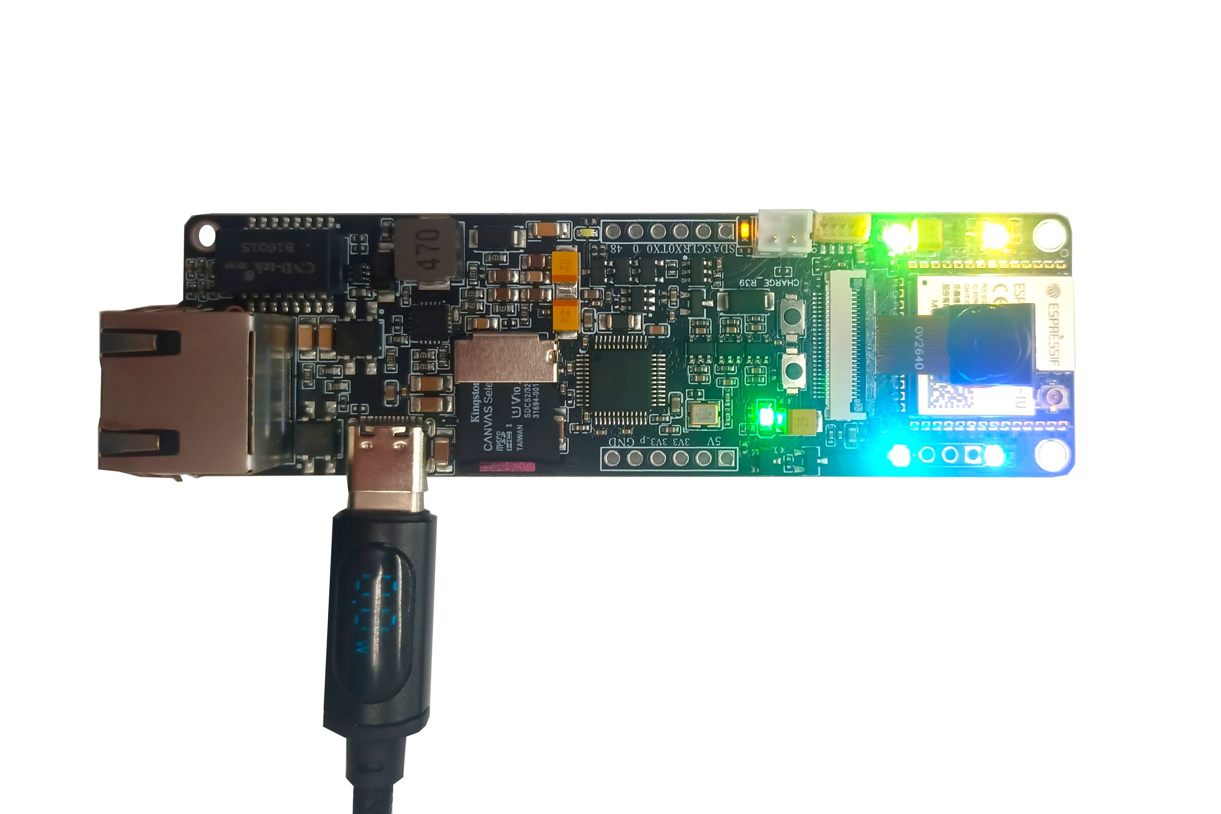

AI-On-The-Edge-CAM – Image courtesy of github.com/allexoK
The AI-On-The-Edge-Cam firmware is capable of reading both the large numeric digits and the smaller dials representing decimal values on utility meters. After extracting the readings, the data can be stored locally on a microSD card or transmitted to a gateway using MQTT or a REST API.
