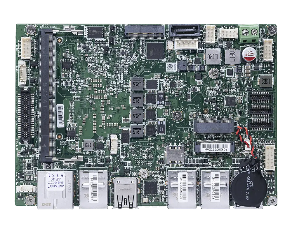

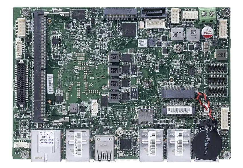

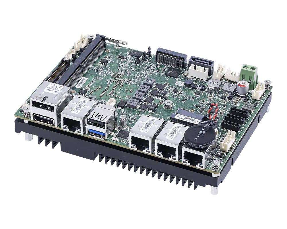

MSI has introduced the MS-CF27, a compact Intel 3.5-inch SBC designed for industrial automation, edge networking, smart gateways, and fanless embedded applications. The board follows earlier embedded platforms such as the MS-CF16 V3.0 and MS-CF19, while adding newer Intel Alder Lake-N, Twin Lake-N, and Amston Lake processor options with low-power operation and multiple connectivity interfaces.
The Intel 3.5-inch SBC supports several processor configurations, including the Intel Processor N97, Intel Core i3-N305, Intel Amston Lake x7433RE, and Intel Twin Lake-N N150. Depending on the selected SKU, power consumption ranges from 6W to 15W TDP. MSI pairs the processors with a single DDR5-4800 SO-DIMM slot supporting up to 32GB memory on selected variants. The platform also integrates Intel UHD Graphics and supports triple independent displays through DisplayPort, HDMI, and LVDS/eDP interfaces.
MSI MS-CF27 3.5-inch SBC With Intel Processor Front

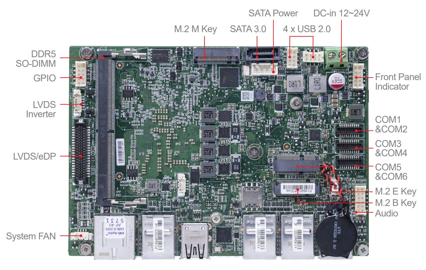

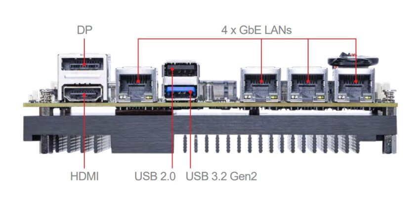

MSI MS-CF27 Specifications:
  • SoC: Intel Alder Lake-N Processor N97, Intel Core i3-N305, Intel Amston Lake x7433RE, or Intel Twin Lake-N N150 processor
  • CPU configuration:
    • N97: quad-core, up to 3.6GHz, 12W TDP
    • Core i3-N305: 8-core, up to 3.8GHz, 15W TDP
    • x7433RE: quad-core, up to 3.4GHz, 12W TDP
    • N150: quad-core, up to 3.6GHz, 6W TDP
  • GPU: Integrated Intel UHD Graphics
  • Memory: 1x DDR5-4800 SO-DIMM slot supporting up to 32GB
  • Display:
    • 1x DisplayPort output up to 4096 × 2304 @60Hz
    • 1x HDMI output up to 3840 × 2160 @30Hz
    • 1x LVDS/eDP interface up to 1920 × 1200 @60Hz
    • Triple independent display support
  • Networking: 4x Intel I226-V Gigabit Ethernet ports
  • Storage:
    • 1x SATA 3.0 port
    • 1x M.2 2280 M-Key slot for SATA SSD
  • Expansion:
    • 1x M.2 3042 B-Key slot
    • 1x M.2 2230 E-Key slot
  • USB:
    • 1x USB 3.2 Gen 2 port
    • 5x USB 2.0 ports
  • Serial interfaces:
    • 6x COM ports
    • COM1~2 support RS-232/422/485
    • COM3~6 support RS-232
  • GPIO: 8-bit GPIO header (4x GPI and 4x GPO)
  • Audio: Realtek ALC897 HD audio codec
  • Super I/O: Fintek F81966AB-I controller
  • Additional features: 256-level watchdog timer and hardware monitoring
  • Power input: 12V to 24V DC-in
  • Operating temperature: -10°C to 60°C with airflow
  • Dimensions: 146 × 102 mm
  • Weight: 0.58kg
  • Certifications: CE, FCC Class B, BSMI, VCCI, RCM, and UKCA
The board targets industrial and edge computing deployments that require multiple LAN ports, serial interfaces, and low-power operation in compact enclosures. MSI also includes support for fanless deployment, making the board suitable for kiosks, gateways, machine control, and industrial communication systems.
