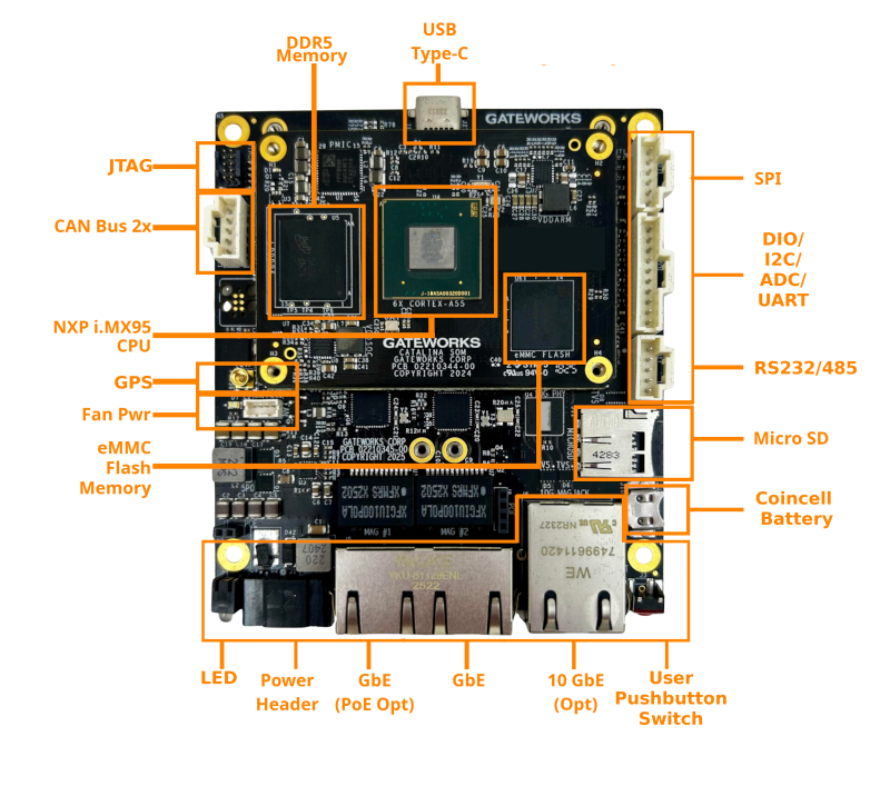

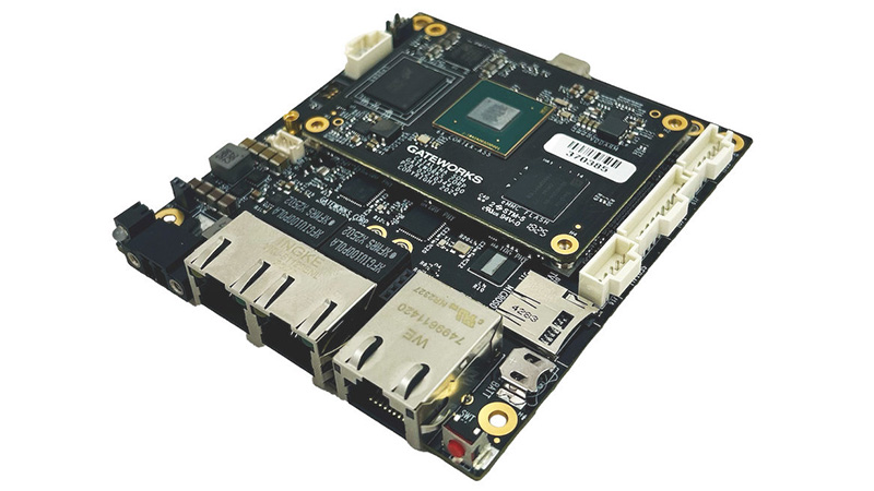

Gateworks Corporation, an innovator in the industrial-grade embedded technology market, recently disclosed a further development of its Catalina family of single board computers (SBC). The GW9200-00 falls under the umbrella of the Gateworks 9th generation Catalina family of robust and functional industrial single board computers. The Catalina GW9200 SBC incorporates the NXP i.MX95 processor and boasts a CE-ready design to enable transformative Edge AI, machine vision and autonomous capabilities to the most hostile industrial environments.
The GW9200 SBC is equipped with a SoM with the NXP i.MX 95 chip, 4GB LPDDR5 and 8GB eMMC flash by default, and a carrier board with 10GbE and GbE RJ45 ports, a MIPI DSI/CSI display/camera interface, two FSA sockets for M.2 or mini PCIe expansion, and a wide array of I/Os.

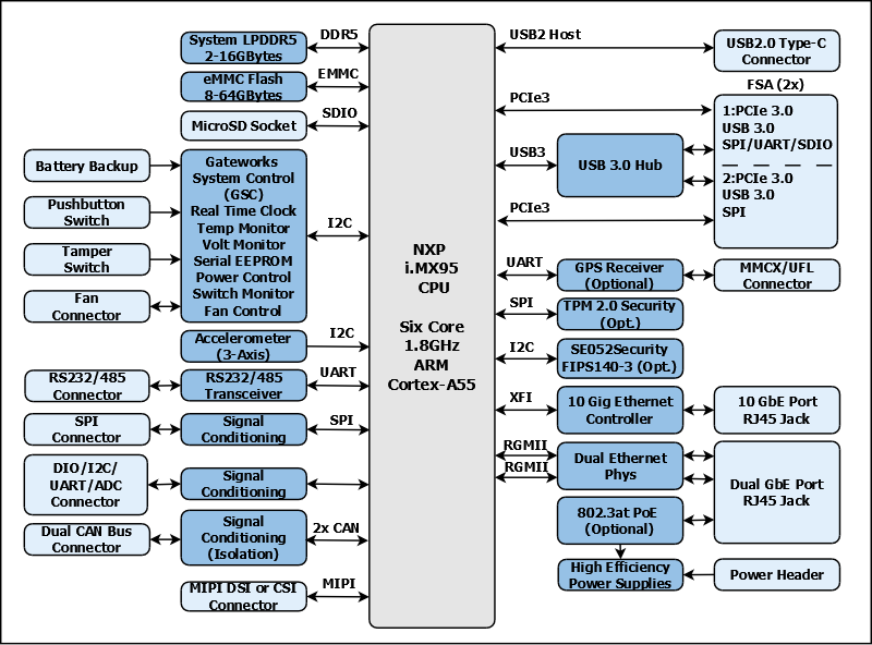

GW9200 Block Diagram
Gateworks Catalina GW9200 Specifications:
  • SoC:
    • Powered by the NXP i.MX 95 processor
    • CPU configuration:
      • Up to six Arm Cortex-A55 application cores operating at up to 1.8 GHz
      • 32KB instruction cache and 32KB data cache per core
      • 64KB L2 cache and 512KB L3 cache
      • One Arm Cortex-M7 real-time processor running at 800 MHz
      • One Arm Cortex-M33 safety processor running at 333 MHz
  • Graphics and Multimedia:
    • Arm Mali-G310 V2 GPU supporting 2D and 3D graphics acceleration
    • Compatible with OpenGL ES 3.2 and OpenCL 3.0
    • Hardware video processing capabilities:
      • H.265/HEVC and H.264 encoding and decoding up to 4K at 30fps or 1080p at 60fps
      • JPEG hardware encoder and decoder
      • Video decoding support for HEVC/H.265, VP9, VP8, and H.264 (Baseline, Main, and High profiles)
      • Video encoding support for HEVC/H.265 and H.264
  • AI Processing:
    • Integrated NXP eIQ Neutron Neural Processing Unit
    • Up to 2 TOPS AI performance
    • Capable of delivering up to 750 inferences per second
  • Memory and Storage:
    • 4GB LPDDR5 memory standard, expandable to 16GB
    • 8GB onboard eMMC flash storage, configurable up to 64GB
    • MicroSD card slot for additional storage expansion
  • Display and Camera: MIPI DSI or MIPI CSI interface connector for display and camera integration
  • Networking:
    • One 10GbE RJ45 Ethernet port
    • Two Gigabit Ethernet RJ45 ports
    • Optional Wi-Fi 6/6E/7 and Bluetooth connectivity through Mini PCIe or M.2 modules installed via Flexible Socket Adapter (FSA)
    • Optional 4G LTE or 5G cellular connectivity through FSA expansion slots
    • Dual Nano-SIM card support
  • Positioning: Optional u-blox GNSS receiver with GPS and GLONASS support
  • USB Connectivity: One USB 2.0 Type-C port
  • Industrial Interfaces:
    • Two RS-232 serial ports or one RS-485 interface
    • Two CAN Bus interfaces
  • Expansion Options:

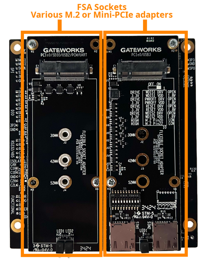

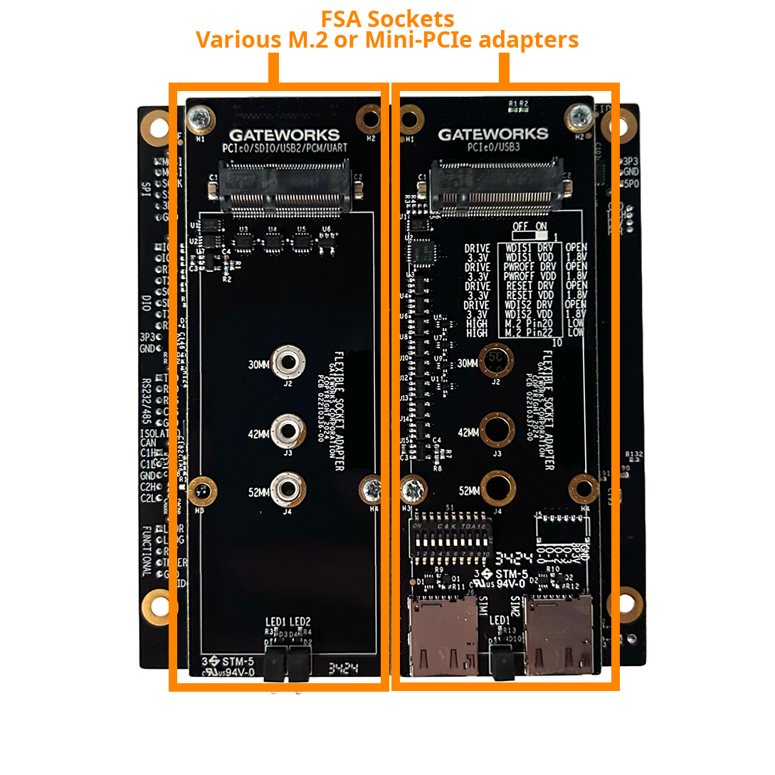

    • Two Flexible Socket Adapter (FSA) sockets supporting Mini PCIe or M.2 expansion modules
    • Dedicated SPI expansion connector
    • Digital I/O connector providing access to I2C, ADC, and UART interfaces
  • Security Features:
    • Optional NXP EdgeLock SE052F secure element
    • Optional TPM (Trusted Platform Module)
  • Debug and Management:
    • JTAG debugging connector
    • User-programmable push button
    • Power status LED
    • Integrated 3-axis accelerometer
    • RTC backup battery support via coin-cell
    • Fan connector for thermal management
  • Power Supply:
    • Wide input voltage ranges from 8V to 60V DC through power header
    • Optional IEEE 802.3af/at Power-over-Ethernet support with PoE adapter
  • Dimensions: 90 mm x 100 mm x 21 mm (2.75 x 3.9 x 0.8in)
  • Weight: 2.8oz (80g)
  • Operating and Storage Environment:
    • Industrial temperature range: -40°C to +85°C
    • Humidity (non-condensing): 20% to 90%
    • Humidity (non-condensing): 5% to 95%

FSA Sockets
FSA Sockets
