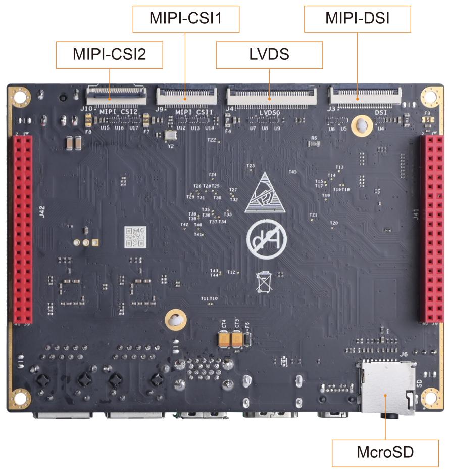

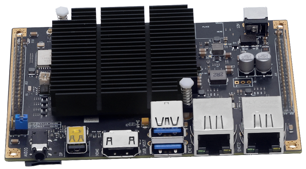

MYIR offers the MYD-LT527 Development Board for evaluating the MYC-LT527. This board is assembled by soldering the MYC-LT527 SOM onto a base board, which serves as an expansion board tailor-made for use with the MYC-LT527 module. It is equipped with a comprehensive range of interfaces, including one USB3.0, two USB2.0, two Gigabit Ethernet, two CAN interfaces, a WiFi/Bluetooth module, a Micro SD card slot, an Audio interface, two Mini-CSI interfaces, and multiple display interfaces: HDMI, Mini-DP, MIPI-DSI and LVDS. It also features a 40-pin RPI-compatible expansion interface and a MYIR custom 40-pin expansion interface, MI Fans PI interface, for increased expandability. Additionally, MYIR offers an optional MY-CAM003M Camera Module, MY-WIREDCOM RPI Module (RS232/RS485/CAN) and MY-LVDS070C LCD Module, which greatly enhance the functionality of the board.
MYD-LT527 Development Board Top-view
MYD-LT527 Development Board Bottom-view
MYD-LT527 Development Board (delivered with heatsink installed by default)
MYD-LT527 Development Board Block Diagram

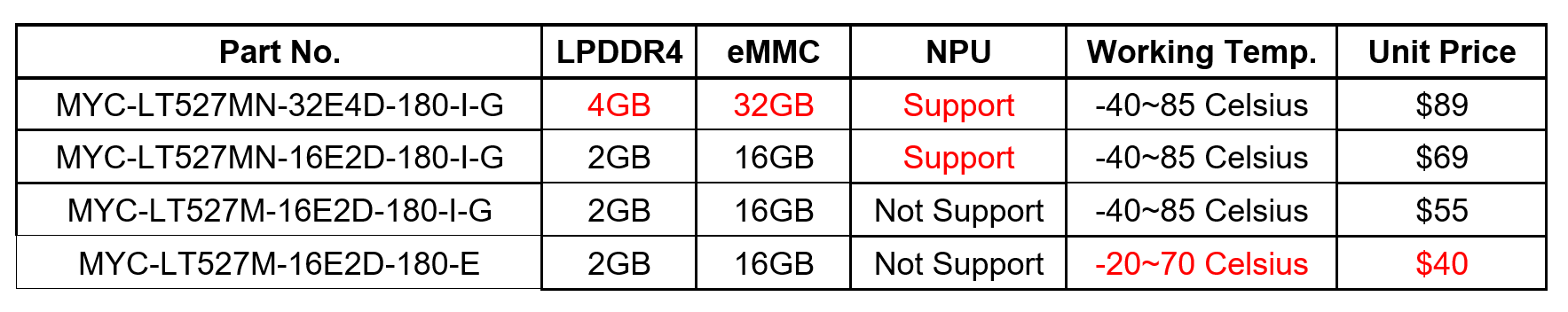

MYIR provides four standard configurations for the MYC-LT527 SOM to meet the different needs of the customers. The modules are affordable and we also offer discounts for bulk purchases.
