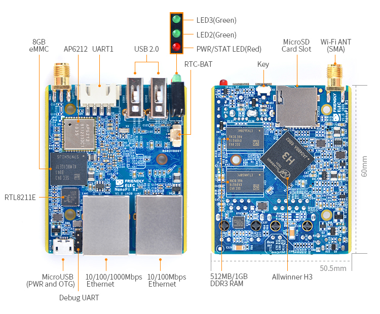

NanoPi R1 specifications
  • SoC – Allwinner H3 quad-core Arm Cortex-A7 processor @ up to 1.2GHz with Mali-400MP2 GPU
  • System Memory – 512MB or 1GB DDR3 RAM
  • Storage – MicroSD Slot, optional 8GB eMMC flash
  • Connectivity
    • 1x Gigabit Ethernet, 1x Fast Ethernet
    • 802.11b/g/n WiFi 4 with SMA antenna interface
    • Bluetooth 4.0 dual mode (Classic / LE)
  • USB – 2x USB Type-A host ports, 1x  micro USB OTG port
  • Debugging – 3-pin 2.54mm pitch header for serial console
  • Serial – 4-pin 2.54mm pitch UART header (compatible with Seeed Studio Grove modules?)
  • Misc – 3x LEDs, 1x user key/reset button
  • Power Supply – DC 5V/2A via micro USB port
  • Dimensions – 60 x 50.5mm
  • Temperature Range – -40℃ to 80℃
