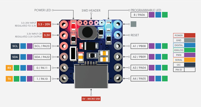

There is a new board in the ecosystem which claims to be the world’s smallest 32-bit Arduino board. The name of it Atom X1 and measures 14.9×14.9 mm.
Atom X1 specifications:
  • MCU – Microchip Atmel  SAMD21 Cortex M0+ MCU @ 48 MHz with 256KB flash, 32KB SRAM
  • I/Os via 2x 5-pin 2.54mm pitch headers
    • Up to 8x digital I/O
    • Up to 8x PWM
    • Up to 6x analog (ADC)
    • 1x UART
    • 1x I2C
    • 1x reset
    • Limits – 3.7V, 7mA
  • USB – 1x micro USB port
  • Programming – via micro USB port or SWD header
  • Misc – Power LED, user LED, button
  • Power Supply
    • 3.3-20V (regulated to 3.3v) via power Pin 1
    • 3.3V via power pin 2
    • 5V (regulated to 3.3v) via Micro USB port
    • Current Draw Atom X1 = ~10mA
  • Dimensions – 14.9 x 14.9 x 4.4mm
  • Weight – 0.95 grams
The board is breadboard compatible, pre-flashed with Arduino Zero bootloader, and can be programmed in the Arduino IDE just like the original board.
