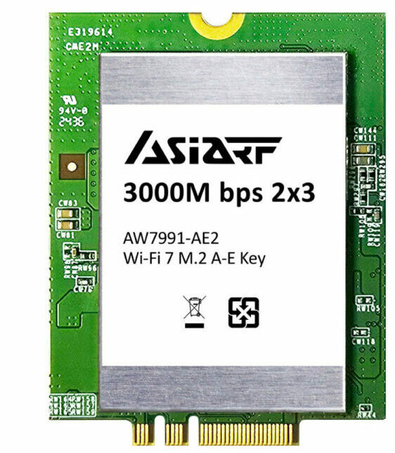

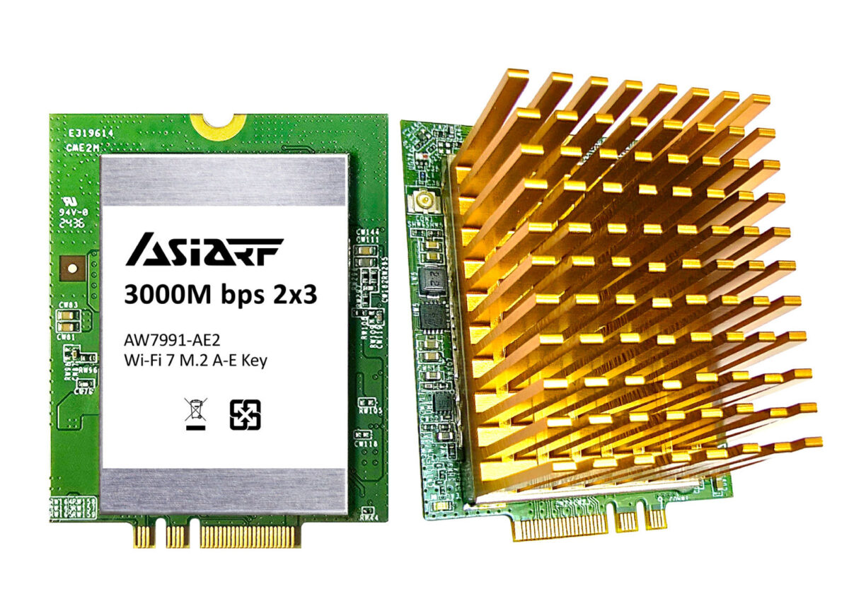

AsiaRF AW7991-AE2 dual-band WiFi 7 module
The ARF-DP-BE5000 is a Wi-Fi 7 development platform powered by the MediaTek MT7988A quad-core ARM Cortex-A73 processor. It features 1GB DDR4 RAM, 8GB eMMC storage, and 128MB SPI-NAND flash. This platform supports tri-band Wi-Fi 7 with 320 MHz bandwidth, 4096-QAM, and MLO, delivering fast connectivity with 2.4 GHz, 5 GHz, and 6 GHz bands. It includes multiple network ports (10GbE, 2.5GbE, and GbE) and M.2 slots for 4G/5G modules and Wi-Fi NICs. Additionally, the platform integrates advanced security and quality-of-service features for reliable and efficient wireless connectivity.
AsiaRF AW7991-AE2 dual-band WiFi 7 module Specifications
  • Chipset: MediaTek MT7991 with MT7976C
  • Frequency Bands:
    • 2.4GHz (2×2 2SS)
    • 5GHz (3×3 3SS)
  • Bandwidth:
    • 2.4GHz: 20/40 MHz
    • 5GHz: 20/40/80/160 MHz
  • Data Rates:
    • 2.4GHz: Up to 688Mbps (40MHz)
    • 5GHz: Up to 4323Mbps (160MHz)
  • MIMO: MU-MIMO, MU-OFDMA for Tx/Rx
  • Security: WPA3, WPA2, WPA Personal, WPS 2.0
  • Power Consumption: 11.5W
  • Antenna: External IPEX connectors x5
  • Host Interface: M.2 A-E Key (PCIe 3.0)
  • Operating Voltage: DC 3.3V ±5%
  • Operating Temperature: -10°C to 70°C
  • Storage Temperature: -20°C to 90°C
  • Humidity: 10% to 90% (Operating), Max 90% (Storage)
  • Size: 40 × 52 mm
The AW7991-AE2 M.2 WiFi 7 Modules can be used as an access point with Linux. AsiaRF offers a development platform featuring the MediaTek MT7988A quad-core ARM Cortex-A73 processor and the AW7991-AE2 Wi-Fi 7 module. It includes 10Gbps SFP, 2.5Gbps, and Gigabit Ethernet ports, plus M.2 slots for 4G/5G connectivity.

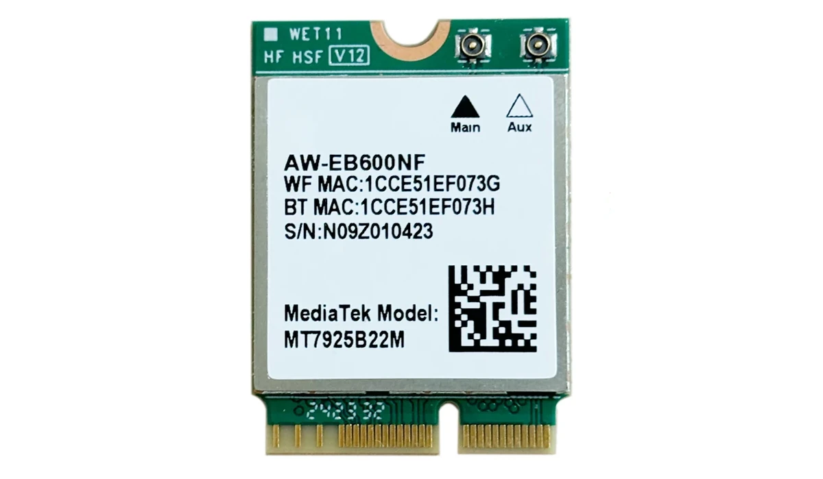

Azureware AW-EB600NF WiFi 7 M.2 module
The Azureware AW-EB600NF is a WiFi 7 M.2 module based on the MediaTek MT7925 chipset. 1 It offers tri-band support with speeds up to 574 Mbps on 2.4 GHz and 2400 Mbps on both 5 GHz and 6 GHz bands. While it claims Windows 11 and Linux compatibility, Linux users may need to put in extra effort to get it working as official driver support seems unclear.
Azureware AW-EB600NF WiFi 7 M.2 module Specifications
  • Chipset: MediaTek MT7925 (Filogic 360)
  • Standards: WiFi 7, Bluetooth 5.4
  • Frequency Bands: 2.4GHz, 5GHz, 6GHz
  • Maximum Throughput:
    • 2.4GHz: 574 Mbps (80MHz)
    • 5GHz: 2400 Mbps (160MHz)
    • 6GHz: 2400 Mbps (160MHz)
  • Antenna: 2x IPEX connectors for 2×2 MIMO
  • Host Interface: M.2 Key E (PCIe and USB signals) – Not compatible with CNVio
  • Dimensions: 30 x 22 x 2.3 mm
  • Weight: 2.6 grams
The AW-EB600NF is priced at $16.29 on AliExpress with free shipping as part of a welcome offer, with the regular price being $23.99. Similar MT7925 Wi-Fi 7 M.2 modules are available for around $20, and the AW-EB600NF is also listed for $25 on Amazon. Though it’s available for cheap, there is nothing clear about the drivers, so you need to find yourself a driver if you are purchasing this.
