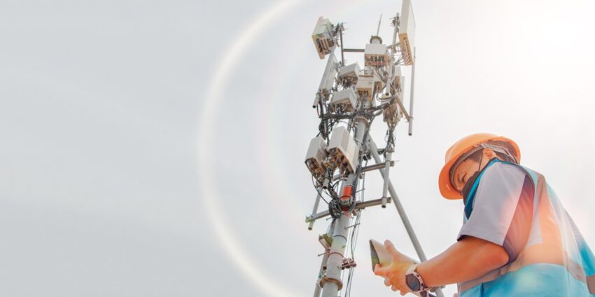

Qorvo’s new RF switches provide >65 dB isolation to help support signal integrity as bandwidth and frequency bands expand worldwide. Image used courtesy of Adobe Stock
