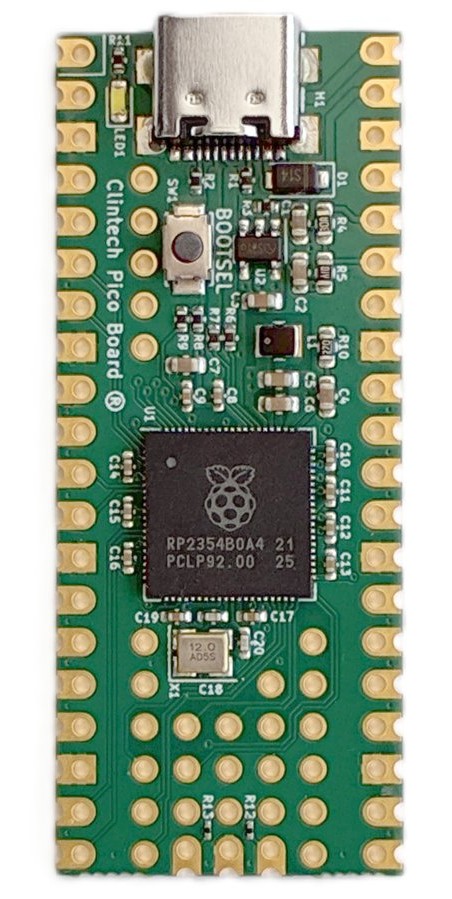

Clintech Pico Board Top Side
Features of the Clintech Pico Board:
  • MCU: Raspberry Pi RP2354B microcontroller
  • CPU: Dual-core Arm Cortex-M33 or dual-core Hazard3 RISC-V processors clocked at up to 150 MHz, with support for Arm, RISC-V, or hybrid operation
  • Memory: 520 KB SRAM
  • Flash storage: 2 MB on-chip flash
  • External memory: QSPI breakout supporting up to 16 MB external flash or PSRAM
  • GPIO: 48 user-accessible GPIOs
  • Programmable I/O: Three PIO blocks with 12 state machines
  • USB: USB Type-C port for power and programming
  • Debugging: 3-pin debug header
  • User interface: Boot Select button and onboard LED connected to GPIO25 via a solder jumper
  • Expansion: 27 additional through-holes exposing the remaining GPIOs and the QSPI interface
  • Form factor: 51 × 21 mm DIP-40 board with castellated edges
  • Compatibility: 1:1 footprint and pinout compatible with Raspberry Pi Pico boards

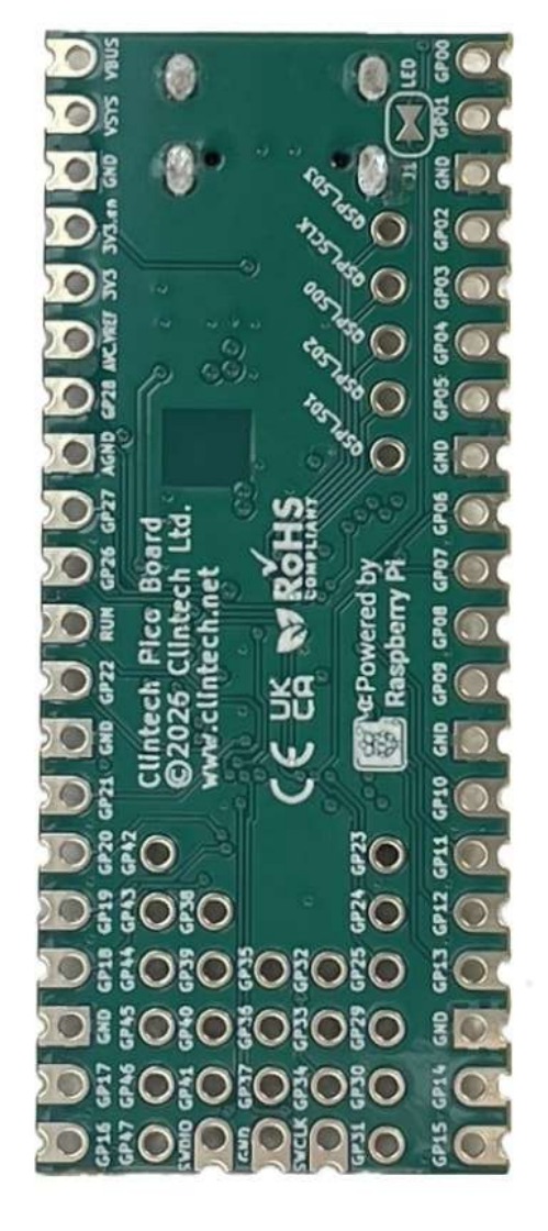

Clintech Pico Board Bottom Side

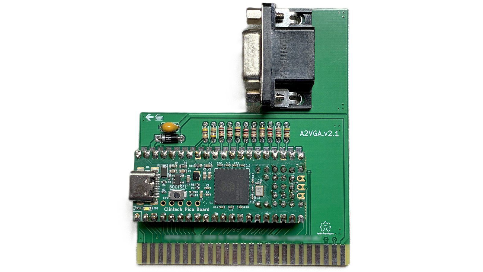

The Raspberry Pi Pico Board supports the same software ecosystem as other RP2350-based platforms. Developers can use the official Raspberry Pi SDK, MicroPython, and other RP2350-compatible development tools. Clintech also provides open documentation, including the board schematic, KiCad footprint, cpb.h board definition file, and demo firmware. Since the board follows the original Pico footprint, existing projects and software require little or no modification when migrating to the new hardware.

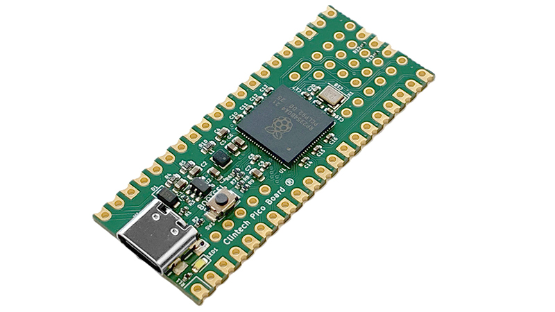

Clintech Pico Dev board
