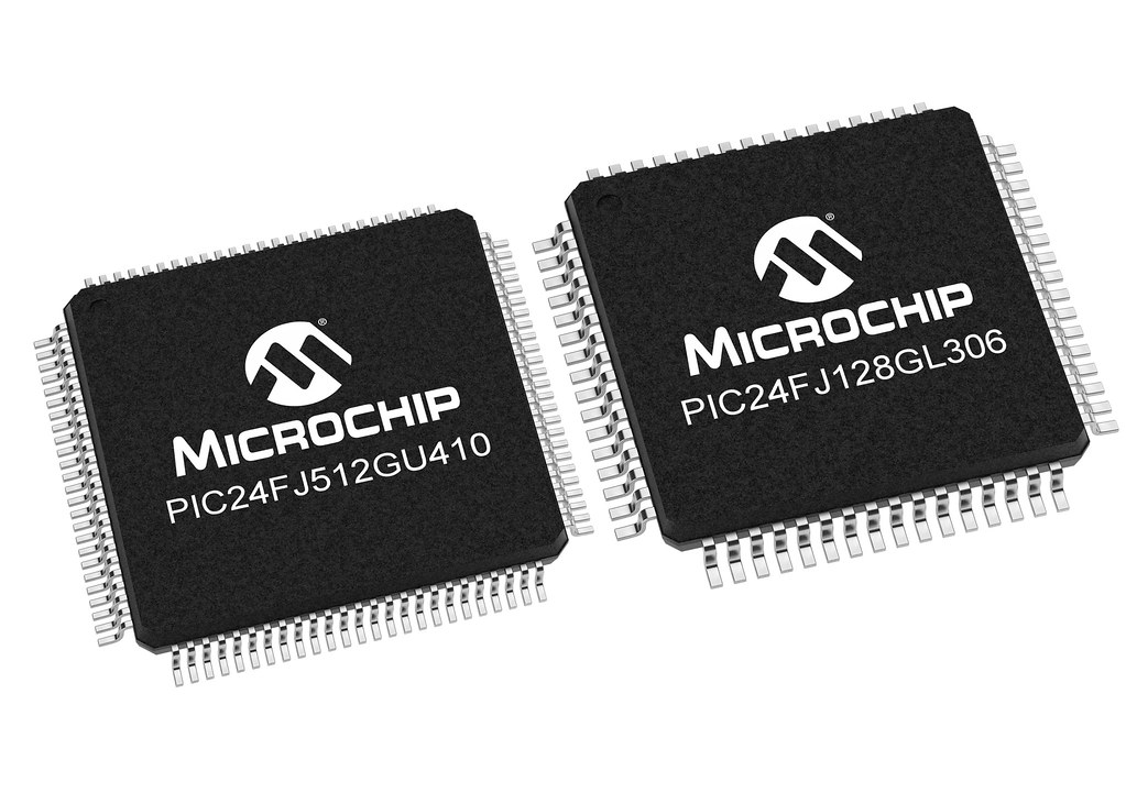

Low power MCU family offers power-saving peripherals, hardware safety, and secure code protection System developers of battery-powered and other power-conscious designs with and without LCD displays can now easily add an array of innovative features using a new line of PIC® eXtreme Low Power (XLP) microcontrollers (MCUs) from Microchip Technology Inc. Packed with 14 types of Core Independent Peripherals (CIPs) that operate outside the Central Processing Unit (CPU) for power savings, the PIC24F GU and GL families of MCUs feature the CIP called LCD with Autonomous Animation.

The PIC24F GL3 family with integrated LCD is available in 28-, 36-, 48- and 64-pin packages as small as 4×4 mm (uQFN). Memory ranges from 64 KB to 128 KB Flash and 8 KB RAM. The PIC24F GU4 / GL4 family with integrated LCD and USB is available in 48-, 64-, 80- and 100-pin packages with memory ranges from 128 KB to 512 KB Flash and 32 KB RAM. Prices start at $0.97 in high volume for the PIC24FJ64GL302-I/SS.
