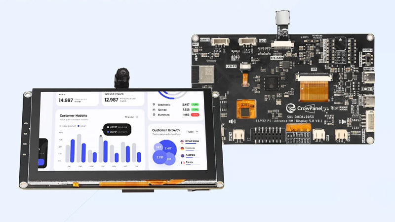

Elecrow has introduced the CrowPanel Advanced 5-inch ESP32-P4 HMI AI display, a high-performance interactive terminal with an 800×480 capacitive IPS touchscreen, an ESP32-C6 for Wi-Fi 6 and Bluetooth 5.3 connectivity, and support for interchangeable wireless modules.
Because the ESP32-P4 SoC lacks built-in wireless connectivity, Elecrow utilises a dual-chip design. The main processor handles the complex graphical user interfaces and edge AI tasks, while an onboard ESP32-C6-MINI-1 module provides dedicated 2.4GHz Wi-Fi 6 and Bluetooth 5.3 connectivity. The board also features an audio codec with a microphone and dual-speaker output for voice assistants, and an optional 2-megapixel MIPI-CSI camera can be added for real-time facial recognition and object tracking.
Front and rear views of the CrowPanel Advanced 5-inch ESP32-P4 HMI display.

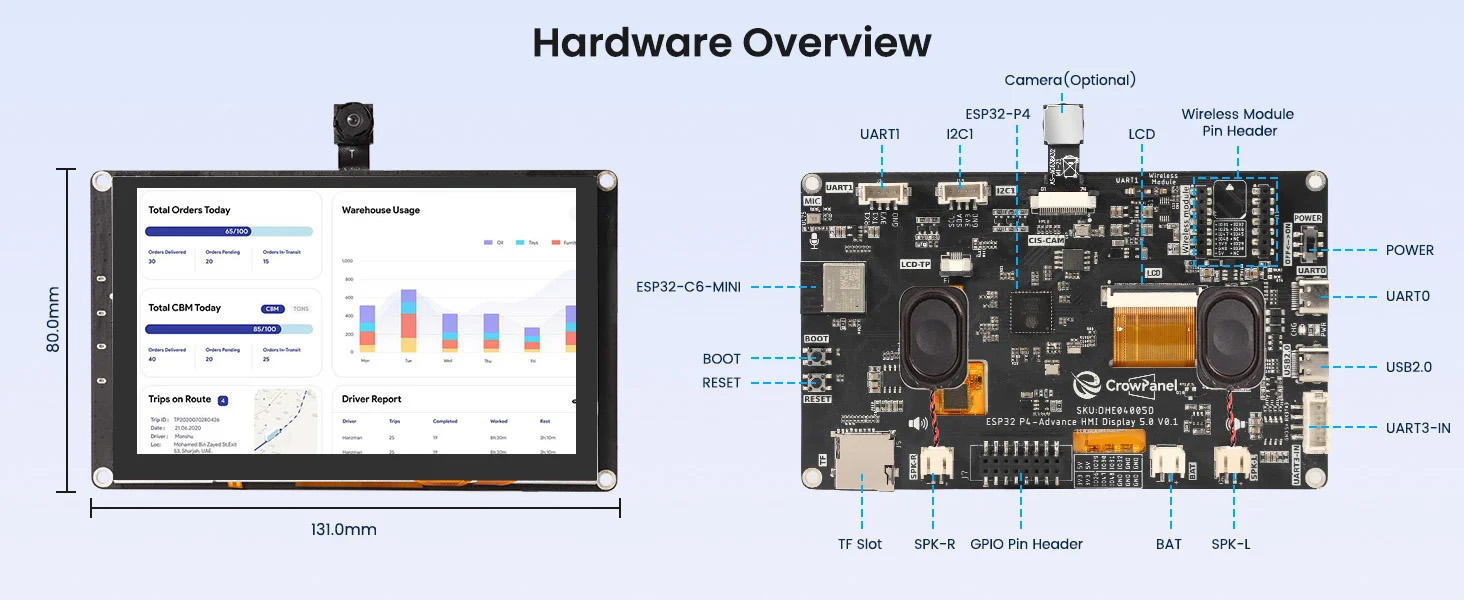

  • USB: 2x USB Type-C ports (one for UART debugging, one USB 2.0 Device)
  • Expansion:
    • 7-pin GPIO header
    • 2x UART output connectors (HY2.0-4P)
    • 1x UART input connector (HY2.0-4P)
    • I2C connector (HY2.0-4P)
  • Misc: Reset and Boot buttons, Power and CHG LEDs, battery charge management
  • Power Supply:
    • 5V/2A via USB-C or UART terminal
    • 2-pin PH2.0 battery connector for Lithium battery
  • Dimensions: 131 x 80 x 15mm (Active area: 108 x 65mm)
  • Temperature Range: Operating: -20 to 70°C; Storage: -30 to 80°C
CrowPanel Advanced 5-inch ESP32-P4 display showing the main board layout and available interfaces.
