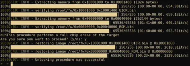

nrfsec requires python 3.7+ to run and can be installed with pip. For nrfsec to work, it will first of all make a quick info check to ensure that nrfsec is able to communicate with both the debugger and the target. The output for the info will also specify if the target is currently locked with some additional interesting target information. Then nrfsec will automatically find a useable read gadget and dump all memory on a locked target. If the target is not already locked, you can issue the lock sub-command, and it will lock the again. If you want to unlock the target, you issue the unlock sub command which will perform the following steps:
  1. Read all memory regions (most importantly, ROM and UICR) and save the images.
  2. Perform a full target erase, this will enable writing to the UICR again.
  3. Patch the UICR image extracted during step 1 to disable read back protection.
  4. Re-flash the ROM and patched UICR back to the target.
