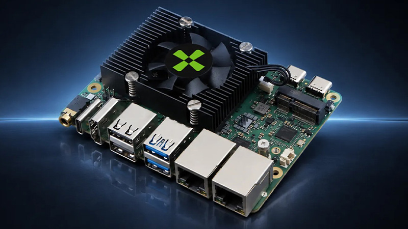

Radxa has introduced the Dragon Q8B, a compact Qualcomm Snapdragon SBC designed for edge AI, robotics, industrial automation, and intelligent vision applications. The board measures only 100 × 75 mm and combines the Qualcomm Snapdragon 8cx Gen 3 Compute Platform with dual 2.5GbE networking, multiple PCIe expansion interfaces, and support for up to three 4K displays.
Built on Qualcomm’s 5nm Snapdragon 8cx Gen 3 processor, the Dragon Q8B integrates an octa-core Kryo CPU with four Cortex-X1-based Kryo Prime cores clocked at up to 3.0 GHz and four Cortex-A78-based Kryo Gold cores running at up to 2.42 GHz. The platform also includes an Adreno 690 GPU and Qualcomm AI Engine that delivers up to 29 TOPS of AI performance for machine vision, speech processing, automation, and compact LLM workloads.

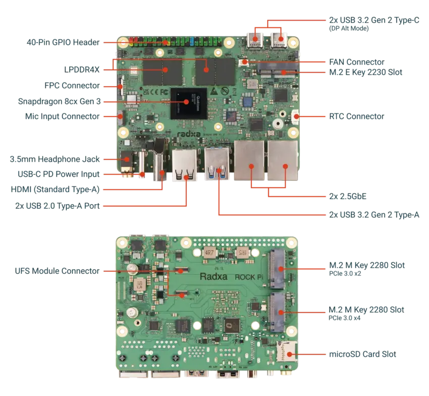

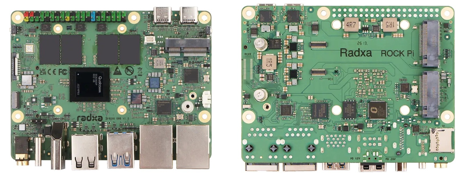

Dragon Q8B Qualcomm Snapdragon SBC Front and Back
Dragon Q8B SBC Front and Back

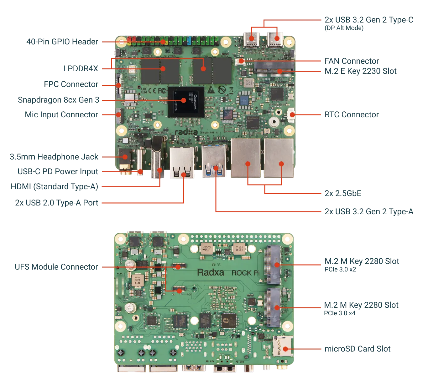

Radxa Dragon Q8B Interface

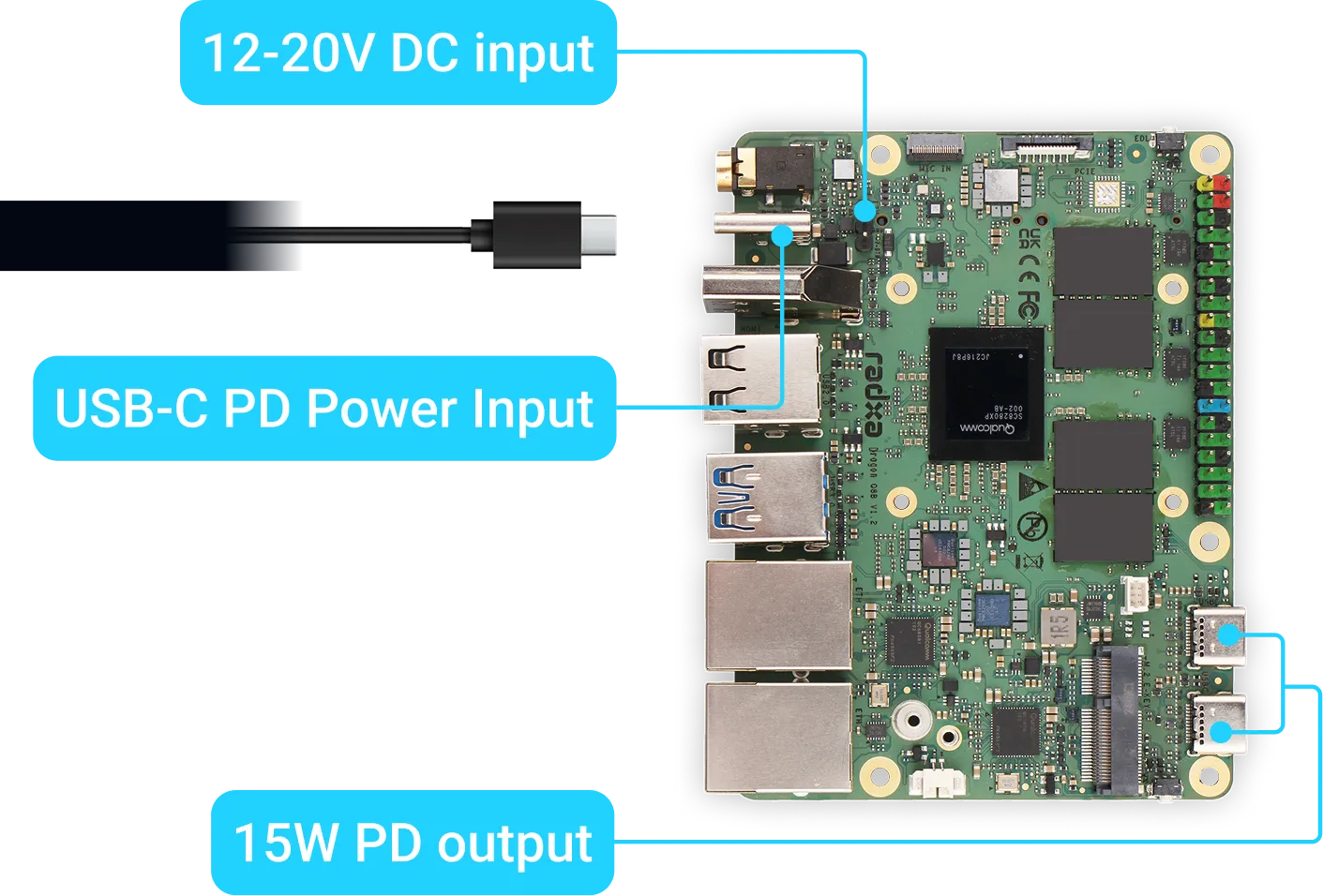

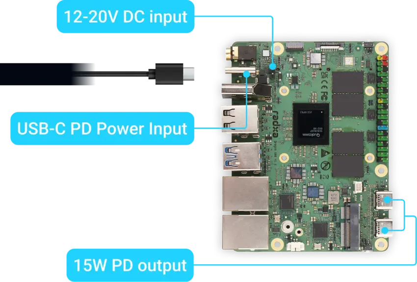

power supply interfaces
Power Supply Interfaces
