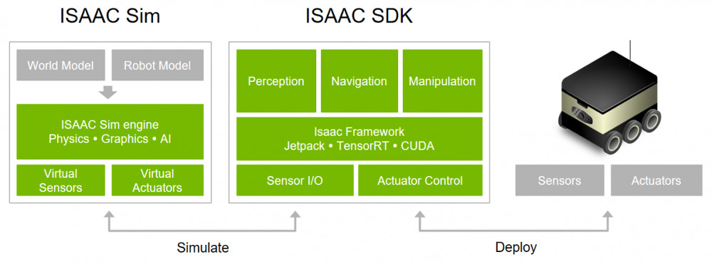

It also announced an “Isaac” software development platform for robots and other autonomous machines that run on its Linux-friendly octa-core “Jetson Xavier” module. The NVIDIA Isaac Software Development Kit (SDK) gives you a comprehensive set of frameworks, tools, APIs, and libraries to accelerate development of robotics algorithms and software.
The Isaac robotics software consists of:
  • Isaac SDK — a collection of APIs and tools to develop robotics algorithm software and runtime framework with fully accelerated libraries
  • Isaac IMX — Isaac Intelligent Machine Acceleration applications, a collection of NVIDIA-developed robotics algorithm software
  • Isaac Sim — a highly realistic virtual simulation environment for developers to train autonomous machines and perform hardware-in-the-loop testing with Jetson Xavier
