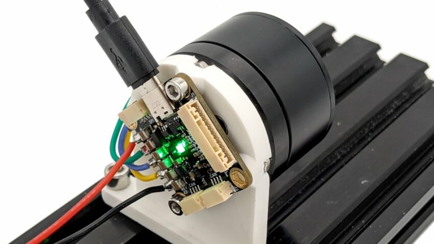

ODrive Micro is engineered for easy setup and versatile integration. Its onboard magnetic angle sensor allows for direct mounting on the back of your motor, eliminating the need for a separate encoder. Simply connect it to a 10-30V power source and utilize the convenient daisy-chained CAN connector to get started.

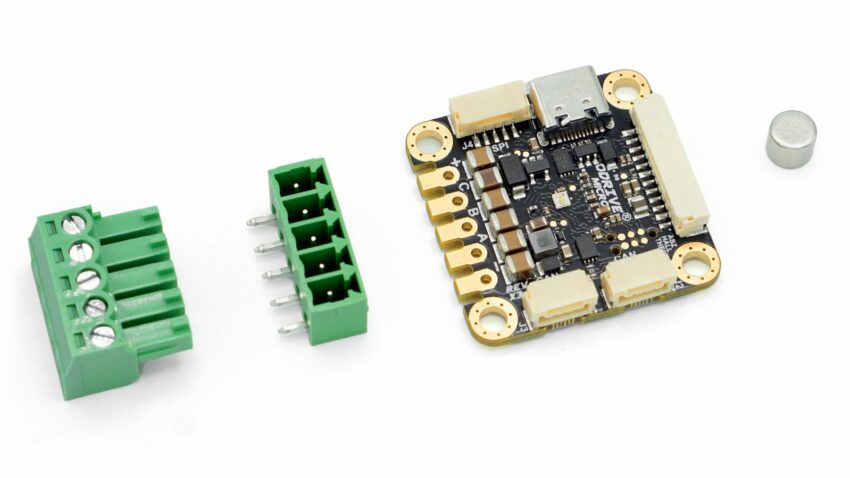

Odrive Micro with terminal blocks and magnet

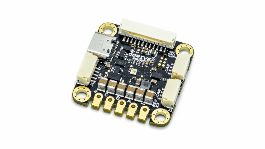

ODrive Micro Features & Specifications
  • Form Factor: 32 x 32 x 7.5 mm
  • Motor Compatibility: BLDC (brushless DC), PMSM/PMAC (permanent magnet synchronous/AC), and ACIM (AC induction) motors
  • Power: Up to 180W peak, 100W continuous
  • Voltage:10-30V operation (32V max)
  • Current: 3.5A continuous (Ta=25°C), 7A peak
  • Encoder: Onboard magnetic encoder for back-of-motor mounting
  • Control Modes: Torque, velocity, position, and trajectory control
  • External Encoder Support: Hall, incremental, and SPI encoders
  • Interfaces: CAN and USB
  • Software: Shared architecture with all current-generation ODrives, including web GUI support
