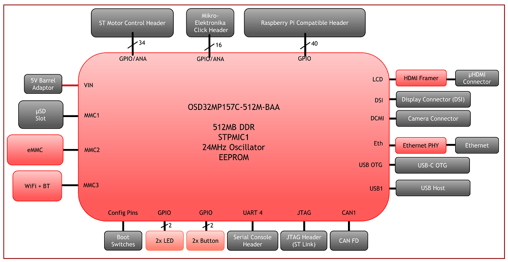

The OSD32MP1-RED is a full-featured Reference, Evaluation, and Development platform for the STM32MP1 based SiP, the OSD32MP15x. It provides access to a number of standard communication interfaces like WiFi and Bluetooth, 1Gb Ethernet, and CAN.
The OSD32MP1-RED is a full-featured Reference, Evaluation, and Development platform for the STM32MP1 based SiP, the OSD32MP15x.  It provides access to a number of standard communication interfaces like WiFi and Bluetooth, 1Gb Ethernet, and CAN.  It supports HDMI or DSI displays and has a connector for a camera. The OSD32MP1-RED expands easily by providing connectors that are compatible with Raspberry Pi, MikroElektronika mikroBUS™ Click, and STMicroelectronics Motor Control Header.
The onboard eMMC comes preloaded with an Opensource Linux Distribution allowing you to begin development straight out of the box.
OSD32MP1-RED Features
  • Full Featured Reference, Evaluation, Development Platform
  •  OSD32MP157C-512M-BAA
    • STM32MP157C Dual Arm® Cortex® A7 + M4
    • 512MB DDR3 Memory
    • STPMIC1A Power Management
    • EEPROM
    • Oscillator
    • Passives
  • Connectivity
    • WiFi/Bluetooth
    • 10/100/1000 Ethernet
    • CAN FD
    • USB Host
    • USB-C OTG
    • UART
    • JTAG (STLink)
  • Memory
    • µSD Card
    • eMMC
  • Display
    • HDMI
    • DSI
  • Camera
  • Expansion
    • Raspberry Pi Compatible Header
    • MikroElektronika Click Header
    • Motor Control Header
  • 4 Layer Design
Block
With its communication interfaces, peripherals, and expansion capabilities, the OSD32MP1-RED is a perfect platform for quickly developing IOT, high-end HMI, or real time control applications.
