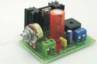

1.2 – 15V/3A adjustable regulated power supply
Specifications This kit provides a variable output power supply ranging from 1.2 to 15 V @ 3 A. It uses Low Dropout Positive Regulator LM1084 in TO220 package for delivering variable output voltage.

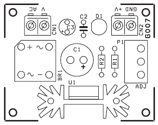

- Onboard PCB mounted Potentiometer (POT) for varying the output voltage
- Filter capacitors for low ripple DC output
- Four mounting holes of 3.2 mm each
- PCB dimensions 46 mm x 58 mm

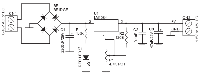

Schematic

Sir which amp transformer uses sir
You need a transformer that will be able to deliver ~3A
Can i use 24v transformer here? or does the regulator cant handle it? If it does do i need to change the resistors/capacitors?
Using a 24Vac transformer will exceed the maximum input voltage of the regulator. This regulator can’t be adapted to accept bigger voltages than 29V at it’s input.
Thanks! How about if i use 12Vac transformer? What would be the maximum output voltage of the power supply?
With a 12Vac transformer you will have ~13-14V max output voltage.
