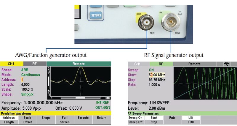

Dedicated configuration screens for the AWG/Function and RF outputs keep waveform-shaping and carrier-sweep settings visually and functionally distinct. Image used courtesy of BK Precision
