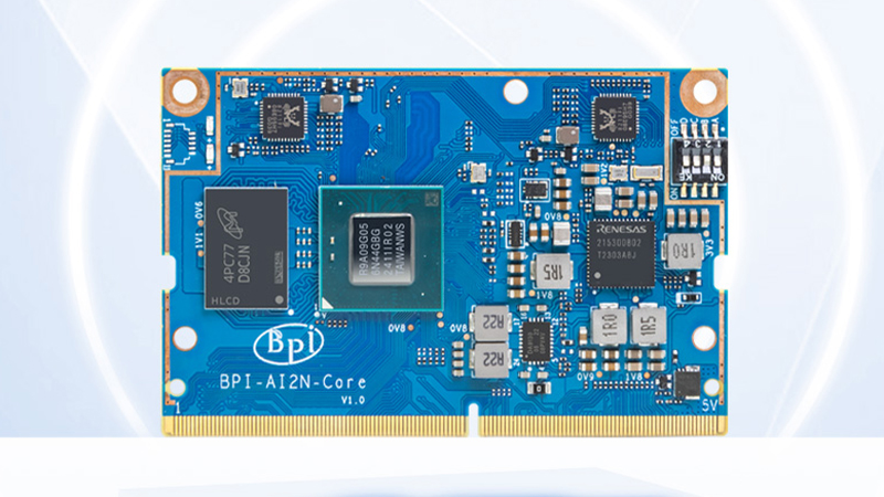

Banana Pi has released its embedded vision platform, BPI-AI2N, to users worldwide. The BPI-AI2N uses a system-on-module approach, separating out the physical components into a SODIMM form-factor module and a carrier board to expose its different characteristics. The platform combines a system-on-module (SoM) based on the Renesas RZ/V2N Vision AI MPU and a carrier board designed for smart cameras, industrial vision, robotics, and other edge AI applications.
Its DRP-AI3 accelerator promises up to 15 TOPS of sparse AI performance, while a Mali-G31 GPU and Mali-C55 image signal processor take care of graphics and camera-processing workloads. The 45 × 69,6mm System-on-Module (SoM) is furnished with a 260-pin SO-DIMM connector and has 8GB of LPDDR4X memory, 32GB of eMMC storage and 64MB of onboard SPI flash.

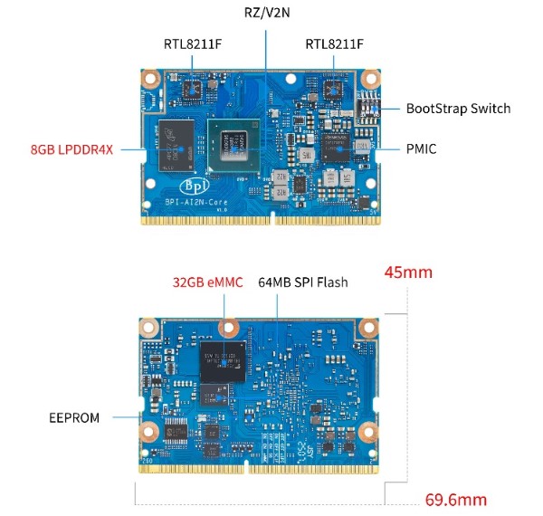

BPI-AI2N-Core Top and Bottom View

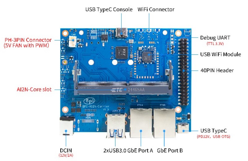

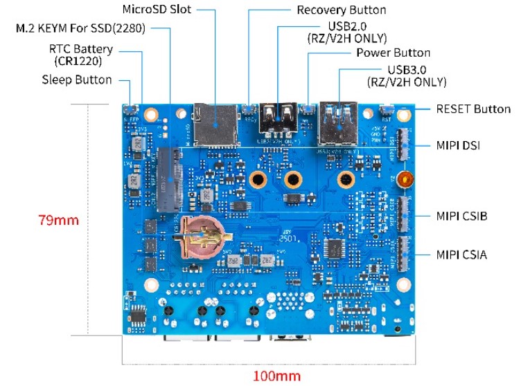

Banana Pi BPI-AI2N Specifications:
  • SoC / Processing:
    • Renesas RZ/V2N Vision AI MPU
    • Quad-core Arm Cortex-A55 application processor, up to 1.8 GHz
    • Arm Cortex-M33 real-time core running at 200 MHz
    • DRP-AI3 Vision AI accelerator delivering up to 15 sparse TOPS
    • Arm Mali-G31 GPU
    • Arm Mali-C55 ISP for image processing
    • 1.5 MB integrated on-chip SRAM
  • Memory and Storage:
    • 8 GB LPDDR4X system memory integrated on the SoM
    • 32 GB onboard eMMC storage
    • 64 MB SPI flash
    • MicroSD card slot for additional storage
    • M.2 Key-M 2280 socket for NVMe SSDs
    • NVMe storage supported via PCIe Gen3 ×2
  • Display and Camera Interfaces:
    • MIPI DSI interface for display connectivity
    • 2× MIPI CSI interfaces for camera modules
  • Networking:
    • 2× Gigabit Ethernet interfaces
    • Dual Realtek RTL8211F Gigabit Ethernet PHYs integrated on the SoM
    • Dedicated connector for an optional USB Wi-Fi module
  • USB Connectivity:
    • 2× USB 3.0 Type-A ports
    • USB Type-C port with USB OTG functionality
    • USB-C port supports 12V USB Power Delivery
    • Dedicated USB Type-C console interface
  • Expansion and Debugging:
    • 40-pin GPIO expansion header
    • 3-pin 5V PWM fan connector
    • 3.3V debug UART interface
    • SoM-integrated bootstrap switch
    • Onboard EEPROM
  • User Controls:
    • Power button
    • Reset button
    • Sleep button
    • Recovery button
  • RTC and Backup Power:
    • Integrated real-time clock
    • CR1220 coin-cell battery holder
  • Power Supply:
    • 12V input via USB Type-C Power Delivery
    • 12V DC power input
  • Operating temperature range: −40°C to +85°C
  • Mechanical Specifications:
    • SoM dimensions: 45 × 69.6 mm
      • 260-pin SO-DIMM interface
    • Carrier board dimensions: 100 × 79 mm
BPI-AI2N-Carrier Top View

BPI-AI2N-Carrier Bottom View
