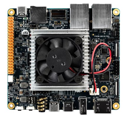

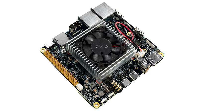

FRDM-IMX95-PRO i.MX 95 Development Board
NXP recently unveiled the FRDM i.MX 95 Pro, an inconspicuous development board intended for the evaluation of the company’s i.MX 95 applications processor for edge AI, industrial networking, robotics, vision processing as well as advanced HMI applications. The dev board is based on the 19 × 19mm i.MX 95 processor, which combines up to six Arm Cortex-A55 application cores with Cortex-M7 and Cortex-M33 cores for real-time and minimal-power computation.
The eIQ Neutron NPU offers up to 8 eTOPS of AI acceleration. The development board comprises a 10GbE interface, Wi-Fi 6, Bluetooth 5.4 and 802.15.4 tri-radio connectivity and two M.2 Key-M slots for AI accelerator cards or SSDs. The board also includes 16 GB LPDDR5-6400 memory, a 32 GB eMMC flash and NXP’s GoPoint demo interface for robotics, industrial networking and vision-based processing applications.
FRDM i.MX 95 Pro development board

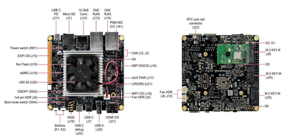

NXP FRDM-IMX95-PRO Hardware Overview (Top and Bottom)

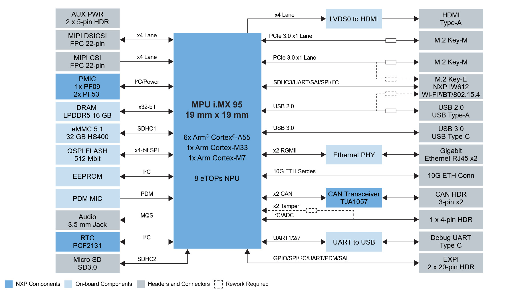

NXP FRDM-IMX95 PRO dev board block diagram
