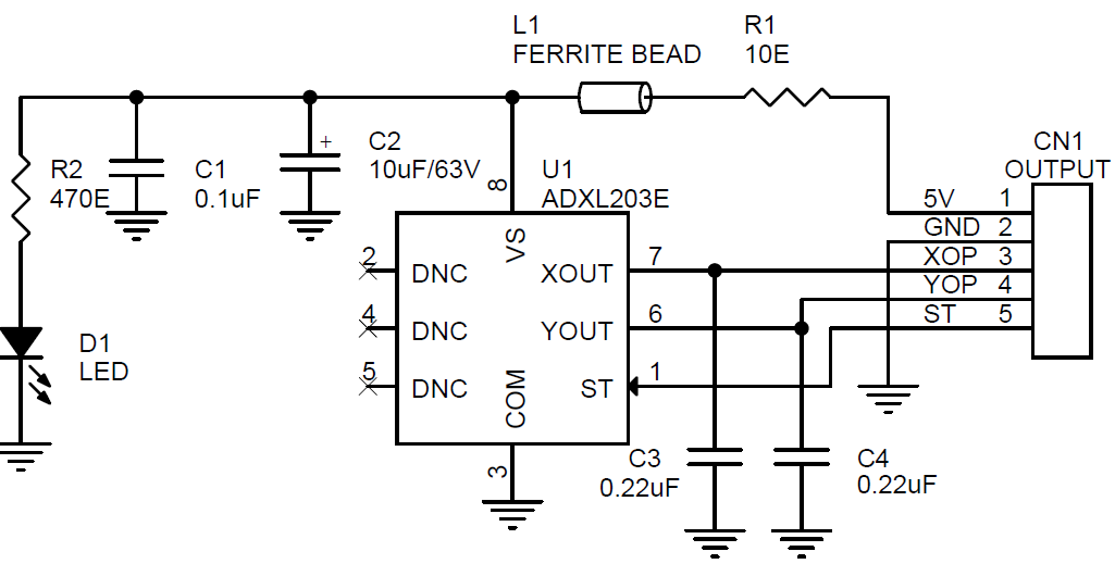

SETTING THE BANDWIDTH USING CX AND CY
The ADXL203 has provisions for band limiting the XOUT and YOUT pins. Capacitors must be added at these pins to implement low-pass filtering for antialiasing and noise reduction. The equation for the 3 dB bandwidth is
f–3 dB = 1/(2π(32 kΩ) × C(X, Y))
or more simply,
f–3 dB = 5 μF/C(X, Y)
The tolerance of the internal resistor (RFILT) can vary typically as much as ±25% of its nominal value (32 kΩ); thus, the bandwidth varies accordingly. A minimum capacitance of 2000 pF for CX and CY is required in all cases.
Table 7. Filter Capacitor Selection, CX and CY
Bandwidth (Hz)
Capacitor (μF)
Schematic

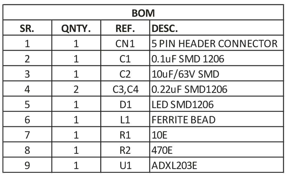

Parts List

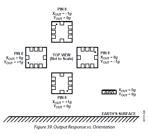

Sensor orientation

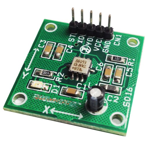

Photos
