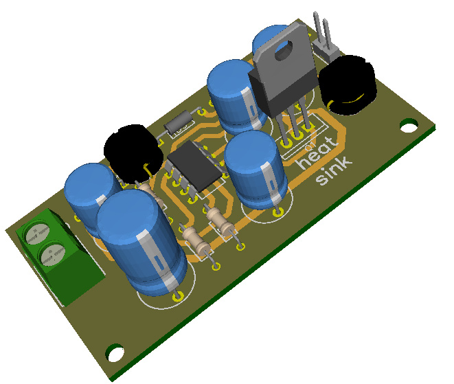

  • PCB:70mm X 38mm

  3. The components are close to what shown in the 3D preview
  4. Use heat sink for components wherever applicable

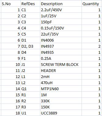

Parts list
