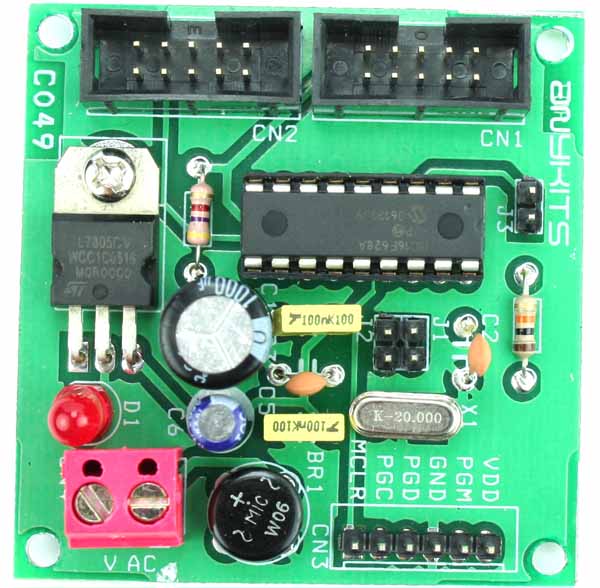

PIC16F 18-pin Development Board will help you with your prototyping. It works with any of Microchip’s 18 pin of 16F PIC microcontroller.
  • All ports terminating in separate box header with 5 VDC source option
  •  ICSP connector for programming for the PIC’s with ICD support
  •  Jumper selectable on board pull up resistor for PortA.4 pin on the microcontroller
  •  Bridge in the input provides any polarity DC supply connection to the board
  •  Jumper selectable 20 MHz crystal source
  •  Onboard +5V Voltage regulator
  •  Four mounting holes of 3.2 mm each
  •  PCB dimensions 56 mm x 55 mm

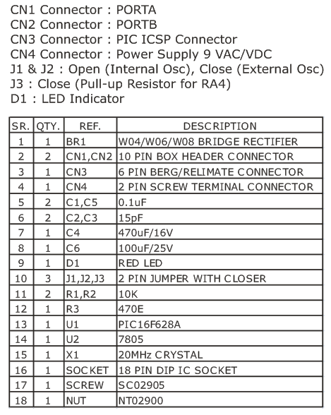

Parts List
18pin-pic-development-board-parts
Photos
18pin-pic-development-board-img1

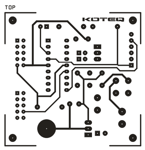

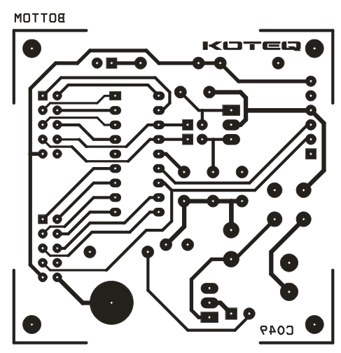

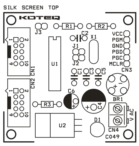

PCB
