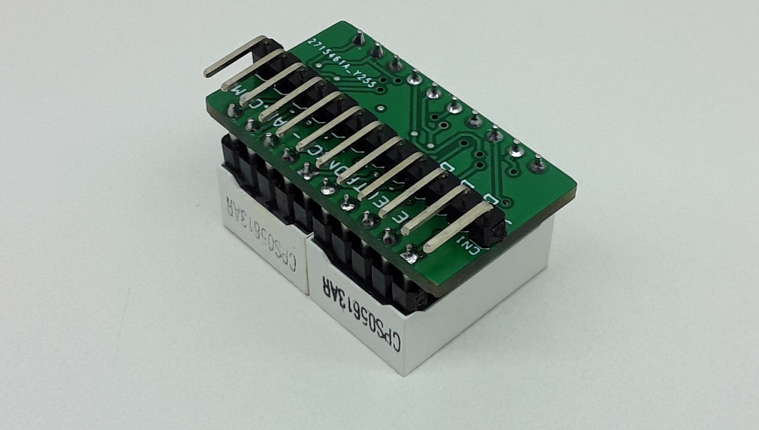

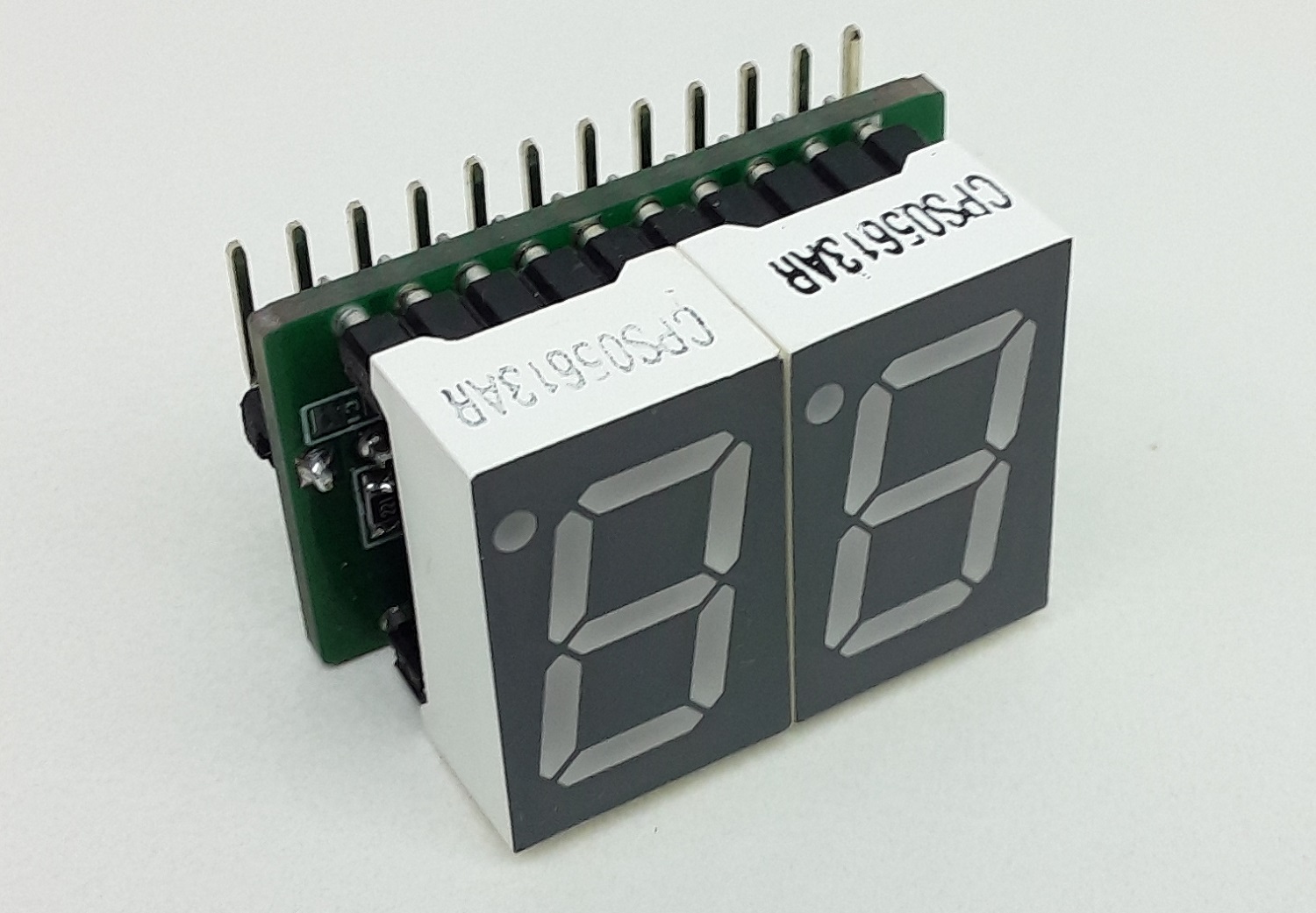

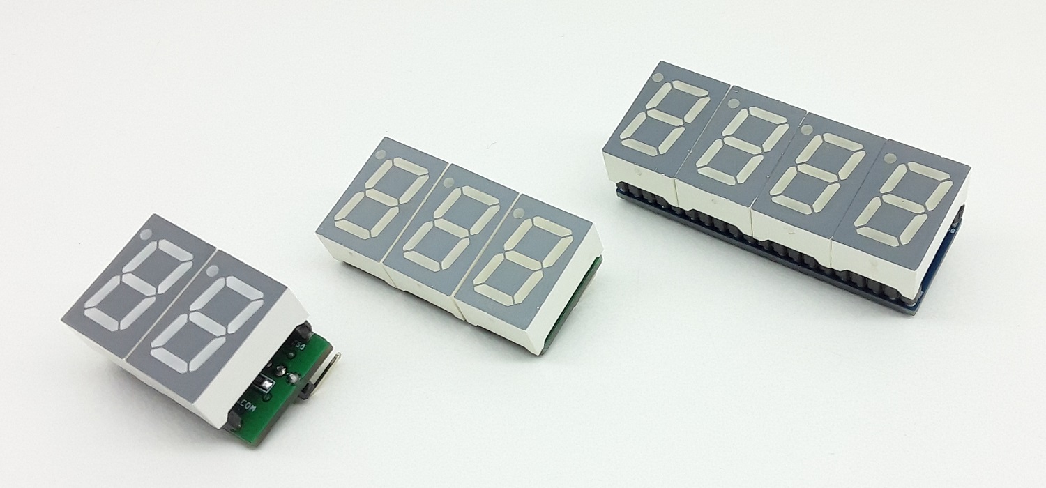

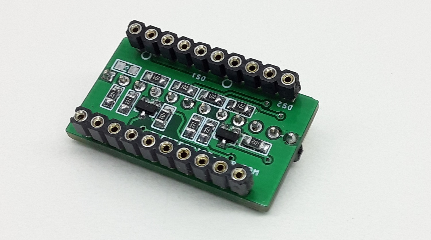

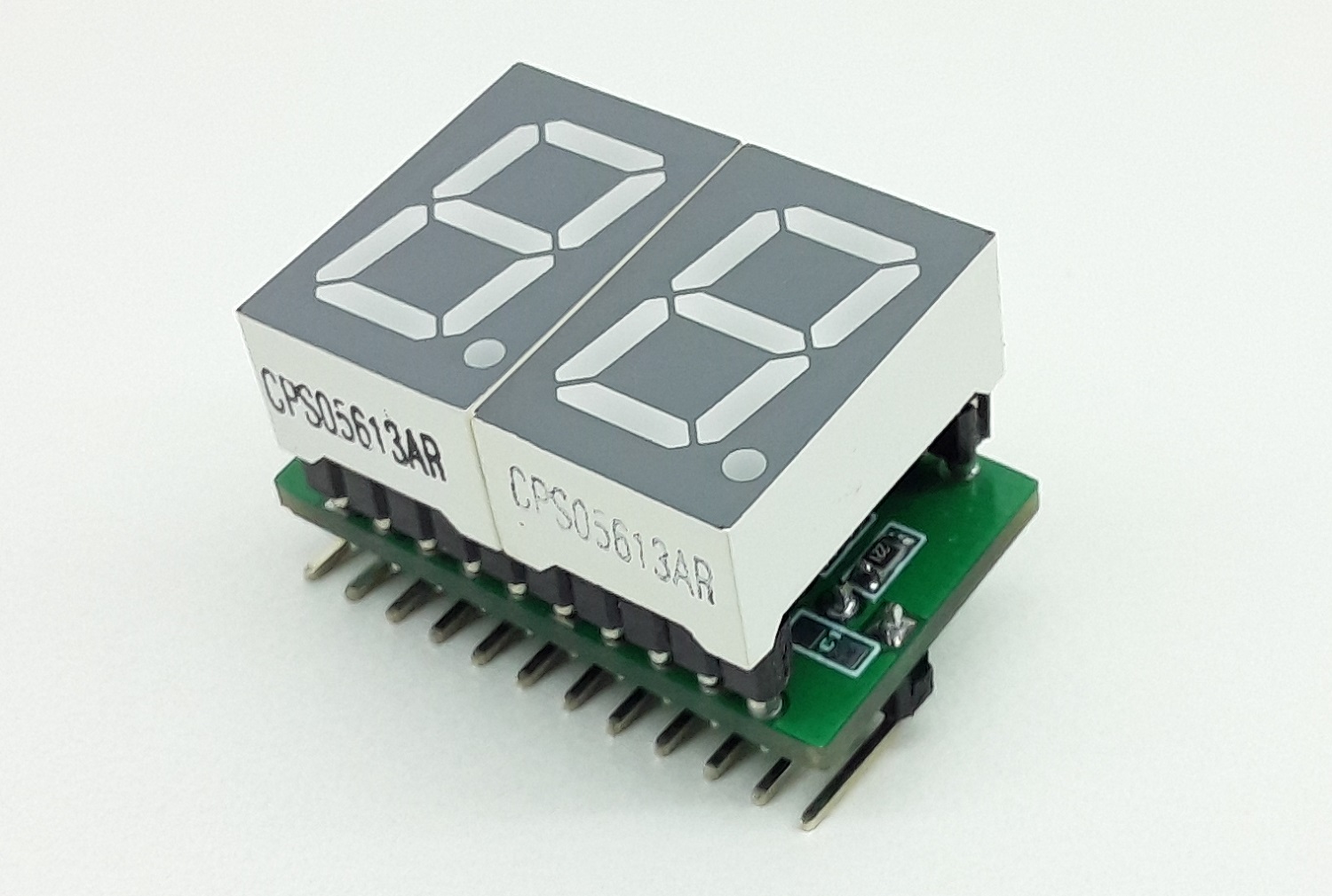

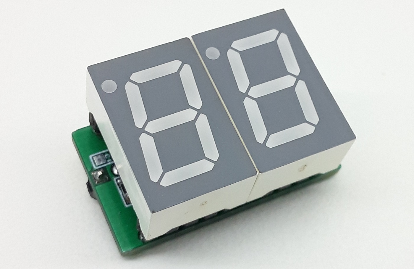

2 Digit Common Cathode 0.5″ – 7 Segment Display Module (Multiplexed)

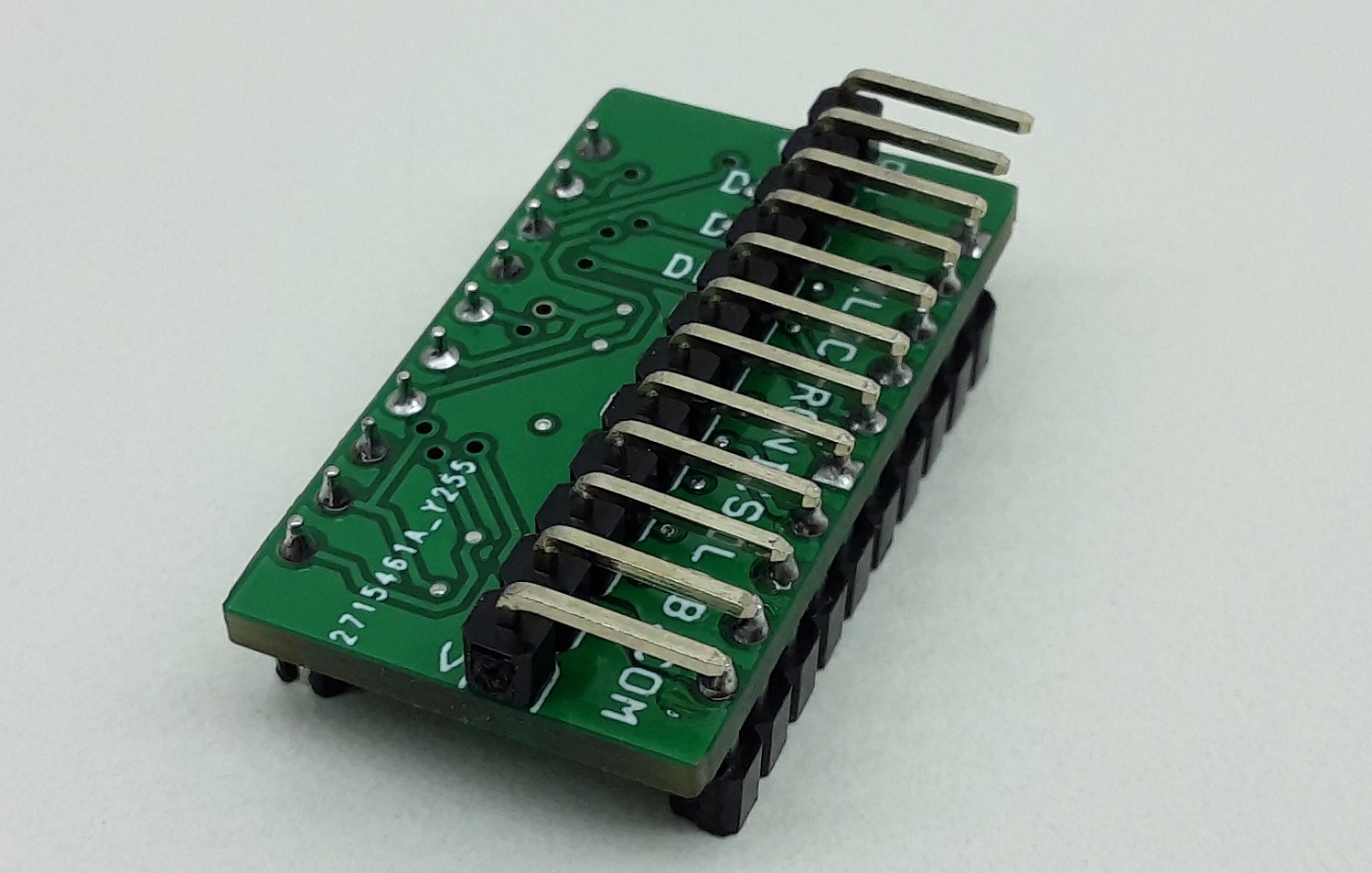

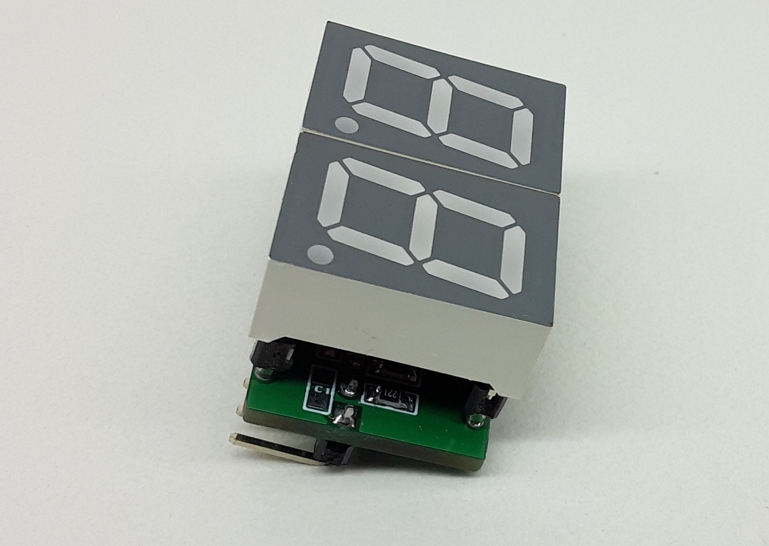

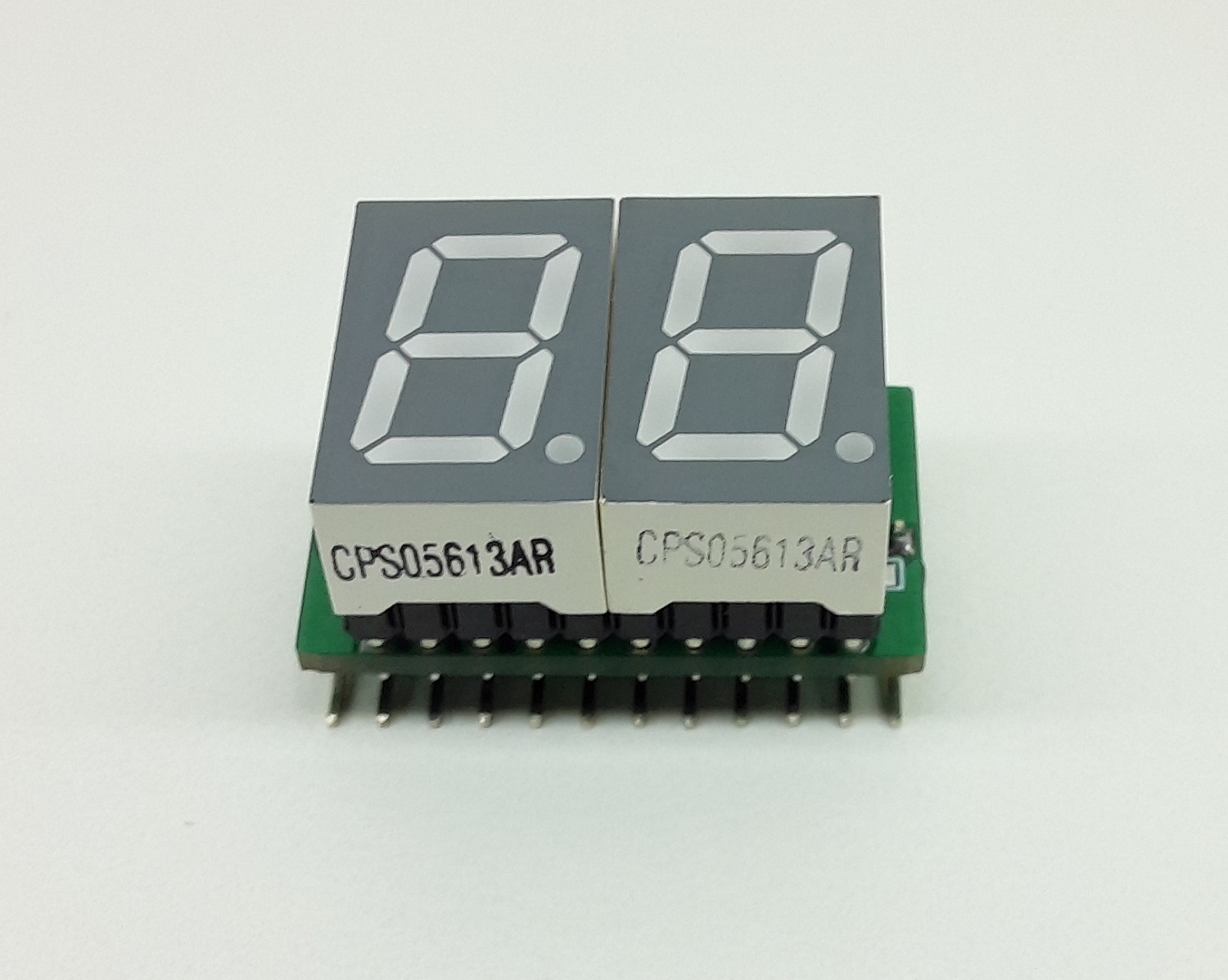

This 2 Digit 7 segment display project contains 2 x Common Cathode displays, current limiting resistors or each LED segment, 2 x PNP Transistor on each common cathode for multiplexing, etc. This is a very compact project that works with 5V TTL signals but can be optimized for 3.3V operations by reducing current limiting resistors' value.
This 2 Digit 7 segment display project contains 2 x Common Cathode displays, current limiting resistors or each LED segment, 2 x PNP Transistor on each common cathode for multiplexing, etc. This is a very compact project that works with 5V TTL signals but can be optimized for 3.3V operations by reducing current limiting resistors’ value. Header connector provided for easy interface to Arduino or other microcontrollers. All inputs are compatible with TTL 5V signals.

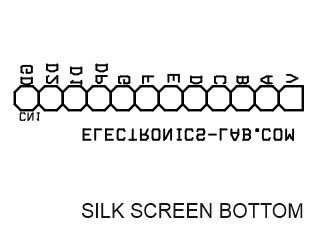

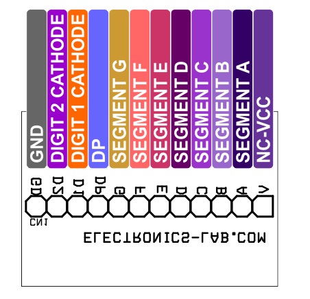

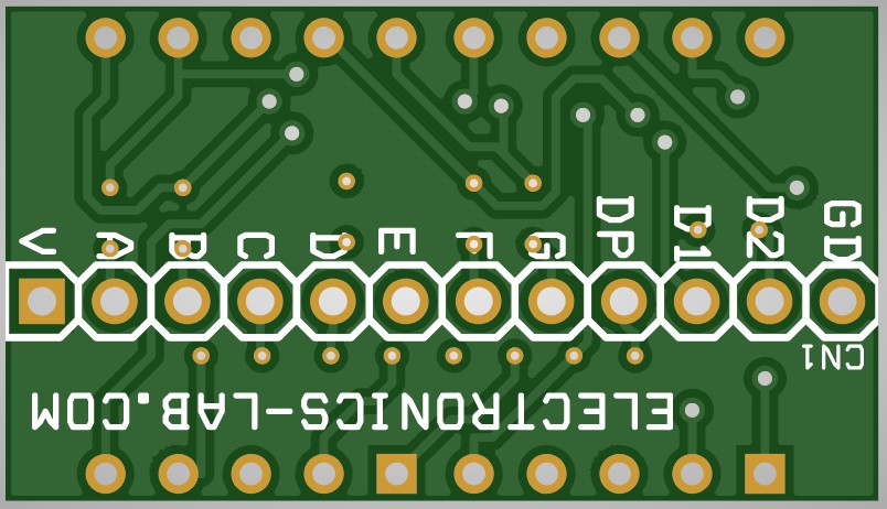

- PIN 1 NC (VCC-NO USE)
- PIN 2 SEGMENT A
- PIN 3 SEGMENT B
- PIN 4 SEGMENT C
- PIN 5 SEGMENT D
- PIN 6 SEGMENT E
- PIN 7 SEGMENT F
- PIN 8 SEGMENT G
- PIN 9 DP
- PIN 10 DISPLAY 1 CATHODE (BC847 BASE)
- PIN 11 DISPLAY 2 CATHODE (BC847 BASE)
- PIN 12 GND
- 7-segment CC displays
- Multiplexed
- 5V TTL input

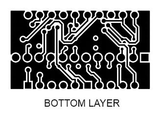

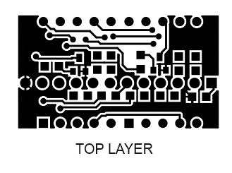

- PCB dimensions: 30.48 x 17.30 mm

Similar modules
- 4 Digit Common Cathode 0.5″ – 7 Segment Display Module (Multiplexed)
- 3 Digit Common Cathode 0.5″ – 7 Segment Display Module (Multiplexed)

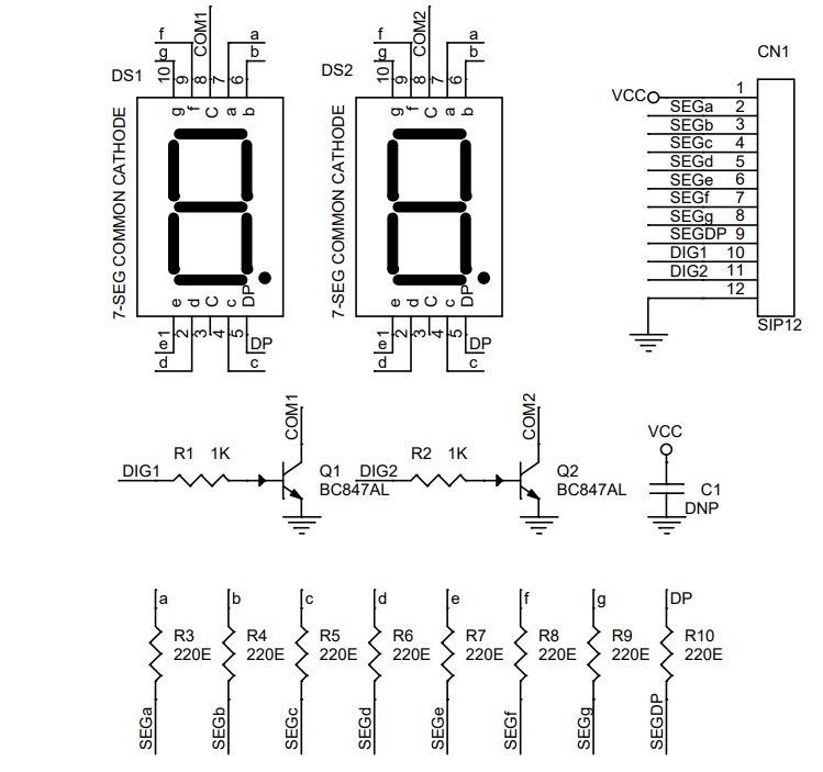

Schematic

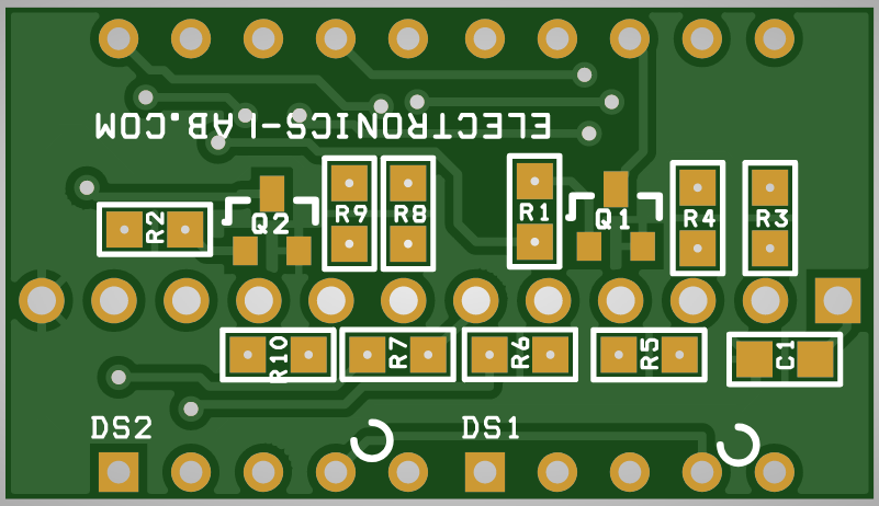

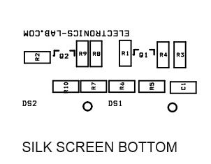

Parts List
| NO | QNTY. | REF | DESC | MANUFACTURER | SUPPLIER | SUPPLIER PART NO |
| 1 | 1 | CN1 | 12 PIN MALE HEADER CONNECTOR | WURTH | DIGIKEY | 732-5334-ND |
| 2 | 1 | C1 | DNP | |||
| 3 | 2 | DS1,DS2 | 7-SEG COMMON CATHODE 0.5 OR 0.56 INCH RED | SUN LED | DIGIKEY | 754-1705-5-ND or 754-1704-5-ND |
| 4 | 2 | Q1,Q2 | BC847AL | NEXPERIA | DIGIKEY | 1727-2924-2-ND |
| 5 | 2 | R1,R2 | 1K 5% SMD SIZE 0805 | MURATA/YAGEO | DIGIKEY | |
| 6 | 8 | R3,R4,R5,R6,R7,R8,R9,R10 | 220E 5% SMD SIZE 0805 | MURATA/YAGEO | DIGIKEY |
Connections
