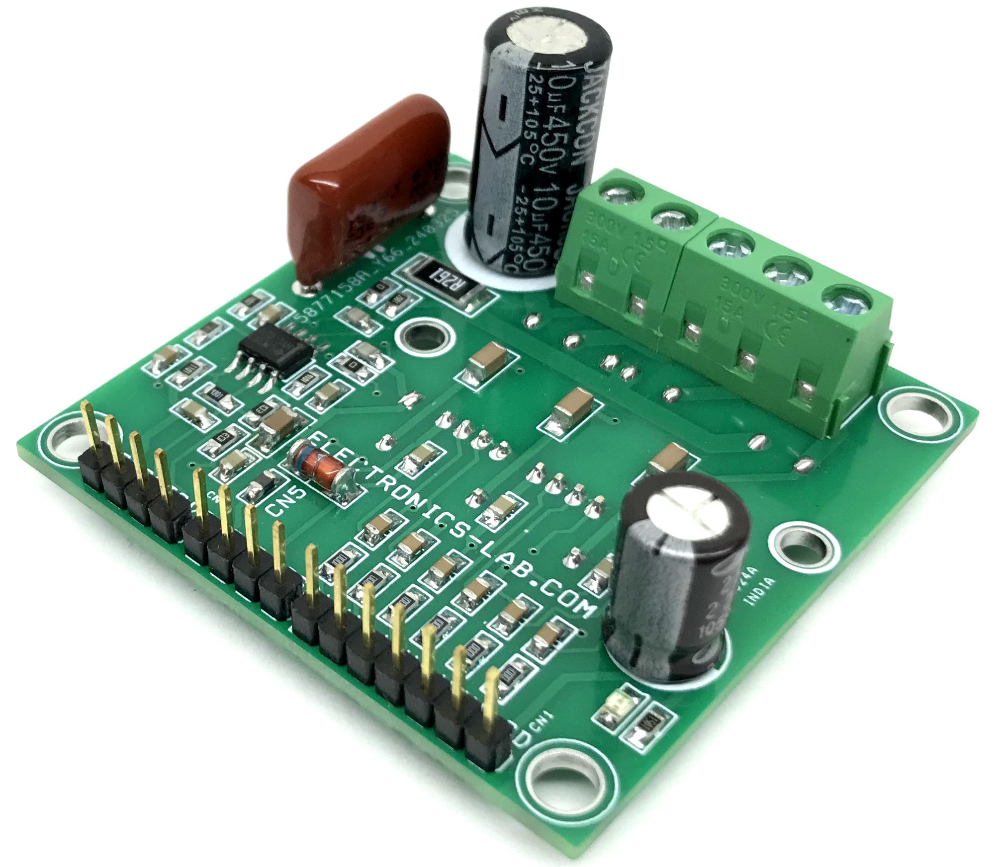

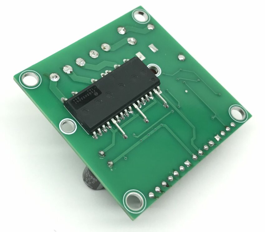

This is a 3-Phase Inverter Driver project designed for Small Power AC Motors. The project is built using FSB50550AT IPM chip.

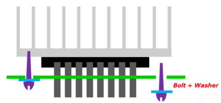

This is a 3-Phase Inverter Driver project designed for Small Power AC Motors. The project is built using FSB50550AT IPM chip. This compact and reliable inverter project is ideal for small power motors such as fans and pumps. An H-bridge configuration can also be created for low current high-voltage brushed DC motors. The Inverter board supports a load up to 2A. The DC power supply voltage is up to 400V DC. The project operates with 6 x PWM signals. Parameters for bootstrap circuit elements are dependent on the PWM algorithm. For 15 kHz switching frequency, Bootstrap capacitors C3, C4, and C5 value is 1uF. Resistor R4, R6, R7, R11, R15, R16 and capacitor C9, C10, C11, C12, C16, C17 prevent improper signal due to surge-noise. The logic supply is protected with a 20V Zener diode, which prevents surges under severe conditions. Comparator U2A provides low output when an overcurrent condition occurs, it measures the current across shunt resistor R13, and normal output is high. Comparator U2B is provided for over-temperature detection, the output of U2B is high when IPM temperature is below 80 degrees C, and goes low when the temperature reaches the threshold. A heatsink is a must for full load current, thus 2 mounting holes are provided throughout the PCB to mount the heatsink as shown in the Figure below. Silicone thermal compound, also called thermal grease, should be applied between the heat sink and the flat surface of the IPM to fill microscopic air gaps due to imperfect flatness that ultimately reduces the contact thermal resistance. The IPM module should be soldered first. Please take care of excessive torque that may bend the PCB.

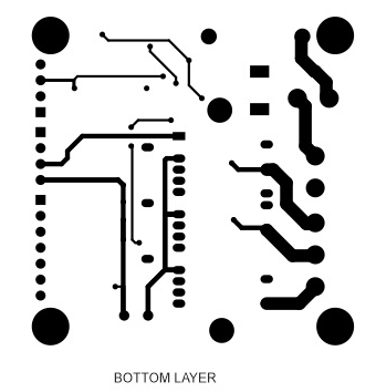

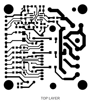

- PCB Dimensions 53.34 x 52.55 mm

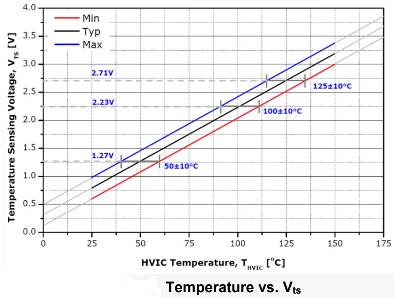

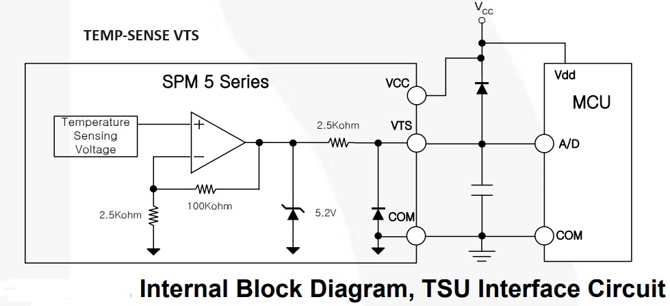

Temperature Sensing Output (VTS) – CN4 Pin 2-TO
Pin: VTS This indicates the temperature of the V-phase HVIC with an analog voltage output. HVIC itself creates some power loss, but mainly heat generated from the MOSFETs increases the temperature of the HVIC. Comparator U2B is used for over-temperature detection. Output is high in normal conditions when the temperature is below 80 degrees, and goes low when over-temperature condition occurs. The over-temperature threshold is 80oC.

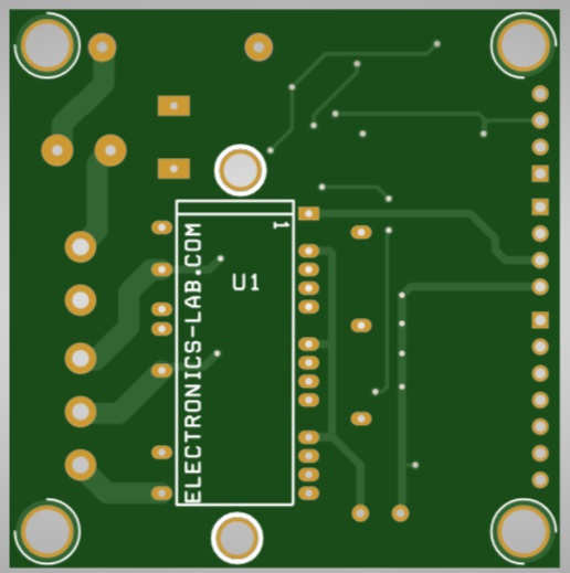

Connections

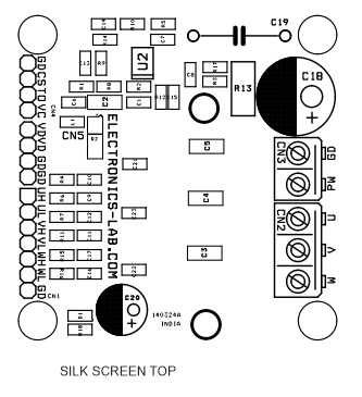

- CN1: Pin 1 = PWM U-High, Pin 2 = PWM U-Low, Pin 3 = PWM V-High, Pin 4 = PWM V-Low, Pin 5 = PWM W-High, Pin 6 = PWM W-Low, Pin 7 = GND
- CN2: 3 Phase Motor, Pin 1 = Phase=W, Pin 2 = Phase-V, Pin 3 = Phase-U
- CN3: Pin 1 = Motor Supply 400V DC, Pin 2 = GND
- CN4: Pin 1 = VCC 5V , Pin 2 = TO-NTC OUT , Pin 3 = Over Current/Fault, Pin 4 = GND
- CN5: Pin 1,2 = VDD 15V , Pin 3,4 = GND
- D1: Power LED for Logic Supply
