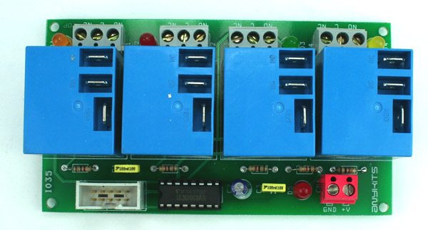

4 Channel Large Current Relay Board
4-Channel Relay Board is a simple and convenient way to interface 4 relays for switching application in your project. The project has large Relay which can switch current up to 20Amps.
4-channel-large-current-relay-board-img1

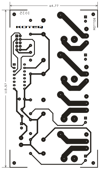

  • Four mounting holes of 3.2 mm each
  • PCB dimensions 65 mm x 116 mm

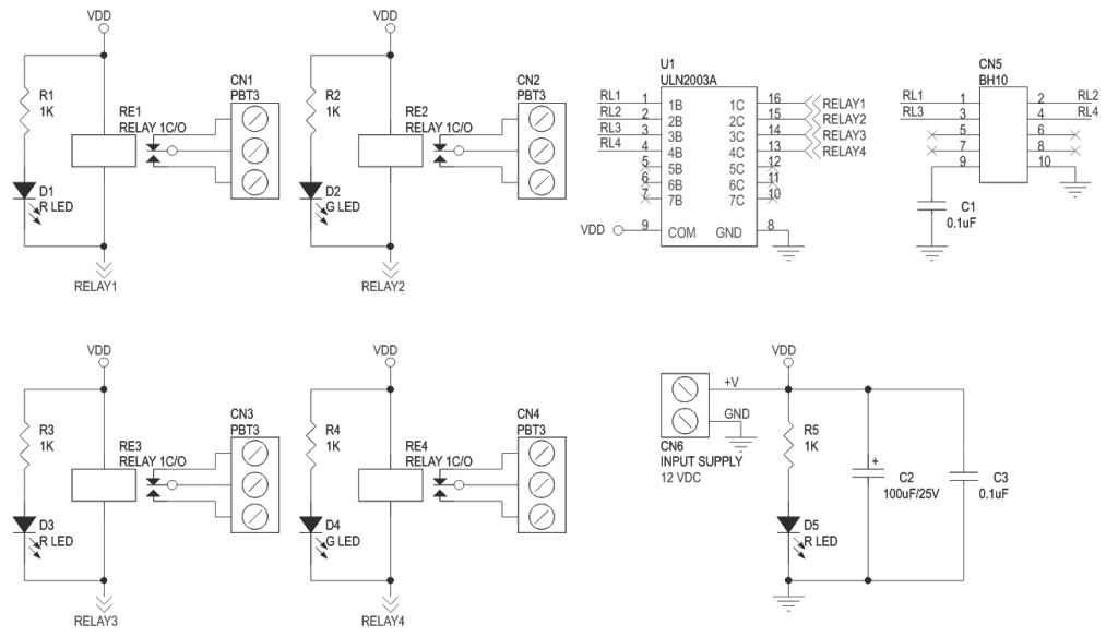

Schematic
4-channel-large-current-relay-board-schematic

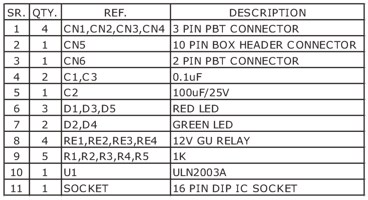

Parts List
4-channel-large-current-relay-board-parts
