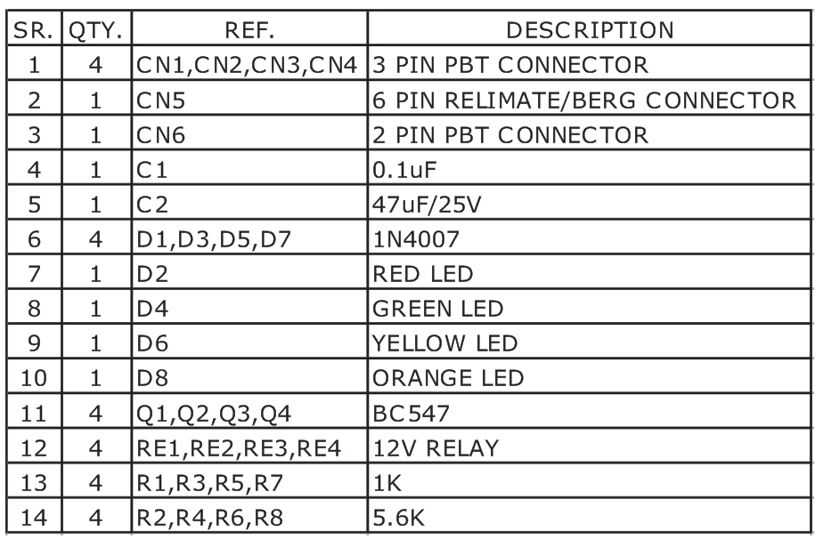

Schematic
Dear sir, i am making 4-channel relay board . but during making i have a problem with capacitor (like which type of capacitor is ? and how many volts ?). i want to know the capacitor detail used in 4-channel relay board .plz help me…
If you are reffering to C1, then a simple ceramic capacitor will do it’s job.
Can you explain why the capacitors? I found no relay module on the market that uses a capacitor.What is the need for it?
The capacitors are used for noise filtering of the power supply. If you use a filtered power supply you may omit them.
Hi,please provide the Gerber file
As requested, I’ve uploaded Gerber files above. Thanks

how if i want it without led ?
just remove led with 1k resistor?
Hi, I have a question please answer me. I bought components but I didn’t get what to do with this board. I don’t have an Arduino how can I connect it to bulb like you showed? what tool should i buy to make the connection with bulb?
Bulbs can be connected to the output of the relays. NEUTRAL from the mains goes to the bulb directly and LIVE goes to the C of the connector. Then NO goes to the other end of the bulb. This is like the diagram above.
