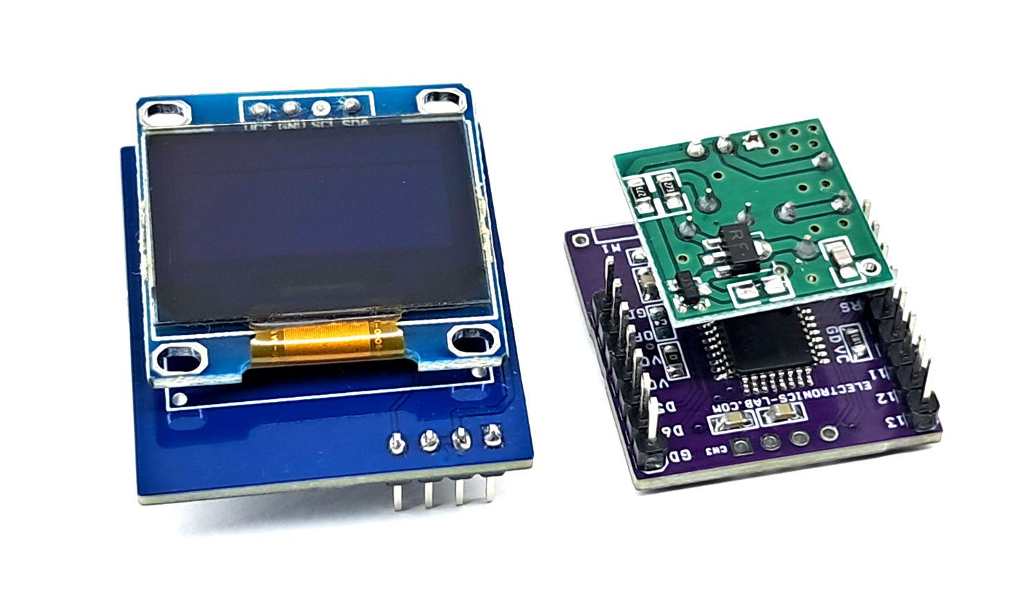

- Optional OLED installation: The project allows for the installation of an OLED display to display the transmitted/received data.

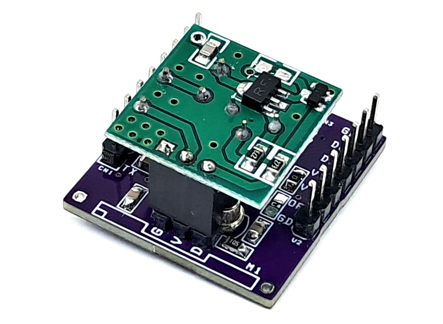

This Transmitter Project is compatible with the 434Mhz Arduino Wireless Analog Sensor Receiver
- Power Supply 5V DC @ 50mA
- On Board RF434 Module Connector
- Very Compact Low-cost solution
- Any Analog Sensor Can be connected (Analog value 0 to 1023)
- Optional OLED Display Option
- Optional 4 Pin Header Connector 2 Digital I/O D5 and D6
- 3 Pin Header Connector to connect sensor
- Temperature Sensor LM35 can be directly mounted on PCB

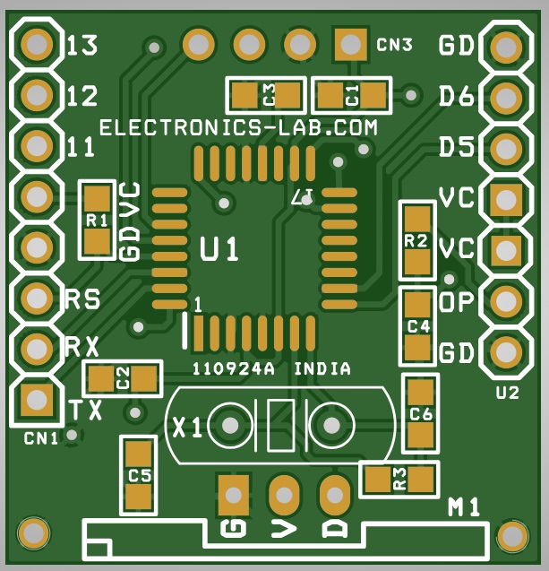

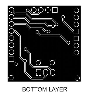

- PCB Dimensions 27.78 x 26.83 mm

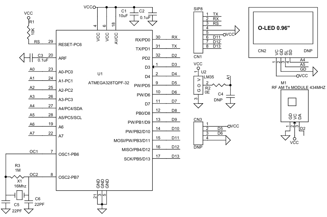

Connections
- CN1 Programming Connector: Pin 1 = TX, Pin 2 = RX, Pin 3 = Reset, Pin 4 = GND, Pin 5 = VCC, Pin 6 = D11, Pin 7 = D12, Pin 8 = D13

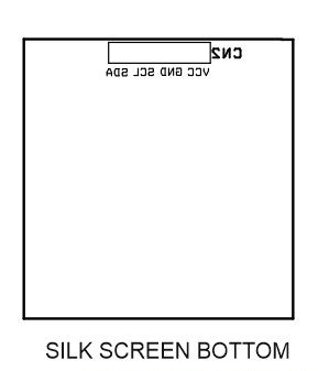

- CN2: OLED Display Optional 0.96Inc I/2C
- CN3: Optional I/O, Pin 1 = VCC, Pin 2 = D5, Pin 3 = D6, Pin 4 = GND
- U2 Analog Sensor: Pin 1 = VCC, Pin 2 Sensor, Pin 3 = GND
- M1: RF Module 434Mhz or 315Mhz ASK Transmitter 3 Pin
Schematic
Parts List
