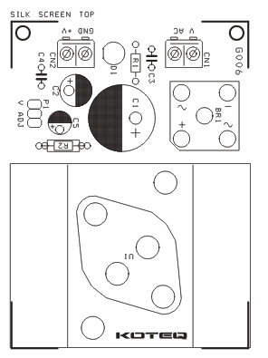

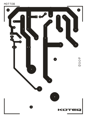

This project provides a variable output voltage ranging from 1.2 to 32 V @ 5 A. The project based on LM338K IC. LM338K is an adjustable 3 terminal positive voltage regulator capable of supplying a maximum of 5A over a 1.2V to 32V output range. The circuit is simple and consists of a few components.
  • Input Supply : 24 VAC or 30 VDC, 5 Amp
  • Output : variable output from 1.2 to 32 V @ 5 A regulated low ripple DC voltage
  • Heatsink for regulator IC
  • Onboard bridge rectifier to convert AC to DC
  • LED indication at input of IC
  • Thermal overload/short circuit protection (provided by IC feature)
  • Screw terminal connector for easy input and output connection
  • Berg connector for connecting potentiometer (POT) to the PCB
  • Filter capacitors for low ripple DC output
  • Four mounting holes of 3.2 mm each
  • PCB dimensions 91 mm x 66 mm
