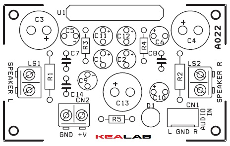

  • Berg pins for connecting of inputs
  • Power Battery Terminal (PBT) for easy power supply and speakers connection
  • Power-On LED indicator

  • Heat-sink for IC Four mounting holes of 3.2 mm each with nut and stud

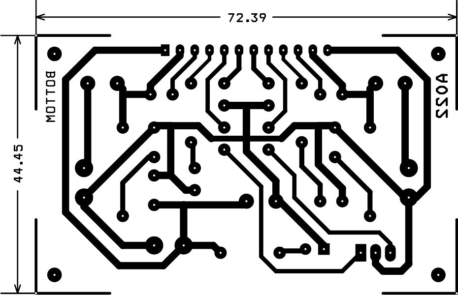

  • PCB dimensions 45 mm x 73 mm

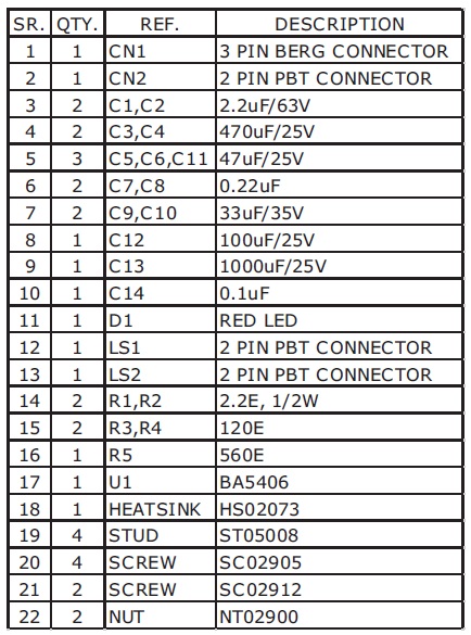

Parts List
5W_Stereo_BOM
