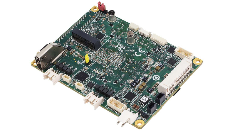

AAEON has introduced the AAEON PICO-ADN2 SBC, a compact Pico-ITX single-board computer (SBC) designed for embedded systems where board space matters. Measuring just 100 × 72 mm, the board combines Intel Alder Lake-N processing, onboard LPDDR5 memory, dual Ethernet, multiple display interfaces, and industrial I/O in a small footprint. AAEON targets the platform at transportation systems, digital signage, industrial automation, and smart kiosks.
The board comes in two main configurations. The entry variant uses the 12W Intel Processor N97 with 8GB of LPDDR5 memory, while the higher-performance version pairs the 15W Intel Core i3-N305 with 16GB of LPDDR5. Both versions support 12V power input and operate across a -20°C to 70°C temperature range, making the board suitable for a range of embedded deployments.

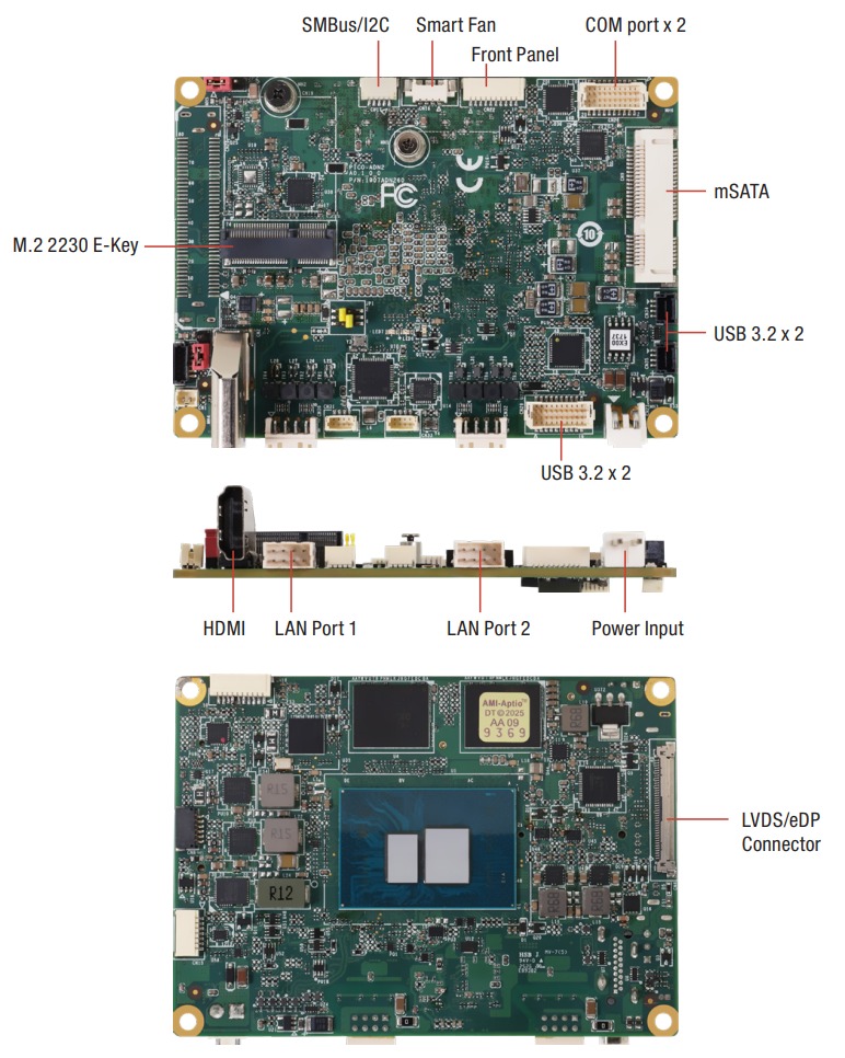

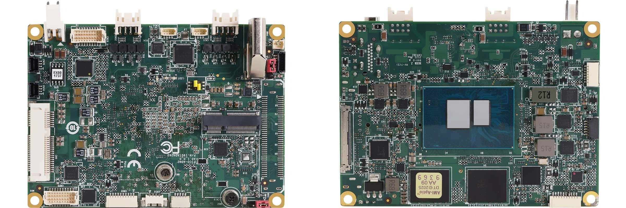

AAEON PICO-ADN2 SBC top and bottom side

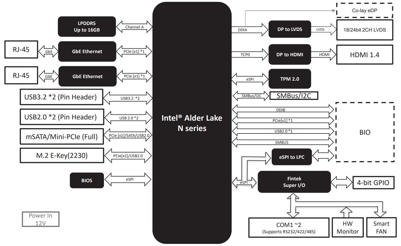

Block Diagram
Block Diagram
