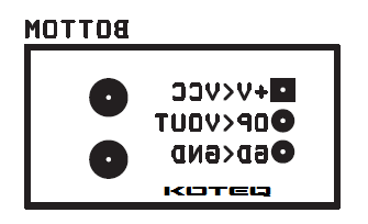

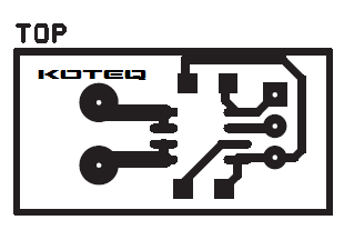

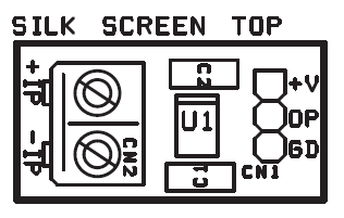

ACS714-30A Current Sensor module
The Allegro ACS714-30A provides economical and precise solution for AC or DC current sensing in automotive systems. The device package allows for easy implementation by the customer.
acs714-30a-current-sensor-module-img
The Allegro ACS714-30A provides economical and precise solution for AC or DC current sensing in automotive systems. The device package allows for easy implementation by the customer. Typical applications include motor control, load detection and management, switched-mode power supplies, and overcurrent protection.
  • Supply 5V DC
  • Output 66mV/1Amp

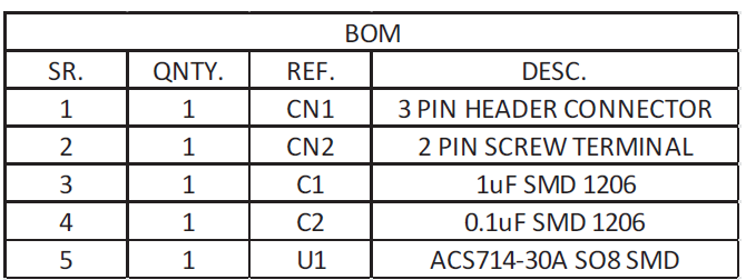

Parts List
acs714-30a-current-sensor-module-bom
