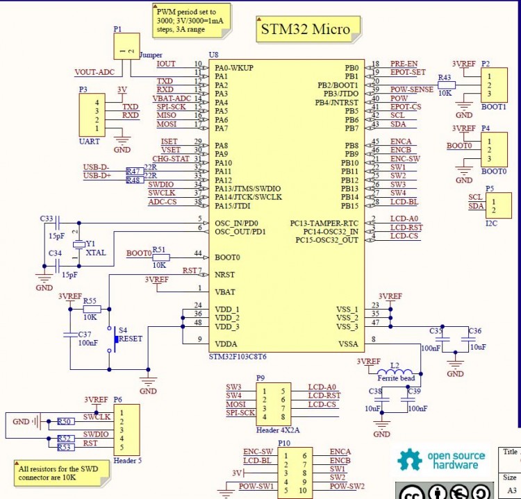

Microcontroller
The entire voltage and current limit is controlled by a STM32F103 microcontroller. It might seem as a bit of an overkill for such a project, but actually these microcontrollers are quite cheap and they have the 12 bit PWM required for this project. The STM32 controls pretty much the entire power supply, including the switching pre-regulator, the output voltage and current limit and the front panel with an LCD, swtches and a rotary encoder used to set the desired values.  Some USB capability can be added in the future. The user can also make use of the UART connector to plug in some bluetooth or Ethernet modules (with some additional code).
micro

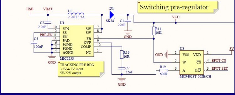

Pre-Regulator
Since two batteries in series give only 8.4V maximum, the power supply needs a boost converter to get the 20V output, and it obviously has one. The MIC2253 with a couple of adjacent components provides the required voltage. The idea is that the DC-DC converter boosts the voltage and the linear regulator provides a smooth output.  The bonus is, that with a small digital pot, the microcontroller can keep the input voltage just at the required level (about 2V above desired output) which minimises losses of energy from the battery and the heating of MTB3055 pass transistor.
The STM32 can even switch the pre-regulator off if required and just rely on the batteries powering the linear regulator directly.
pre-reg

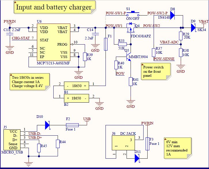

Input and Battery Charger
The batteries can be charged from DC input only, since the USB has too low a voltage to be able to charge batteries at 8.4V. However, when you plug the USB, the STM32 switches the batteries off and the entire power supply can be powered from USB (with power limited to 2.5W obviously). So in theory the AmpStrike can operate just on USB, without the batteries. The disadvantage of my design is that the USB is in no way isolated from the rest of the circuit. But provided that the microcontroller continously prevents the circuit from drawing more than 2.5W it shouldn’t be a huge problem especially since USB, DC input and batteries are all protected with resettable fuses.
input + charger
The schematic also contains an external TS7001 12 bit ADC for measuring the output voltage, but I probably will end up measuring the output with the internal ADC in STM32. I am not sure yet, since I’m not really that familliar with the internal ADCs in these microcontrollers.

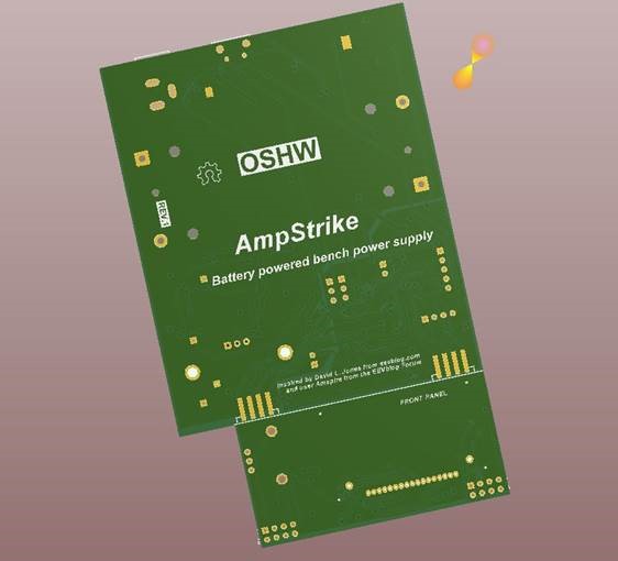

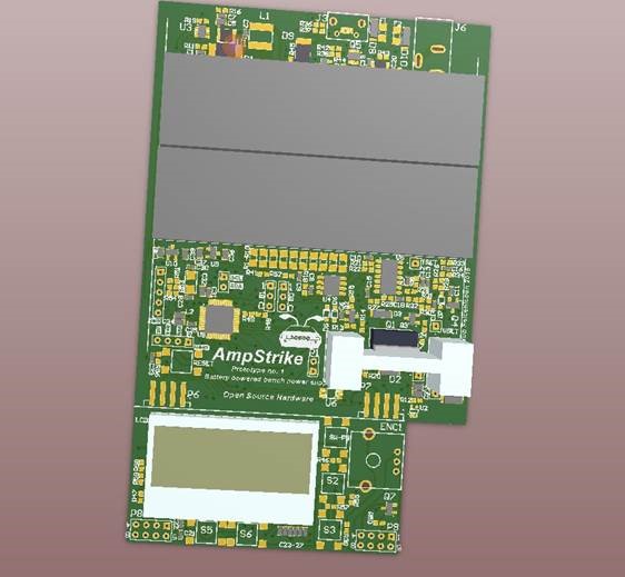

The PCB is designed with a front panel, which is v-scored to break it off and to mount it at a right angle on the main board. The power supply will be encased in a small aluminium enclousure.
