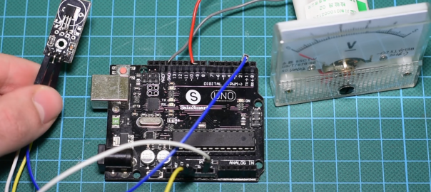

Fortunately, the circuit is so simple. At the beginning, connect the DS18b20 pin with the (-) sign to Arduino GND, the pin with (+) sign to 5V and the signal pin to digital pin 2, in order to start sensing the temperature.

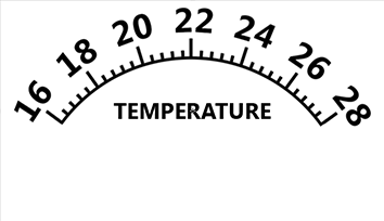

Secondly, in order to control the voltmeter we connect the positive side to digital pin 9 (one of the PWM pins) and the negative to GND. Afterward, to change the labels of voltmeter to a Celsius thermometer, just download the photo in the attachments and print it out!
