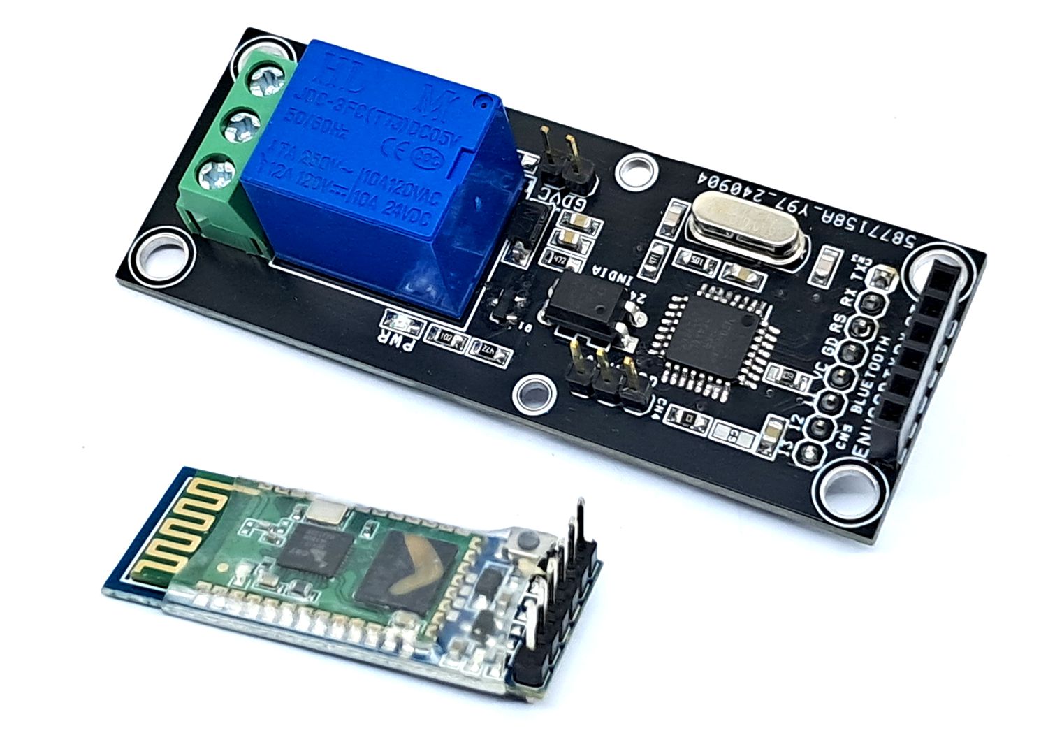

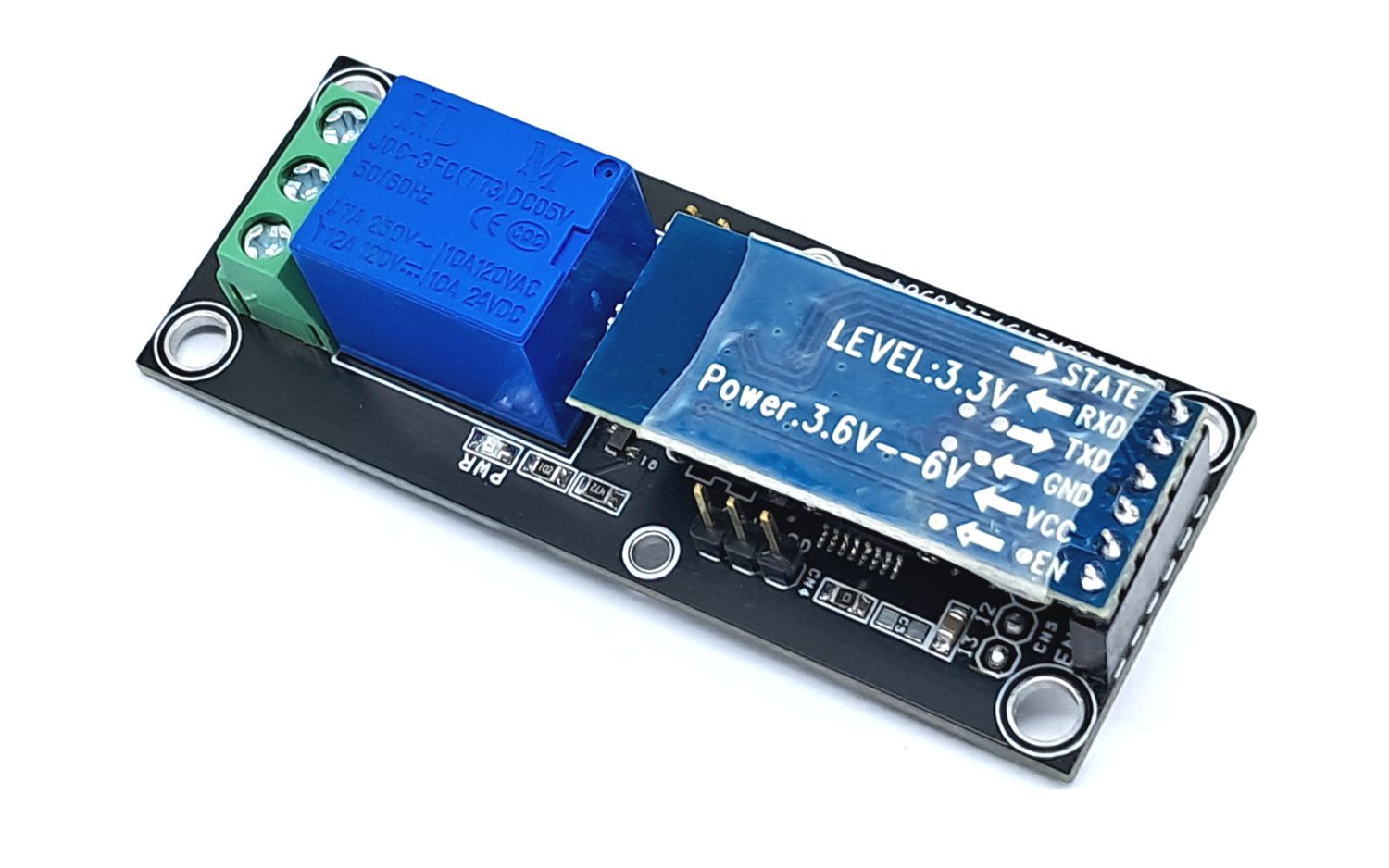

Arduino Bluetooth Relay Switch

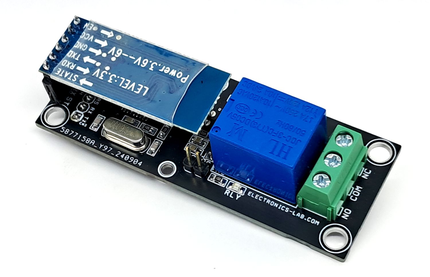

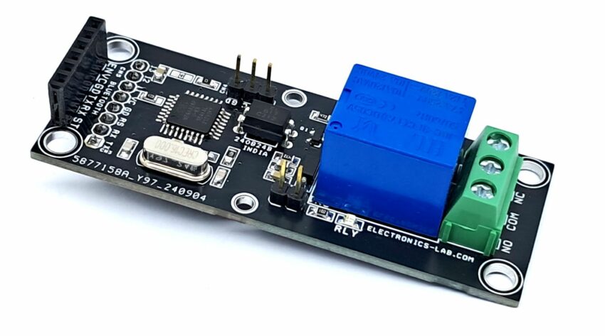

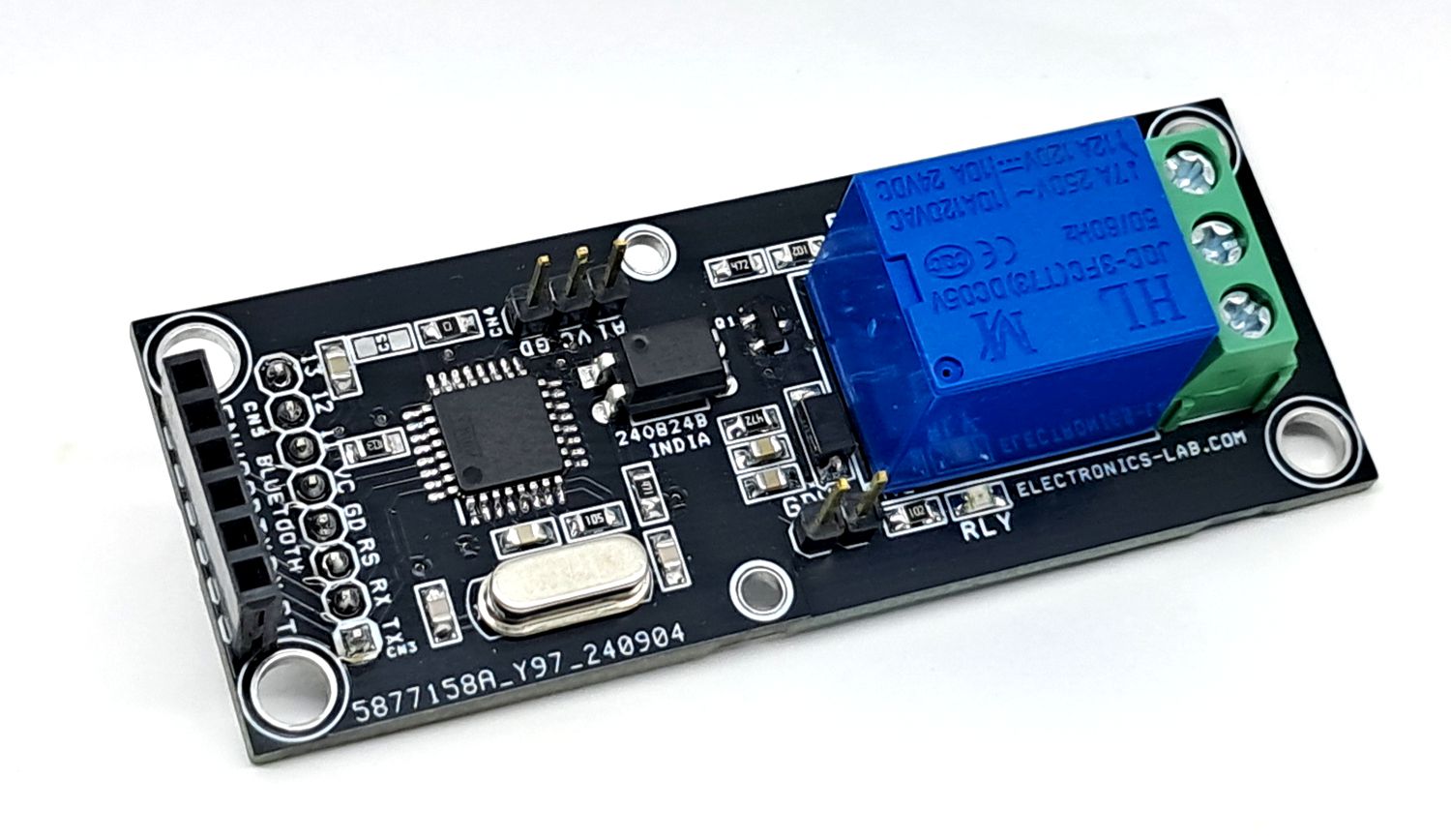

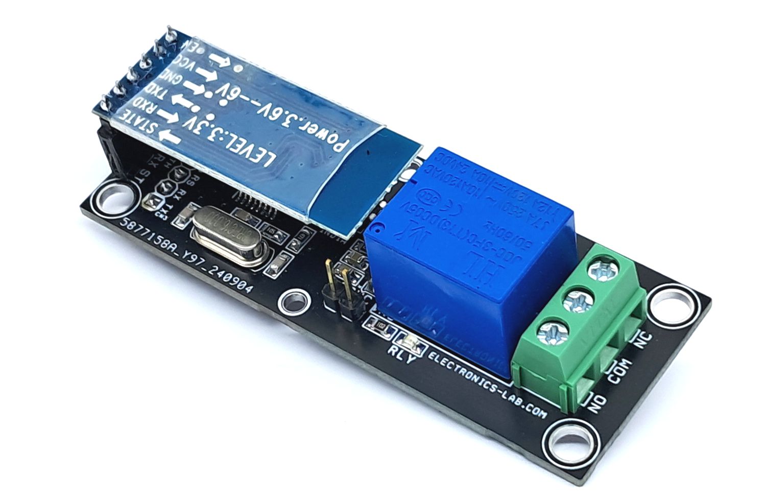

This Bluetooth Relay Switch enables users to control lights, fans, or other devices using a Bluetooth app on an Android device. The device can be controlled using a simple app.

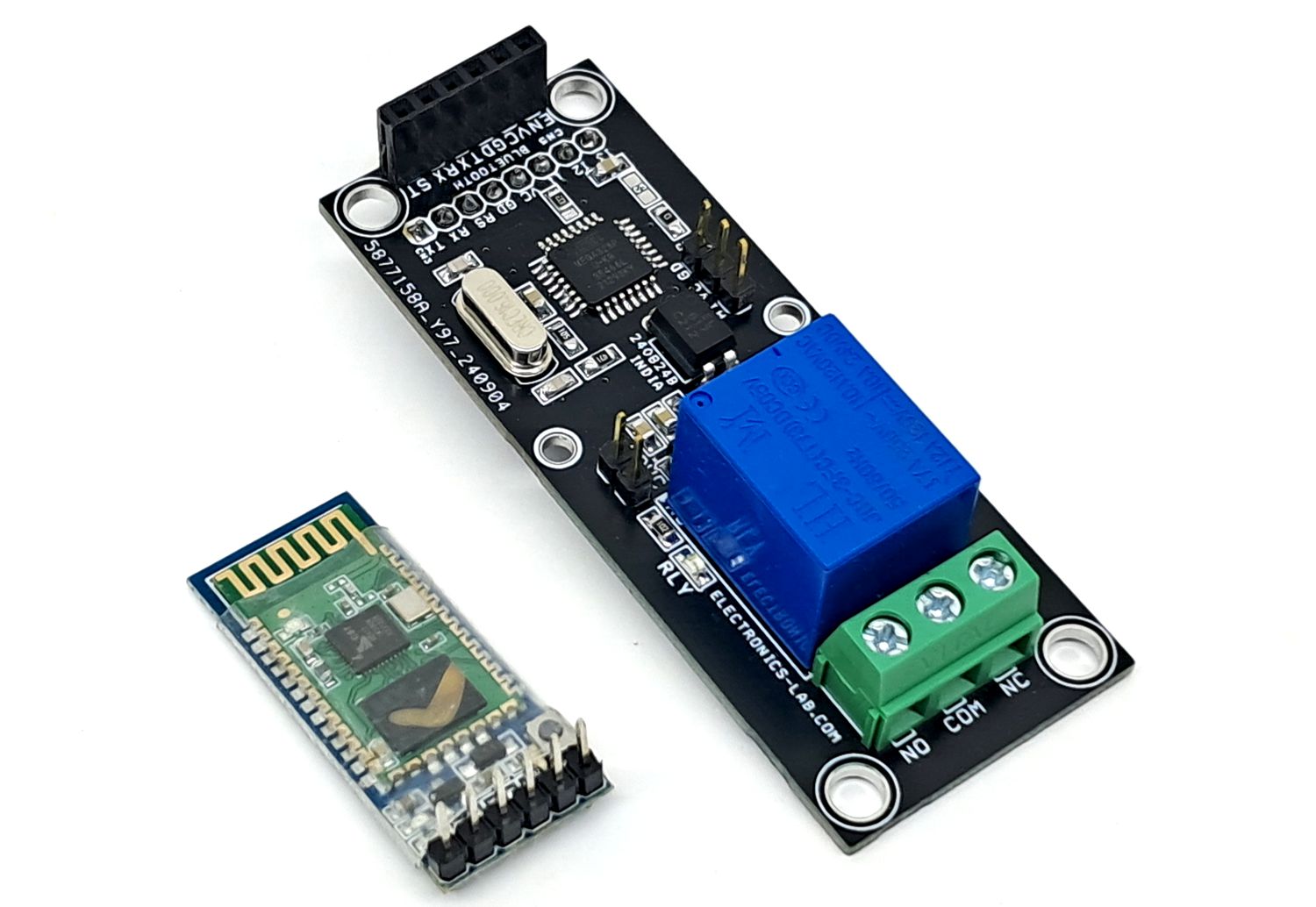

This Bluetooth Relay Switch enables users to control lights, fans, or other devices using a Bluetooth app on an Android device. The device can be controlled using a simple app. The project consists of an Arduino-compatible microcontroller (ATMEGA328), a 5V relay, a relay driver BJT, and an optocoupler, which provides isolation between the relay and microcontroller, ensuring noise immunity and preventing high voltage entering the DC circuit. The HC-05 Bluetooth module provides wireless connectivity between the Android app and the Bluetooth board. Screw terminals are provided to connect the load to the relay contacts, and a header connector is available to power the board with 5V. A power LED indicates the presence of power, and a relay LED indicates relay operations. The relay contacts can handle loads up to 7A/250V AC and 10A/24V DC. An 8-pin header connector is provided for Arduino programming and Bootloader load.

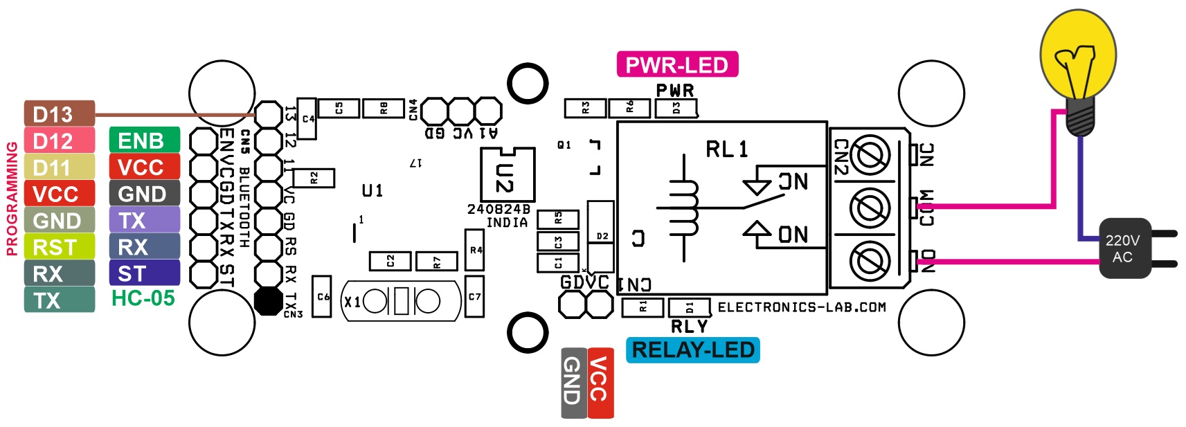

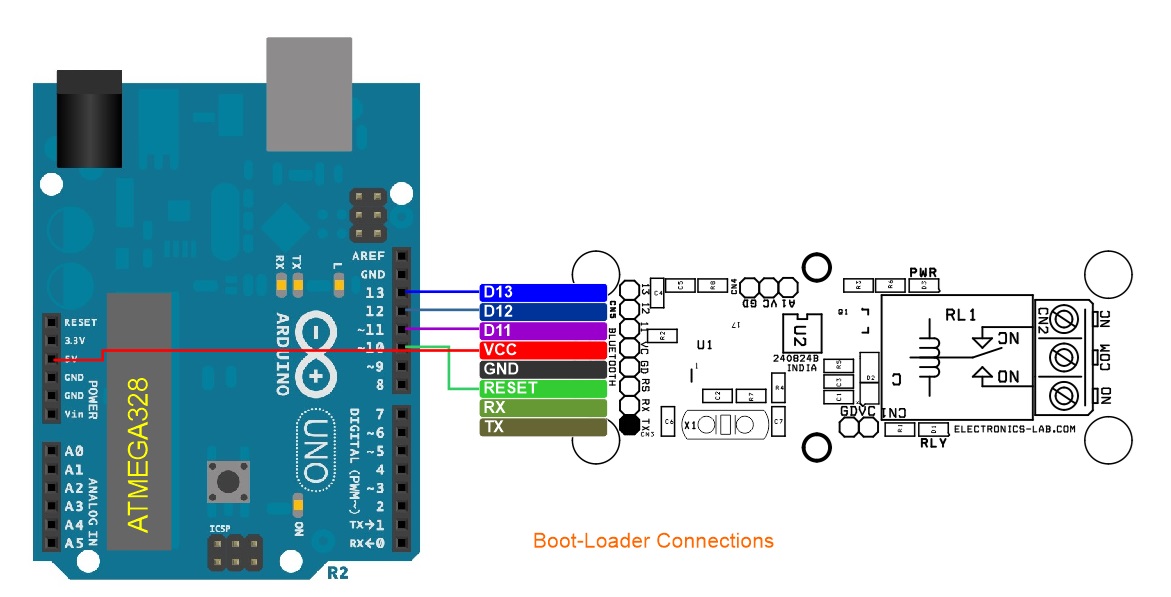

Bootloader and Arduino Programming
To test the board, download the Arduino code and upload it to the ATMEGA328 microcontroller. Before uploading the code, ensure that the Bootloader is loaded on the new ATMEGA328.
Refer to the connections diagram for Arduino programming and bootloader instructions.
https://docs.arduino.cc/built-in-examples/arduino-isp/ArduinoToBreadboard/

- Power Supply 5V DC @ 100mA
- Wireless Bluetooth Connectivity
- On Board Power LED
- On Board Relay LED
- 4 x 4 mm Mounting Holes
- PCB Dimensions 74.61 x 28.89 mm

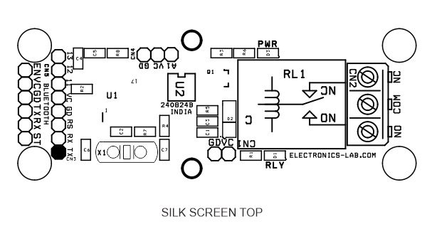

Connections
- CN1: Pin 1 VCC 5V DC, Pin 2 = GND
- CN2: Relay Contacts, Pin 1 = Relay Normally Closed (NC) , Pin 2 = GND, Pin 3 = Normally Open (NO)
- D1: Relay LED
- D3: Power LED
- CN5: Bluetooth HC-05 Module

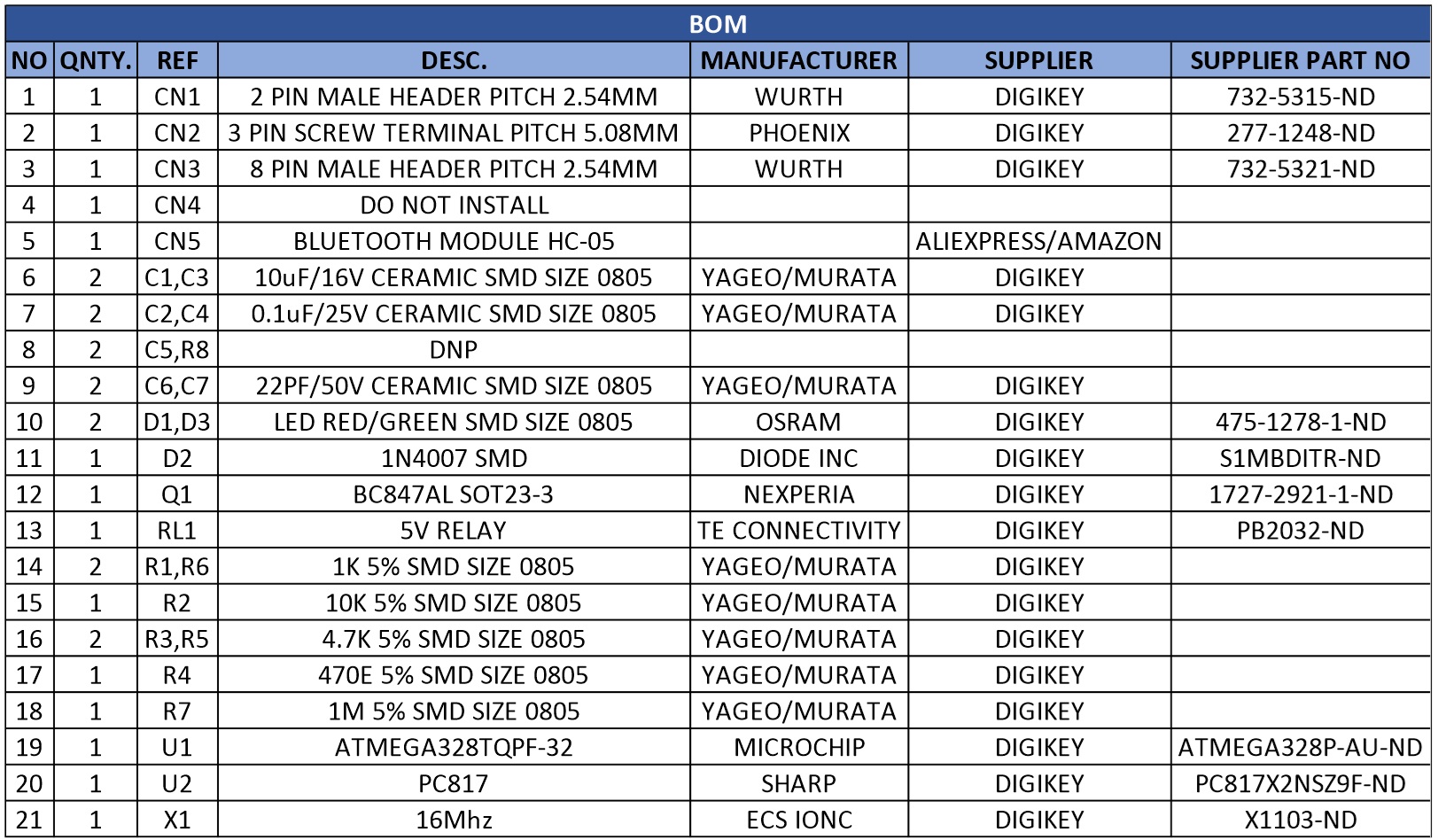

Parts List
| NO | QNTY. | REF | DESC. | MANUFACTURER | SUPPLIER | SUPPLIER PART NO |
| 1 | 1 | CN1 | 2 PIN MALE HEADER PITCH 2.54MM | WURTH | DIGIKEY | 732-5315-ND |
| 2 | 1 | CN2 | 3 PIN SCREW TERMINAL PITCH 5.08MM | PHOENIX | DIGIKEY | 277-1248-ND |
| 3 | 1 | CN3 | 8 PIN MALE HEADER PITCH 2.54MM | WURTH | DIGIKEY | 732-5321-ND |
| 4 | 1 | CN4 | DO NOT INSTALL | |||
| 5 | 1 | CN5 | BLUETOOTH MODULE HC-05 | ALIEXPRESS/AMAZON | ||
| 6 | 2 | C1,C3 | 10uF/16V CERAMIC SMD SIZE 0805 | YAGEO/MURATA | DIGIKEY | |
| 7 | 2 | C2,C4 | 0.1uF/25V CERAMIC SMD SIZE 0805 | YAGEO/MURATA | DIGIKEY | |
| 8 | 2 | C5,R8 | DNP | |||
| 9 | 2 | C6,C7 | 22PF/50V CERAMIC SMD SIZE 0805 | YAGEO/MURATA | DIGIKEY | |
| 10 | 2 | D1,D3 | LED RED/GREEN SMD SIZE 0805 | OSRAM | DIGIKEY | 475-1278-1-ND |
| 11 | 1 | D2 | 1N4007 SMD | DIODE INC | DIGIKEY | S1MBDITR-ND |
| 12 | 1 | Q1 | BC847AL SOT23-3 | NEXPERIA | DIGIKEY | 1727-2921-1-ND |
| 13 | 1 | RL1 | 5V RELAY | TE CONNECTIVITY | DIGIKEY | PB2032-ND |
| 14 | 2 | R1,R6 | 1K 5% SMD SIZE 0805 | YAGEO/MURATA | DIGIKEY | |
| 15 | 1 | R2 | 10K 5% SMD SIZE 0805 | YAGEO/MURATA | DIGIKEY | |
| 16 | 2 | R3,R5 | 4.7K 5% SMD SIZE 0805 | YAGEO/MURATA | DIGIKEY | |
| 17 | 1 | R4 | 470E 5% SMD SIZE 0805 | YAGEO/MURATA | DIGIKEY | |
| 18 | 1 | R7 | 1M 5% SMD SIZE 0805 | YAGEO/MURATA | DIGIKEY | |
| 19 | 1 | U1 | ATMEGA328TQPF-32 | MICROCHIP | DIGIKEY | ATMEGA328P-AU-ND |
| 20 | 1 | U2 | PC817 | SHARP | DIGIKEY | PC817X2NSZ9F-ND |
| 21 | 1 | X1 | 16Mhz | ECS IONC | DIGIKEY | X1103-ND |
Connections

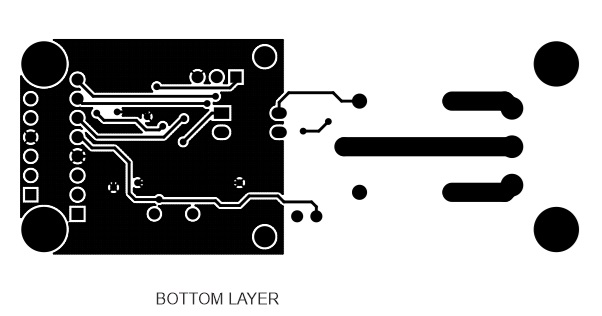

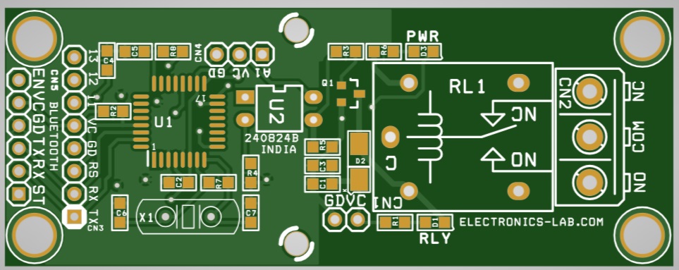

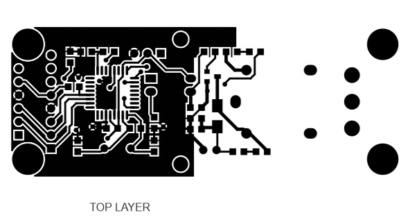

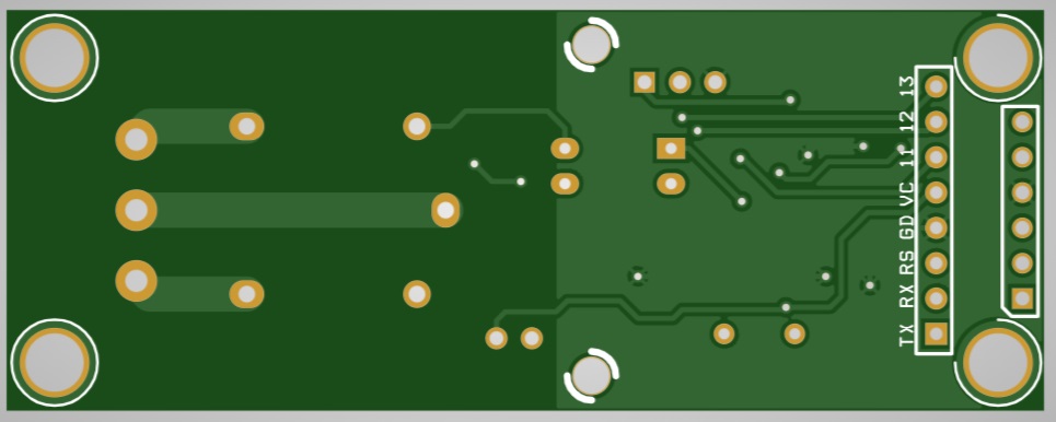

Gerber View

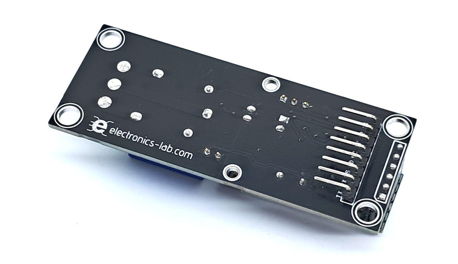

Photos
