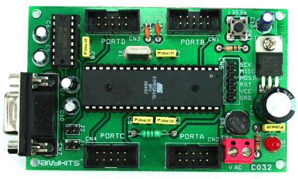

ATmega16/32 Development Board
ATmega16/32 Development Board provides a very simple and cost effective platform for prototyping solution. The compact design provides connection to all the pins of the microcontroller for the user.
C032_1

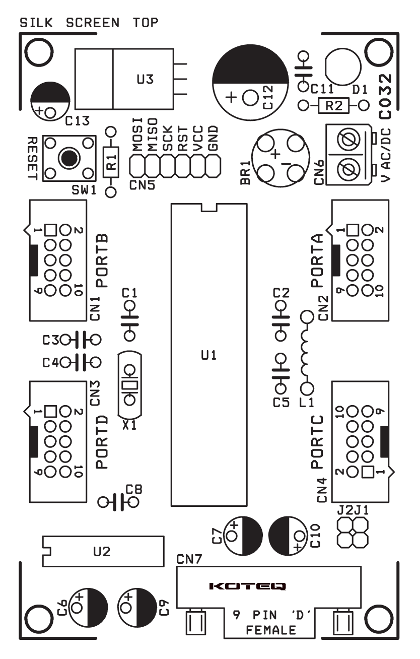

  • Prototyping solution available for 40-pin ATmega series AVR microcontroller from ATMEL
  • All the four ports available to the user via standard 10 pin box header connector with supply of 5 VDC for interfacing circuits
  • Onboard reset switch for easy reset of the microcontroller
  • ISP (In circuit Serial Programming) connector available for chips with ISP support
  • 8 MHz Crystal onboard
  • UART level shifter circuit using MAX232 IC, onboard for easy connection of the board to the RS232 devices
  • Jumper selectable connection available for connecting the UART level shifter to the port pins
  • Onboard voltage regulator available for sourcing regulated 5V @ up to 0.6A voltage to the board and connecting circuit
  • Power-On LED indicator
  • Four mounting holes of 3.2 mm
  • PCB dimensions 64 mm x 101 mm

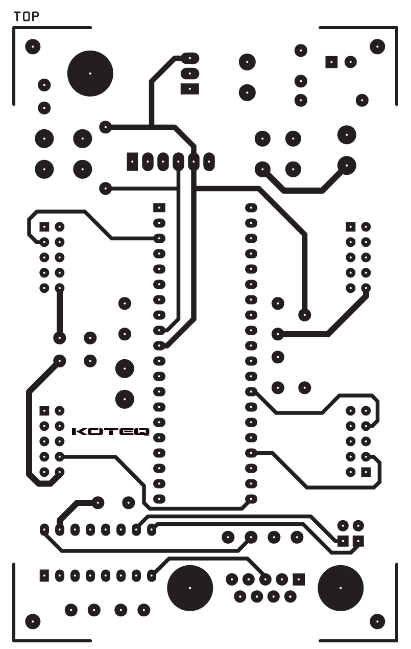

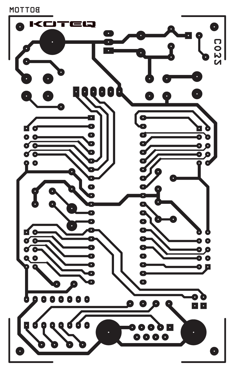

Schematic
SCHEMATIC

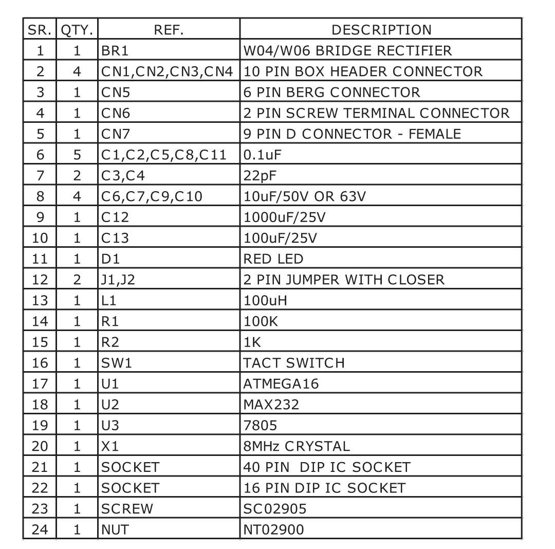

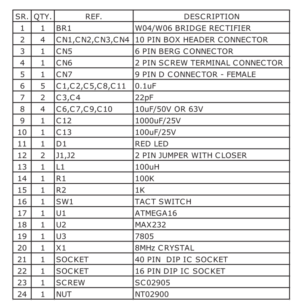

Parts
BOM

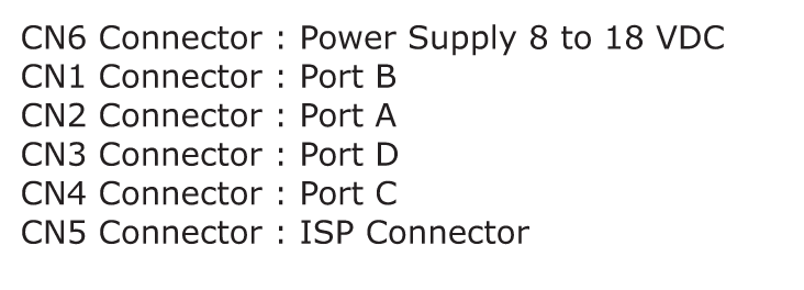

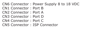

Connectors
CONNECTORPhoto
