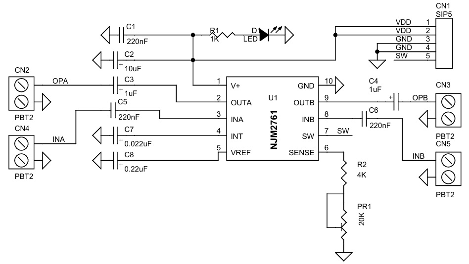

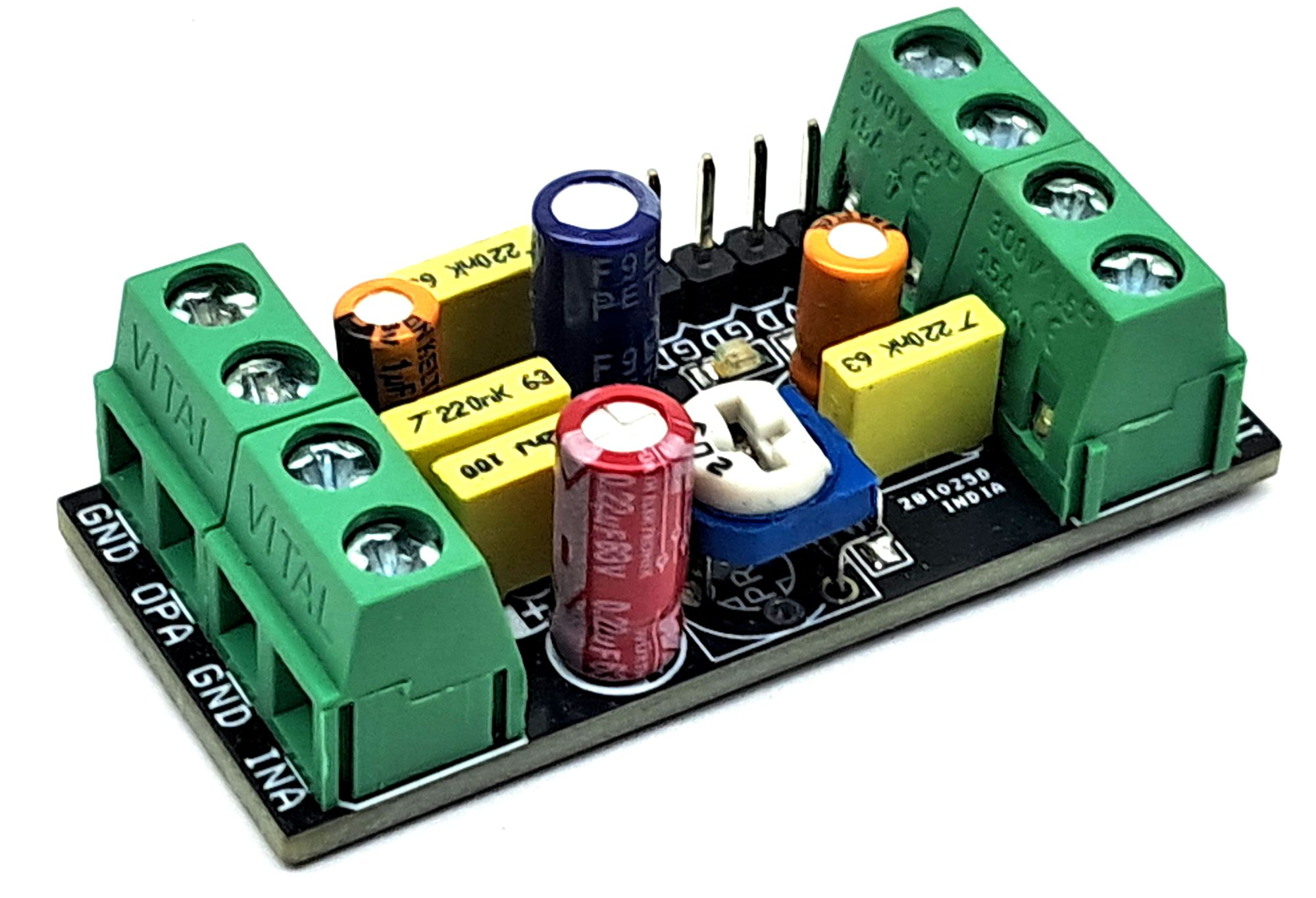

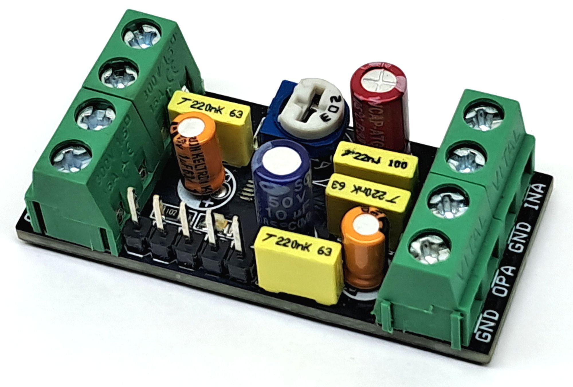

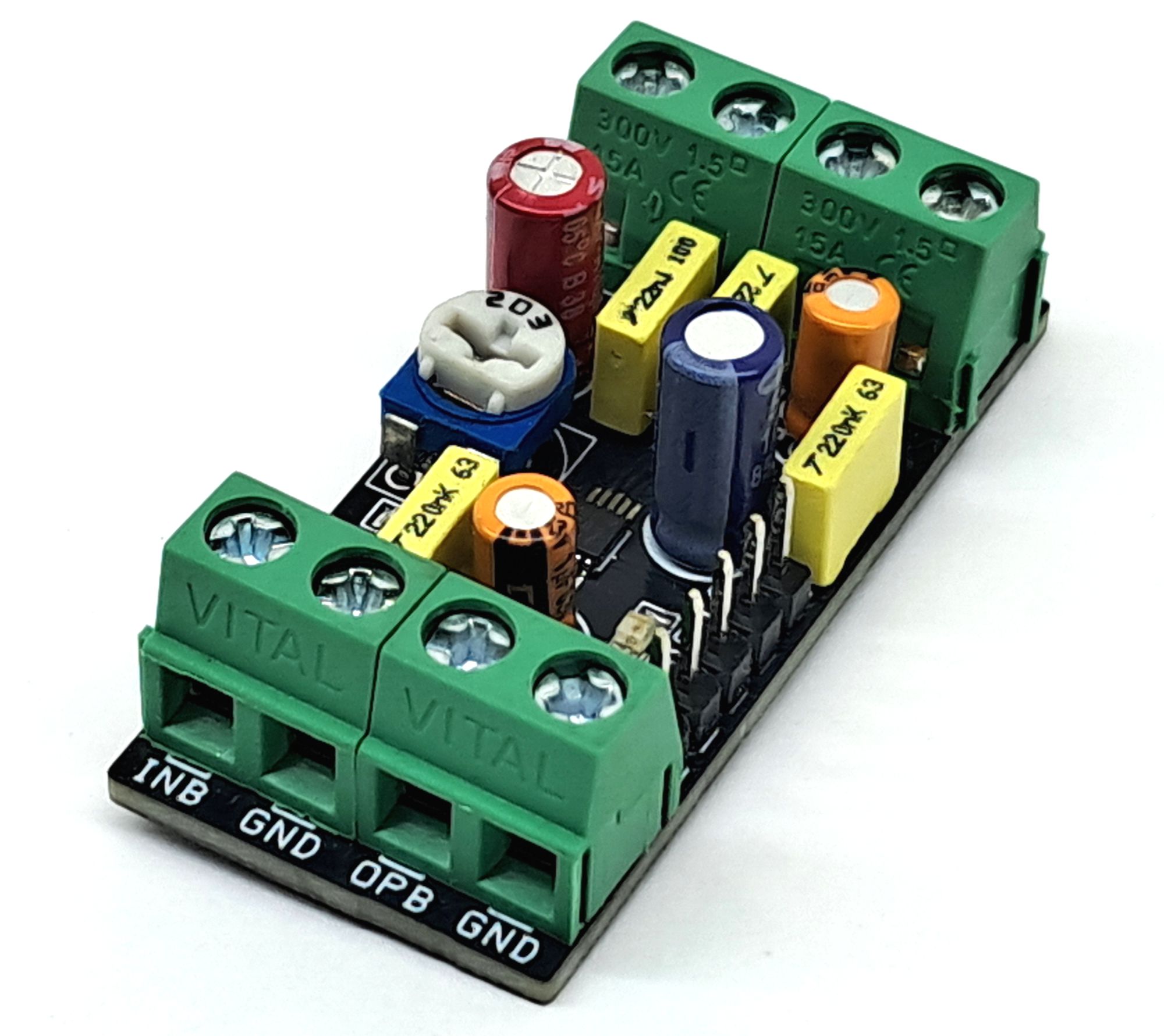

This simple project is an audio limiter based on the NJM2761 chip. It provides effective protection for speakers by limiting the audio signal level. The limit level is adjustable through an external trimmer potentiometer (PR1).
Screw terminals allow easy connection of the audio input and output signals, while header connectors are provided for powering the board. The project operates over a wide supply voltage range of 2.7 V to 13 V DC. The output is low-noise, and the variable limit level can be adjusted from 0.2 V to 1 V using the PR1 trimmer potentiometer.
Note: When a signal is applied to either channel (A-CH or B-CH), the effective limit level becomes twice the set value.

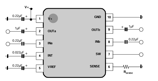

Calculations
RSENSE=4000/Vlim[Ohm]
Vlim:  Limit level (Vrms)
Limit range: 200mVrms to 1Vrms (20k to 4kOhm)
  • Supply 2.7V to 13V DC
  • Stereo Input and Output
  • Screw terminals for Audio Input and Output
  • On Board Power LED
  • Header Connector for Power Input
  • PCB Dimensions 45.72 x 20.96 mm

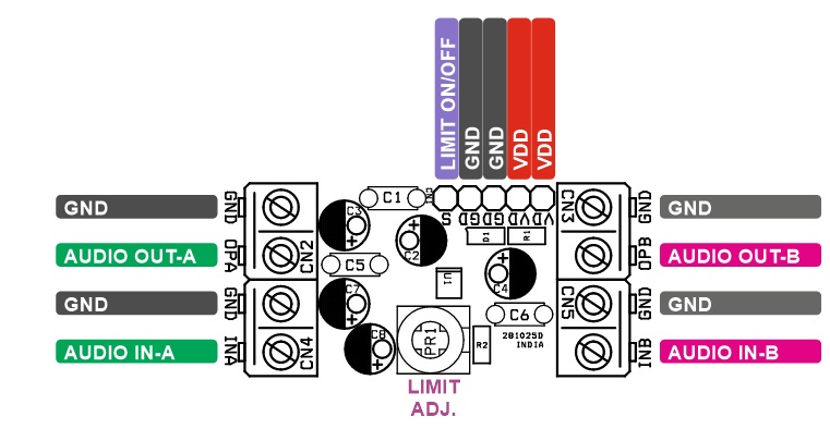

Connections
  • CN1: Pin 1,2 = VDD 2.7V to 13V DC, Pin 3,4 = GND, Pin 5 = Limit ON/OFF
  • CN2: Pin 1 = Audio Output Channel A, Pin 2 = GND
  • CN3: Pin 1 = Audio Output Channel B, Pin 2 = GND
  • CN4: Pin 1 = Audio Signal Input Channel A, Pin 2 = GND
  • CN5: Pin 1 = Audio Signal Input Channel B, Pin 2 = GND
  • PR1: Audio Limit Adjust
  • D1: Power LED
Schematic

Simplified Schematic

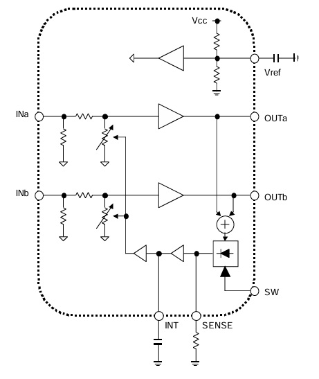

Block Diagram

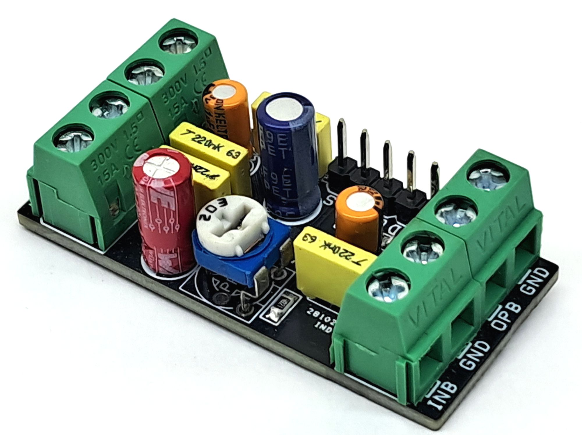

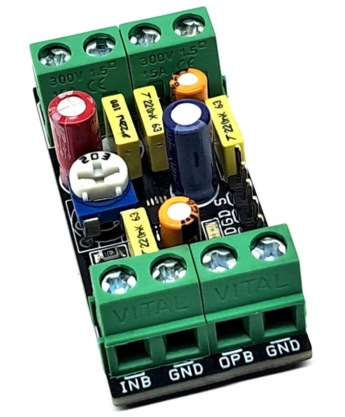

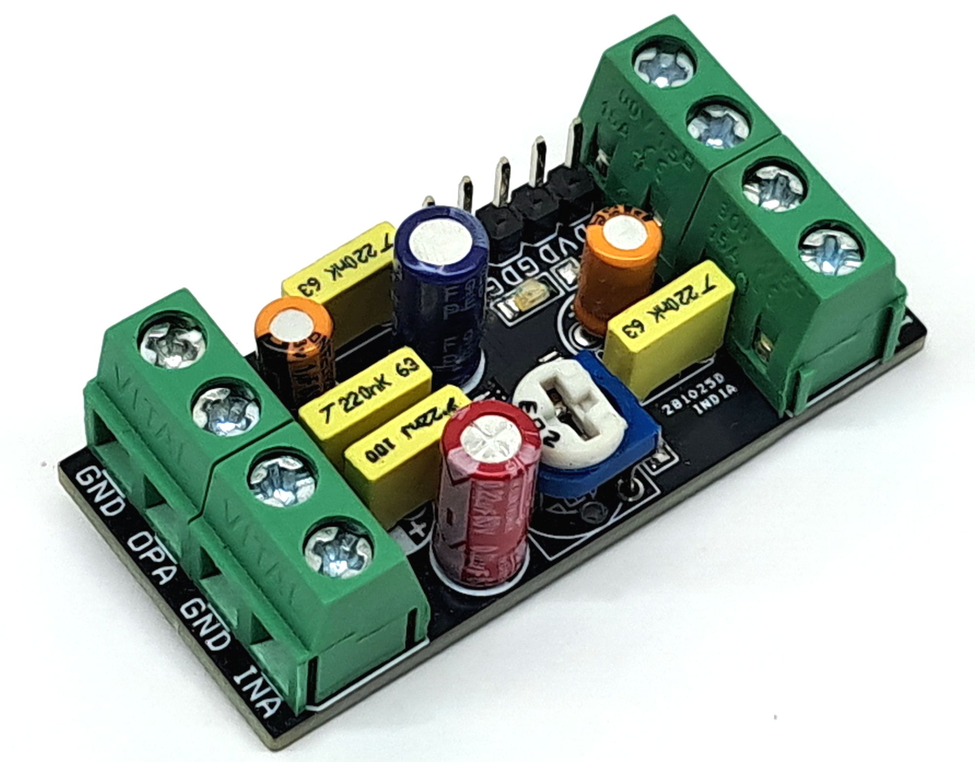

Photos
