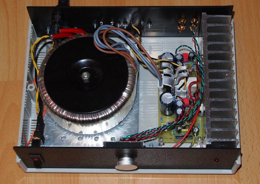

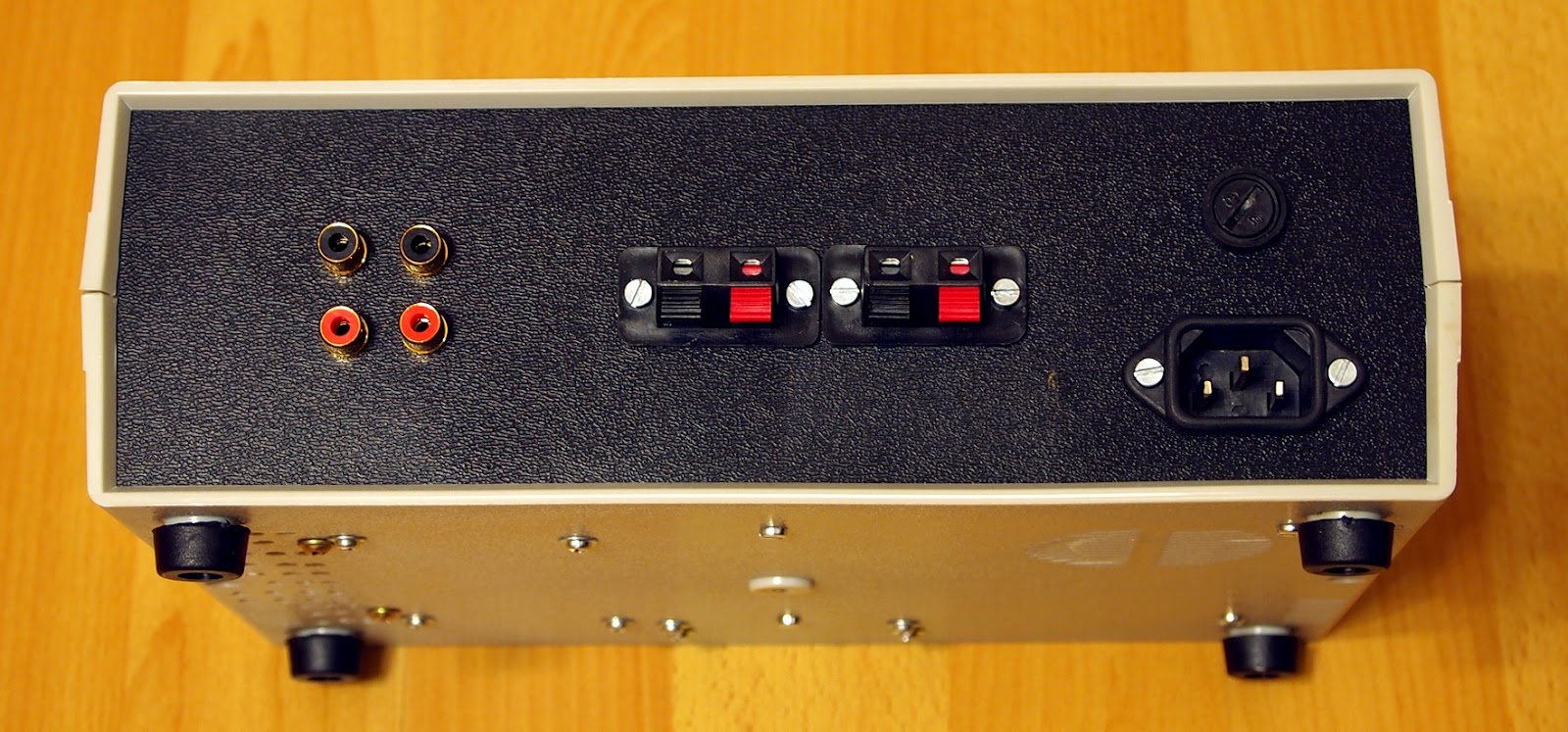

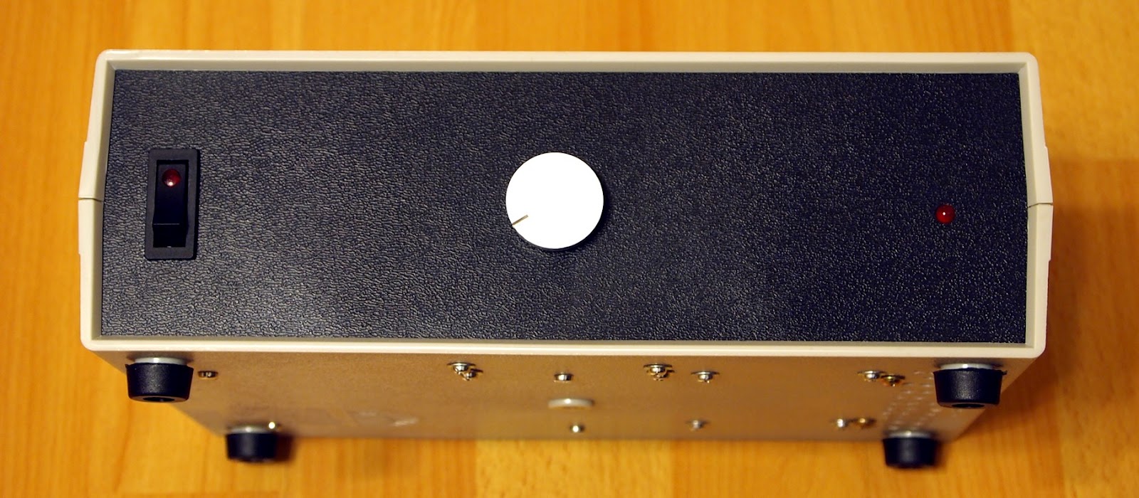

This project is an audio amplifier based on TDA2050 and LM1875.

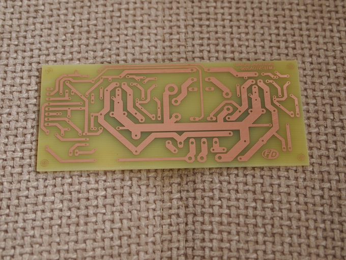

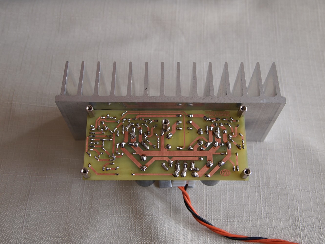

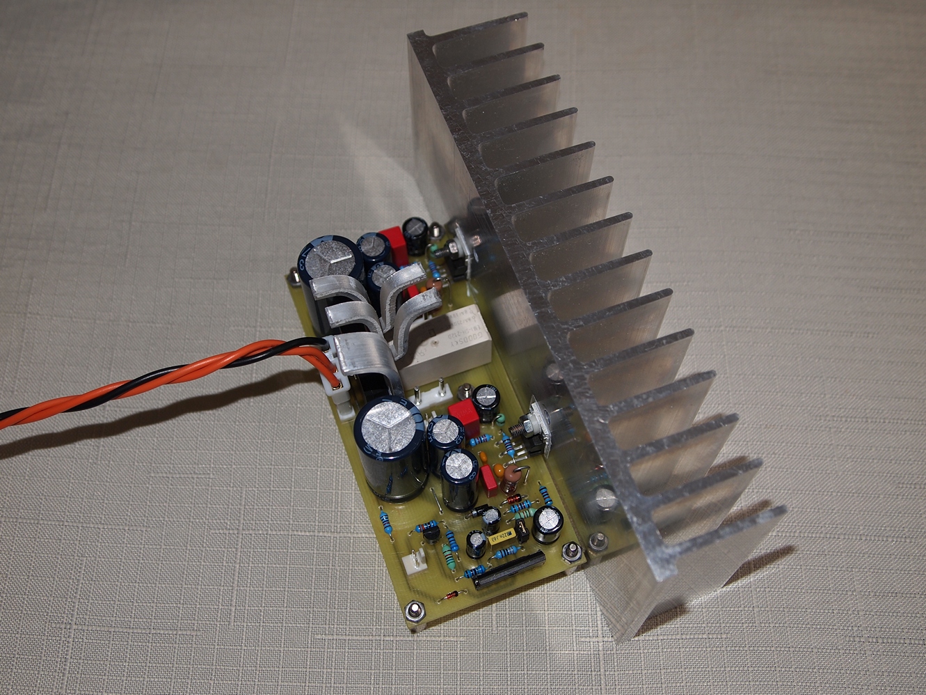

Description
This is not an ordinary project, but an attempt to make a PCB that is suitable for TDA2050 andLM1875 and has all the necessary circuitry on board – power supply, speaker protection, delayed turn-on and fast turn-off. This is achieved using the convenient uPC1237 IC.
TDA2050 and LM1875 are pin to pin compatible, the differences in their schematics are the values of a couple resistors and one capacitor. All this allows to make an universal circuit board, suitable for any of these two ICs.
It is 2x30W, but it depend of the power supply voltage and the impedance of the speakers connected to the output.

schematic versus pictures showned results was 2 blown capacitors, Q1 also not resulting good sounds due to upside down, IC 3 is just a bypass line for speakers, wasting time, but thats ok, atleast i’d tried, next time put the exact voltage recommended on each capacitors, long live and stay safe, thank you
Onesimus
Sir Chris, please guide what values of capacitors you used, am trying to build this project too. your guide will be appreciated
