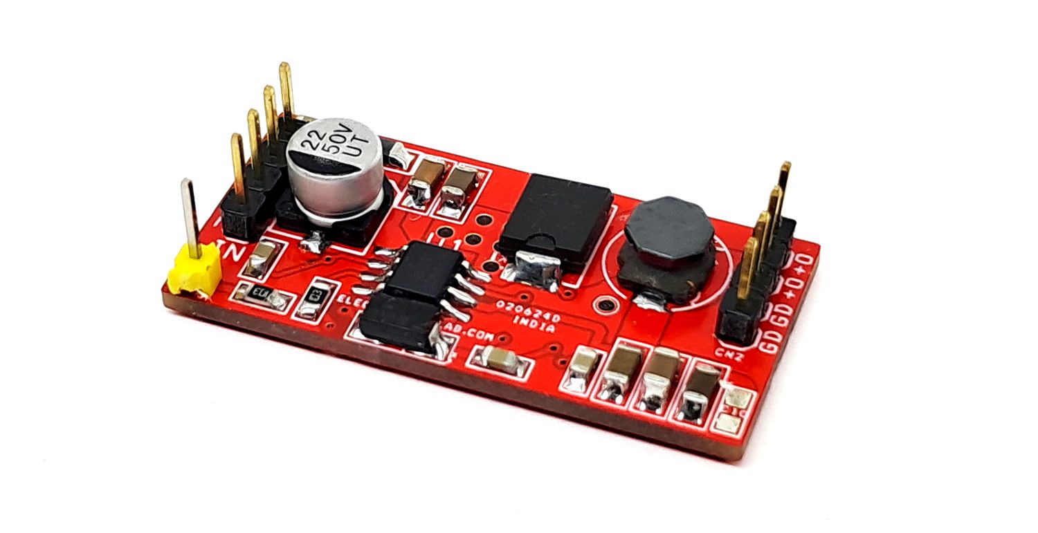

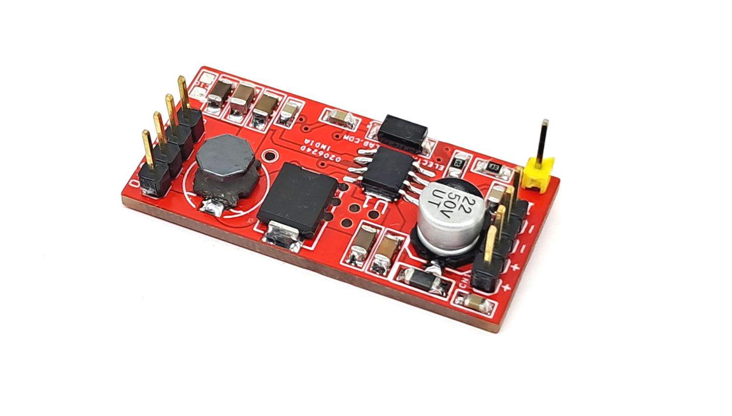

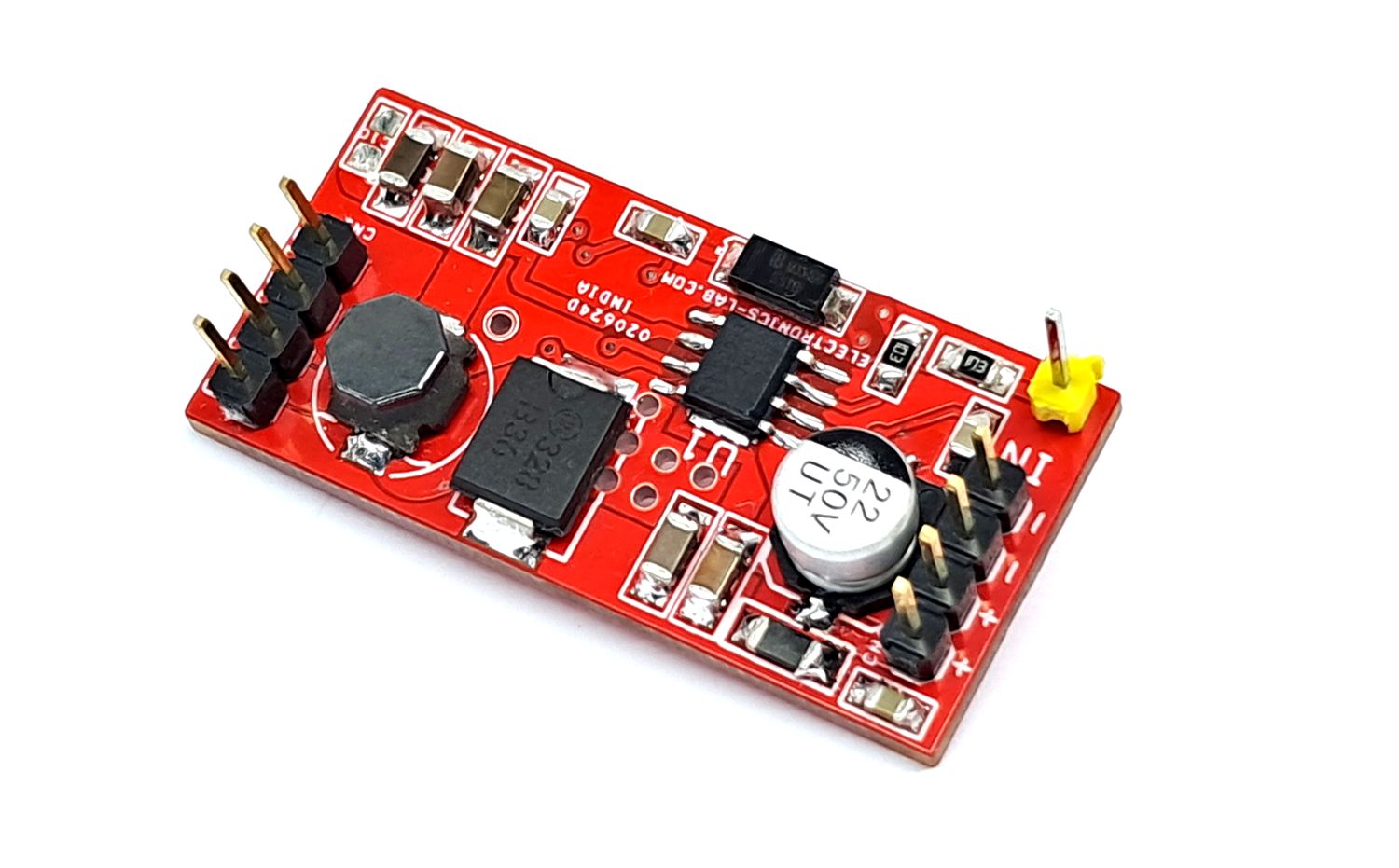

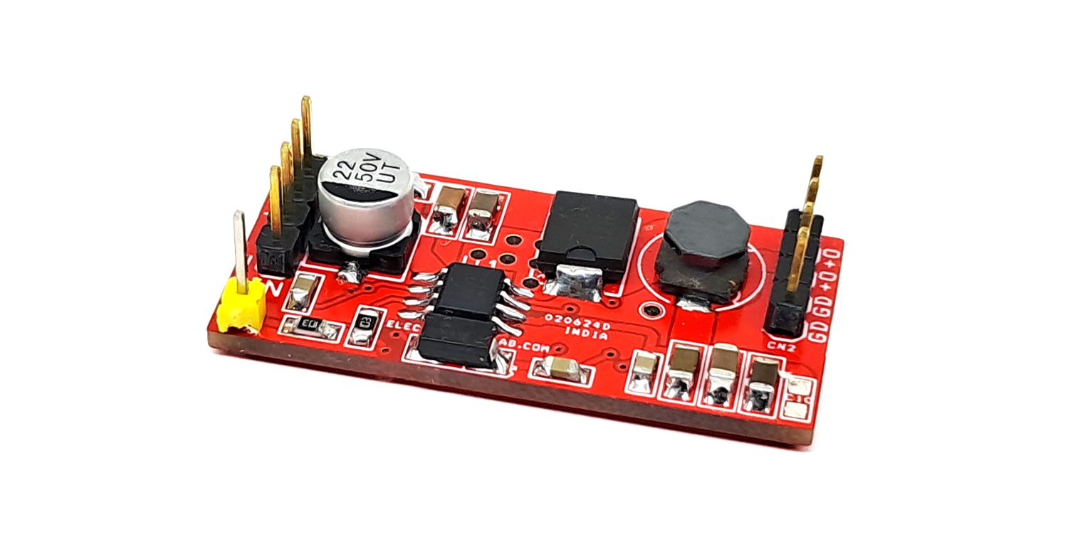

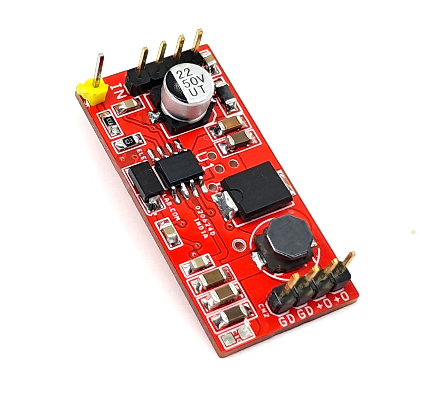

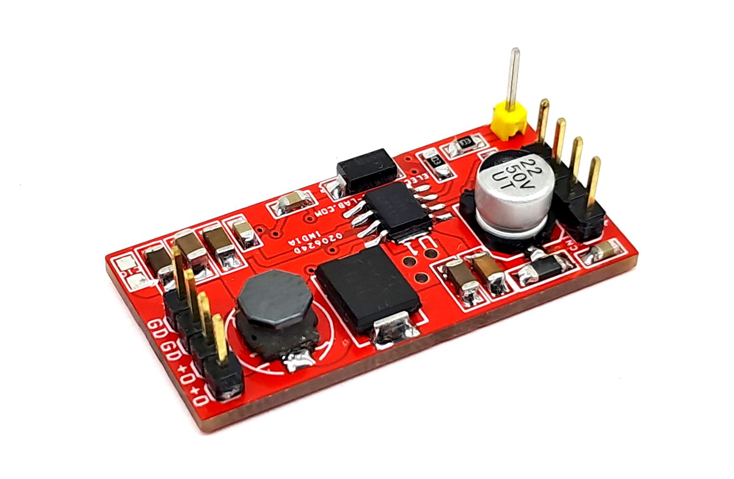

3.3V Automotive Step-Down Regulator – Low-Iq, Dual-Mode
This is a Dual Mode regulator intended for Automotive, battery-connected applications that operate with up to a 36V input supply. Depending on the output load, it operates either as a PWM Buck Converter or as a Low Drop-Out Linear Regulator, and is suitable for systems with low noise and Low Quiescent Current requirements often encountered in automotive driver information systems.
This is a Dual Mode regulator intended for Automotive, battery-connected applications that operate with up to a 36V input supply. Depending on the output load, it operates either as a PWM Buck Converter or as a Low Drop-Out Linear Regulator, and is suitable for systems with low noise and Low Quiescent Current requirements often encountered in automotive driver information systems. The project consists of NCV891330 chip which provides several protection features expected in automotive power supply systems such as current limit, short circuit protection, and thermal shutdown. In addition, the high switching frequency produces low output voltage ripple. Operating power supply range 3.7V to 36V. Output voltage 3.3V load current up to 3A. Operating frequency 2MHz.
- VIN operating range 3.7 V to 36 V
- 3.0 A maximum output current in PWM mode
- Logic level Enable pin can be tied to the battery
- Fixed Output Voltage of 3.3 V
- 2 MHz Free-running Switching Frequency
- Header Connectors for Supply Input and Output
- Header Connector for Enable ( Tie Enable to VIN)
- +/-2 % Output Voltage Accuracy
- 30 µA Iq in Light Load Condition

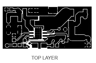

- PCB Dimensions 39.37 x 19.05 mm

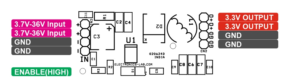

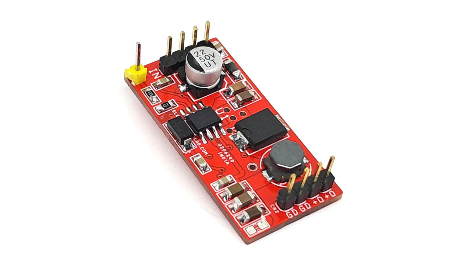

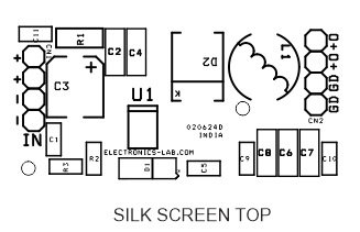

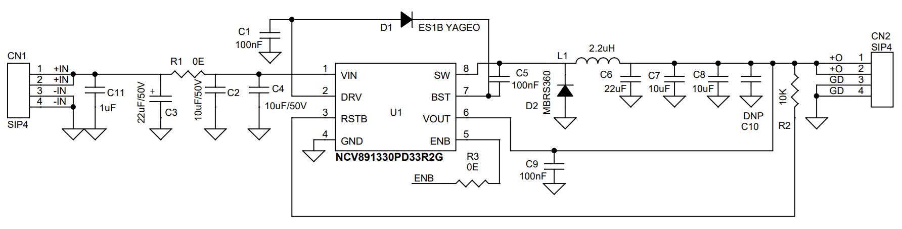

Connections
- CN1: Pin 1,2=3.7V to 36V DC, Pin 3,4=GND
- CN2: Pin 1,2=+3.3V Output, Pin 3,4=GND
- CN: Enable (Connect it to Vin 3.7V To 36V)
Schematic

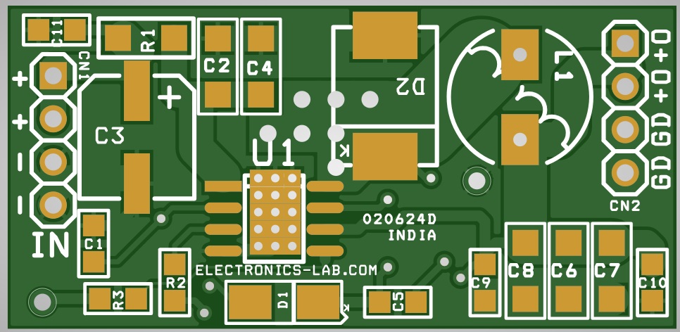

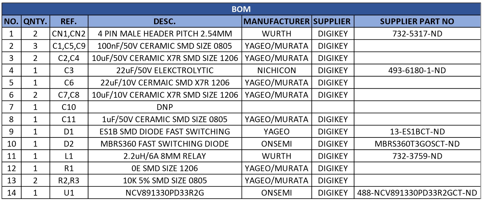

Parts List
| NO. | QNTY. | REF. | DESC. | MANUFACTURER | SUPPLIER | SUPPLIER PART NO |
| 1 | 2 | CN1,CN2 | 4 PIN MALE HEADER PITCH 2.54MM | WURTH | DIGIKEY | 732-5317-ND |
| 2 | 3 | C1,C5,C9 | 100nF/50V CERAMIC SMD SIZE 0805 | YAGEO/MURATA | DIGIKEY | |
| 3 | 2 | C2,C4 | 10uF/50V CERAMIC X7R SMD SIZE 1206 | YAGEO/MURATA | DIGIKEY | |
| 4 | 1 | C3 | 22uF/50V ELEKCTROLYTIC | NICHICON | DIGIKEY | 493-6180-1-ND |
| 5 | 1 | C6 | 22uF/10V CERMAIC SMD X7R 1206 | YAGEO/MURATA | DIGIKEY | |
| 6 | 2 | C7,C8 | 10uF/10V CERAMIC X7R SMD SIZE 1206 | YAGEO/MURATA | DIGIKEY | |
| 7 | 1 | C10 | DNP | |||
| 8 | 1 | C11 | 1uF/50V CERAMIC SMD SIZE 0805 | YAGEO/MURATA | DIGIKEY | |
| 9 | 1 | D1 | ES1B SMD DIODE FAST SWITCHING | YAGEO | DIGIKEY | 13-ES1BCT-ND |
| 10 | 1 | D2 | MBRS360 FAST SWITCHING DIODE | ONSEMI | DIGIKEY | MBRS360T3GOSCT-ND |
| 11 | 1 | L1 | 2.2uH/6A 8MM RELAY | WURTH | DIGIKEY | 732-3759-ND |
| 12 | 1 | R1 | 0E SMD SIZE 1206 | YAGEO/MURATA | DIGIKEY | |
| 13 | 2 | R2,R3 | 10K 5% SMD SIZE 0805 | YAGEO/MURATA | DIGIKEY | |
| 14 | 1 | U1 | NCV891330PD33R2G | ONSEMI | DIGIKEY | 488-NCV891330PD33R2GCT-ND |
