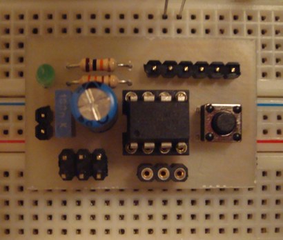

Breadboard header for ATTiny 25/45/85
This handy breadboard header for ATTiny 25/45/85 microcontroller is a new design based on the original idea from Tinkerlog. Maybe the most useful feature is that it can provide power to the vertical breadboard strips while connecting all six port pins to the horizontal strips.
4
This handy breadboard header for ATTiny 25/45/85 microcontroller is a new design based on the original idea from Tinkerlog. Maybe the most useful feature is that it can provide power to the vertical breadboard strips while connecting all six port pins to the horizontal strips. Other features are :

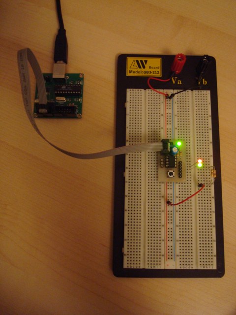

  • 6-pin ISP connector (works great with USBtinyISP programmer)
  • easily accessible reset button
  • header for optional ceramic resonator
  • power led indicator
  • smoothing caps
Measuring approx. 4 x 2.5 cm (1½ x 1 in) is a great addition to your breadboard projects saving lots of extra connections.

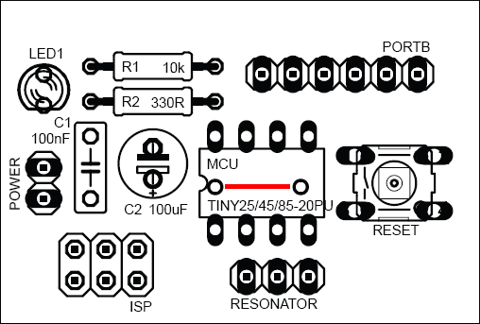

Bill of materials
R1                       10kΩ
R2                       330Ω
C1                       100nF
C2                       100uF/16V
LED1                  Green 3 mm
Button                  Omron type button
Headers               1×2, 1×3, 1×6, 2×3
IC Socket            8 pin
MCU                   ATTiny 25/45/85 PDIP

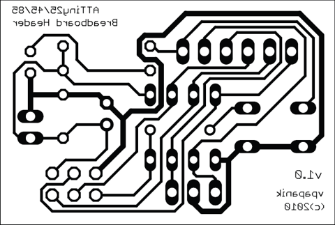

Don’t forget to solder the wire link under the IC socket (red line) !
Silk
1

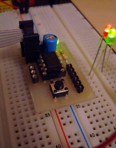

Photo of PCB – parts side
Photos
2

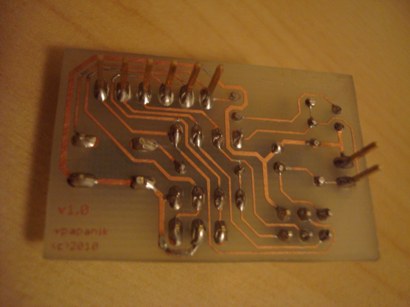

Photo of PCB – copper side
3
