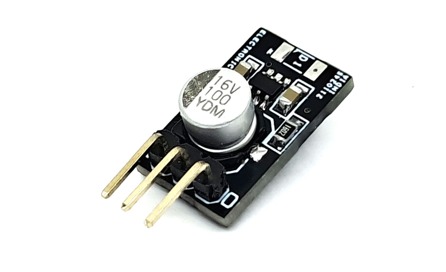

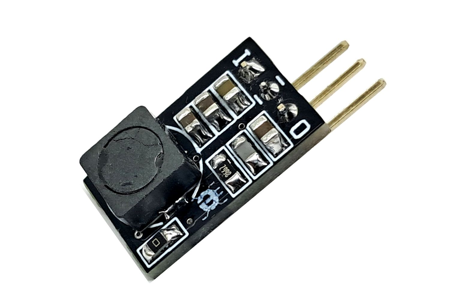

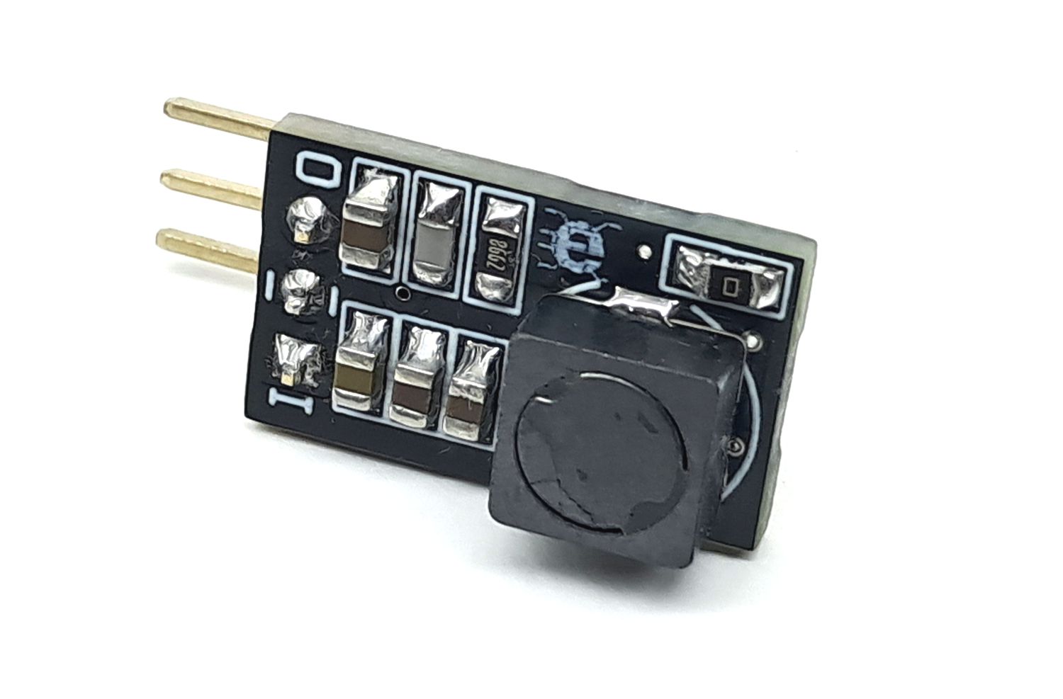

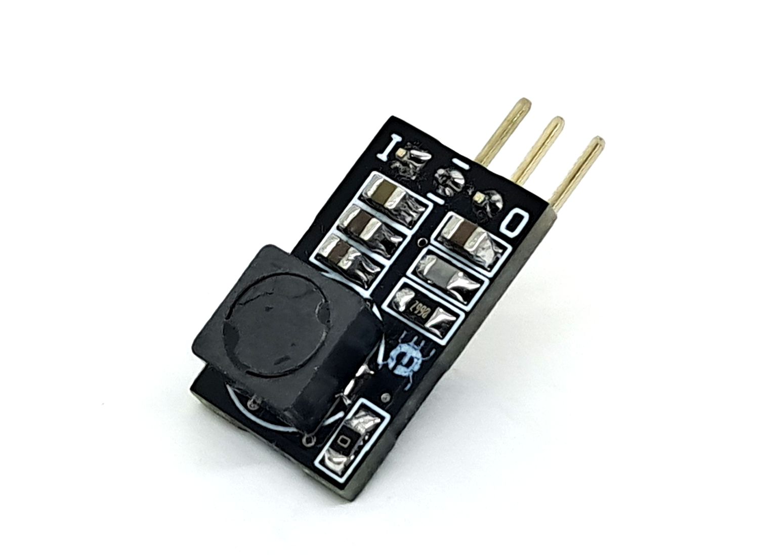

We are introducing a compact DC-DC converter that delivers a 5V output with a load current of up to 1.5A, powered by an input supply of 24V to 26V DC. This innovative project boasts key features such as soft start, thermal shutdown, and overcurrent protection.

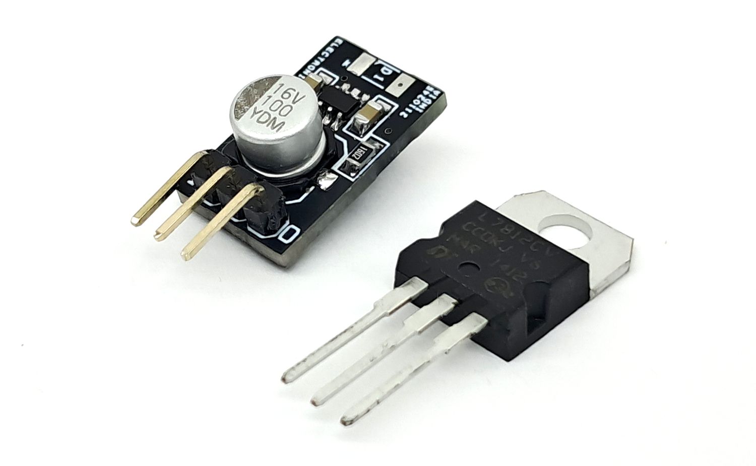

We are introducing a compact DC-DC converter that delivers a 5V output with a load current of up to 1.5A, powered by an input supply of 24V to 26V DC. This innovative project boasts key features such as soft start, thermal shutdown, and overcurrent protection. Built using the MP2345 TSOT23-6 DC-DC Converter, this mini board offers a significant advantage over traditional LDOs like LM7805, occupying a much smaller area while providing more power and generating minimal heat.
- Supply 24V-26V
- Output 5V DC
- Load Current 1.5A
- 3 Pin Header Connector for Input and Output (GND Common)
- Internal Power-Save Mode for Light Load
- 600Khz Fixed Switching Frequency at CCM
- Internal Soft Start
- Over Current Protection (OCP) and Hiccup Mode
- Thermal Shutdown
- PCB Dimensions 17.78 x 10.64 mm

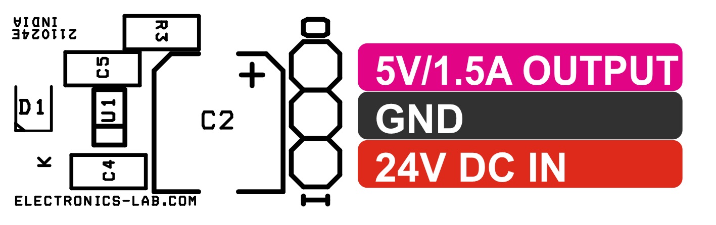

Connections
- CN1: Pin 1 = VIN 24V to 26V, Pin 2 = GND, Pin 3 = 5V DC Output
