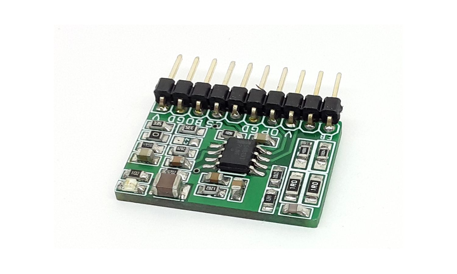

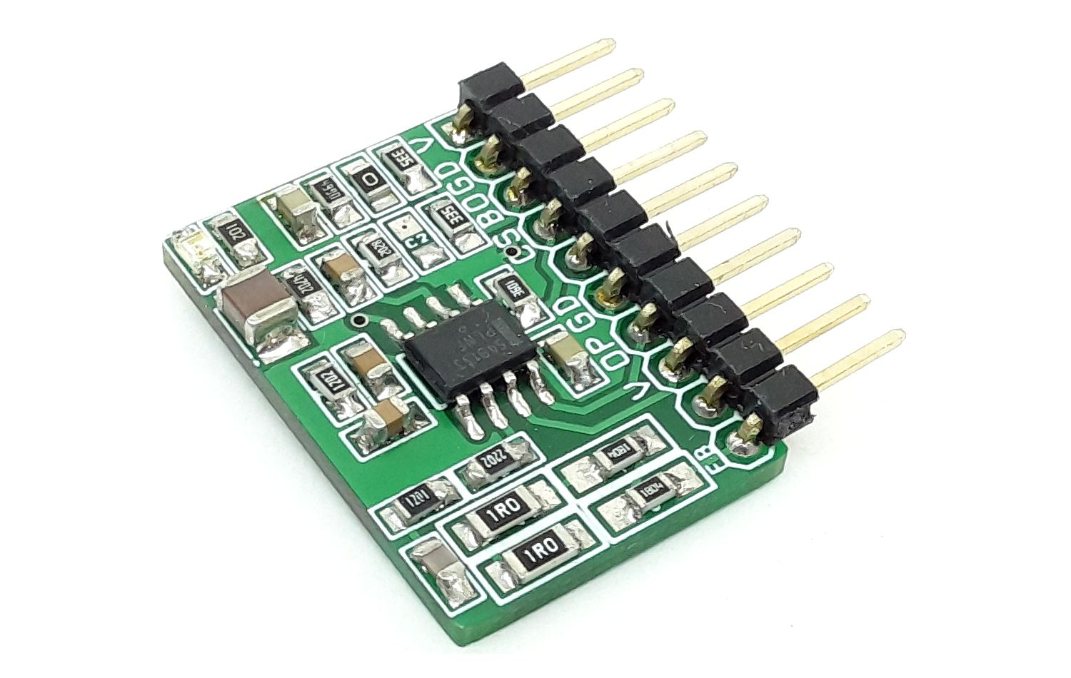

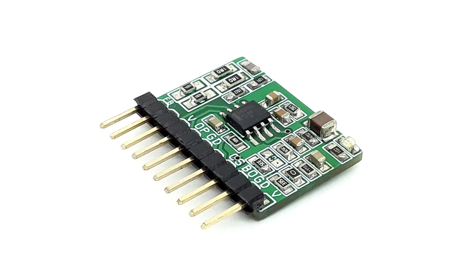

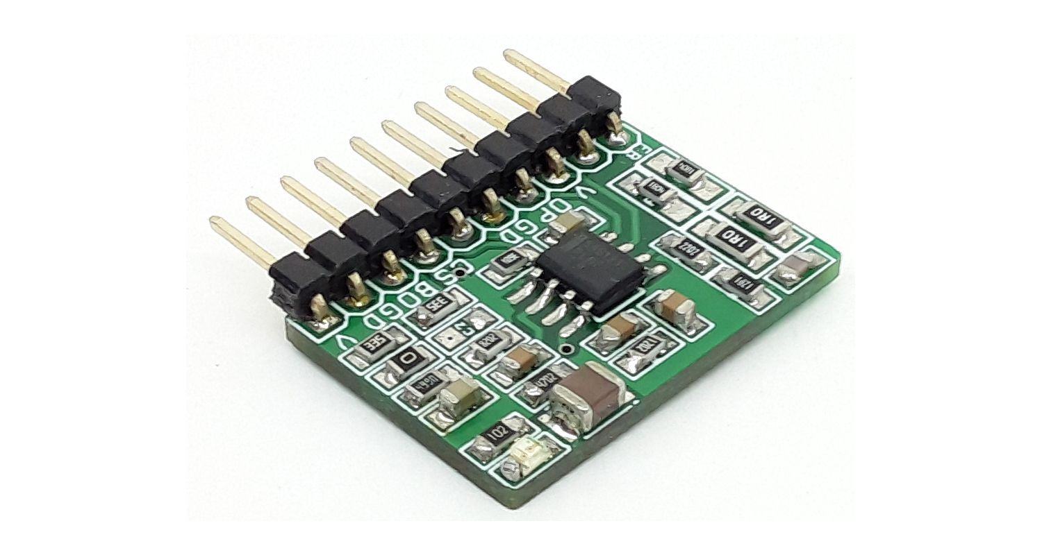

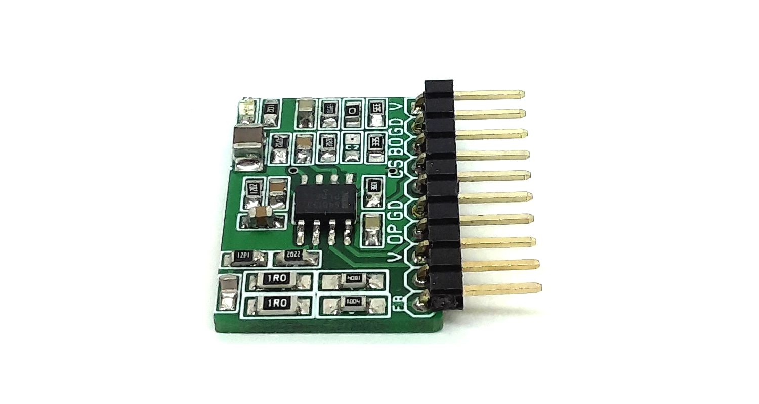

This compact module shown here is a Continuous Conduction Mode (CCM) Power Factor Correction Step up Pre-Converter. All-important inputs and output pins are broken out for use in your application, making this board hackable!

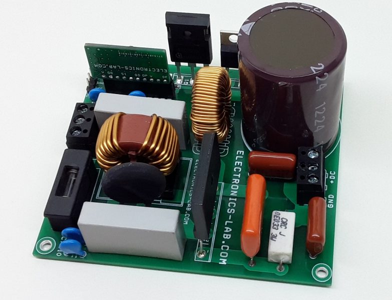

This compact module shown here is a Continuous Conduction Mode (CCM) Power Factor Correction Step up Pre-Converter. All-important inputs and output pins are broken out for use in your application, making this board hackable! Please refer to the datasheet of the NCP1654 chip for easy alteration and configuration of the board as per requirements. This board controls the power switch conduction time (PWM) in fixed frequency mode and is dependent on the instantaneous coil current. This module drastically simplifies the PFC implementation scheme. It also integrates high safety features that make the NCP1654 module ideal for robust and compact PFC stages like an effective input power runaway clamping circuit. Please refer to the application schematic to create a powerful PFC using this pre-driver module. The chip is available with various options for frequency such as 65Khz, 133Khz, and 200Khz. Choose the appropriate chip as per frequency requirement This project is tested with a 65Khz oscillator chip.

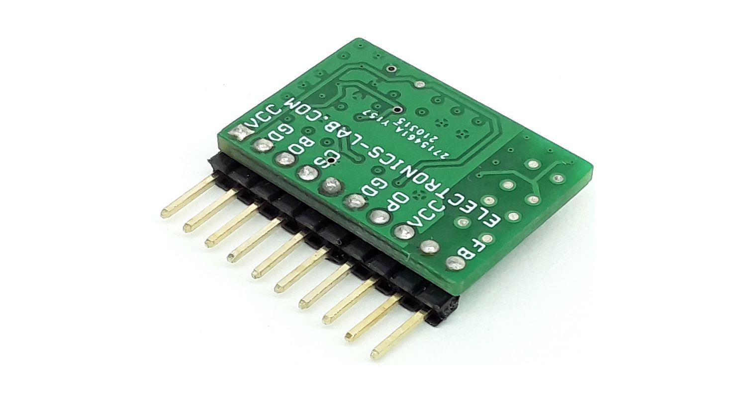

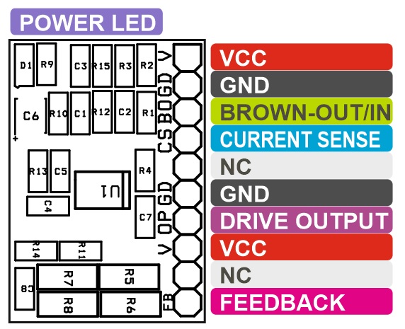

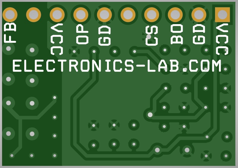

Connections Connector CN1
- Pin 1 = VCC 15V DC, Pin 2 = GND, Pin 3 = BO Brown-Out/IN, Pin 4 = CS, Pin 5 = NC, Pin 6 = GND, Pin 7 = Output (MOSFET Gate), Pin 8 = VCC 15V DC, Pin 9 = NC, Pin 10 = FB/Feedback Voltage
- D1 Power LED

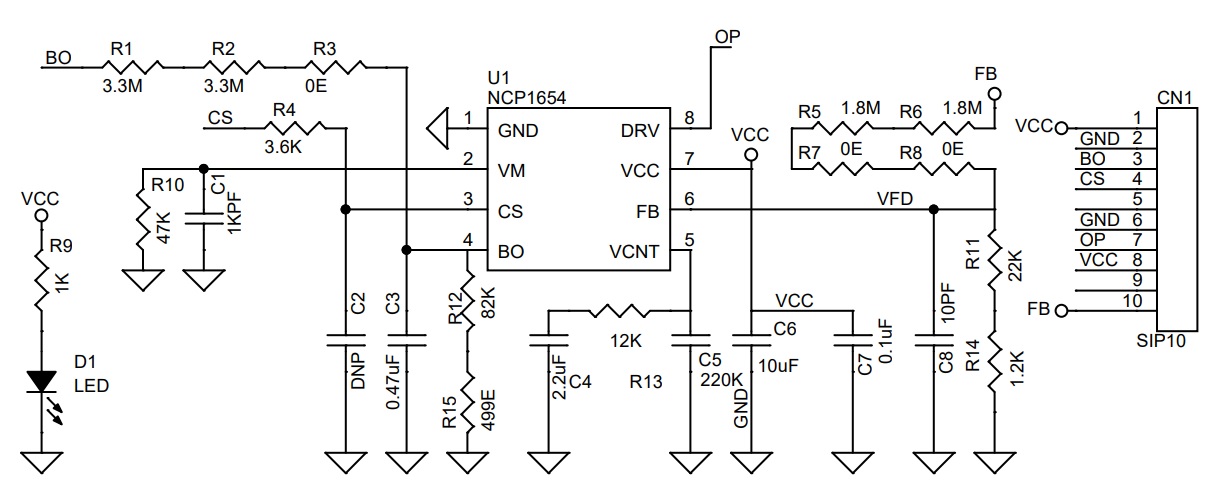

Schematic

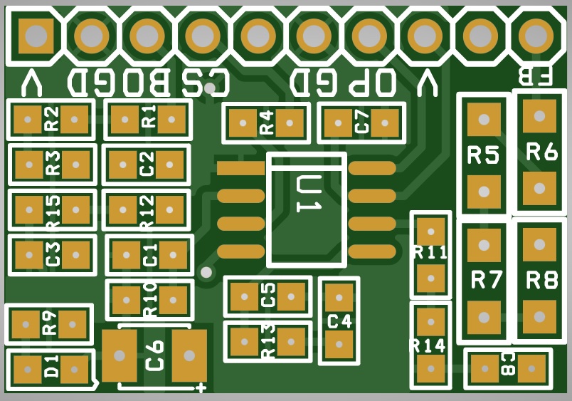

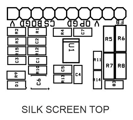

Parts List
| NO. | QNTY. | REF. | DESC. | MANUFACTURER | SUPPLIER | SUPPLIER'S PART NO |
| 1 | 1 | CN1 | 10 PIN MALE HEADER RIGHT ANGLE PITCH 2.54MM | WURTH | DIGIKEY | 732-2670-ND |
| 2 | 1 | C1 | 1KPF(1nF)/50V CERAMIC SMD SIZE 0805 | YAGEO/MURATA | DIGIKEY | |
| 3 | 1 | C2 | DNP | |||
| 4 | 1 | C3 | 0.47uF/50V CERAMIC SMD SIZE 0805 | YAGEO/MURATA | DIGIKEY | |
| 5 | 1 | C4 | 2.2uF/50V CERAMIC SMD SIZE 0805 | YAGEO/MURATA | DIGIKEY | |
| 6 | 1 | C5 | 220KF(0.22uF)/50V CERAMIC SMD SIZE 0805 | YAGEO/MURATA | DIGIKEY | |
| 7 | 1 | C6 | 10uF/25V CERAMIC SMD SIZE 1210 OR 1206 | YAGEO/MURATA | DIGIKEY | |
| 8 | 1 | C7 | 0.1uF/50V CERAMIC SMD SIZE 0805 | YAGEO/MURATA | DIGIKEY | |
| 9 | 1 | C8 | 10PF/50V CERAMIC SMD SIZE 0805 | YAGEO/MURATA | DIGIKEY | |
| 10 | 1 | D1 | LED RED SMD SIZE 0805 | OSRAM | DIGIKEY | 475-1278-1-ND |
| 11 | 2 | R1,R2 | 3.3M 5% SMD SIZE 0805 | YAGEO/MURATA | DIGIKEY | |
| 12 | 2 | R7,R8 | 0E SMD SIZE 1206 | YAGEO/MURATA | DIGIKEY | |
| 13 | 1 | R4 | 3.6K 1% SMD SIZE 0805 | YAGEO/MURATA | DIGIKEY | |
| 14 | 2 | R5,R6 | 1.8M 5% SMD SIZE 1206 | YAGEO/MURATA | DIGIKEY | |
| 15 | 1 | R9 | 1K 5% SMD SIZE 0805 | YAGEO/MURATA | DIGIKEY | |
| 16 | 1 | R10 | 47K 5% SMD SIZE 0805 | YAGEO/MURATA | DIGIKEY | |
| 17 | 1 | R11 | 22K 5% SMD SIZE 0805 | YAGEO/MURATA | DIGIKEY | |
| 18 | 1 | R12 | 82K 1% SMD SIZE 0805 | YAGEO/MURATA | DIGIKEY | |
| 19 | 1 | R13 | 12K 5% SMD SIZE 0805 | YAGEO/MURATA | DIGIKEY | |
| 20 | 1 | R14 | 1.2K 5% SMD SIZE 0805 | YAGEO/MURATA | DIGIKEY | |
| 21 | 1 | R15 | 499E 1% SMD SIZE 0805 | YAGEO/MURATA | DIGIKEY | |
| 22 | 1 | U1 | NCP1654BD65R2G | ONSEMI | DIGIKEY | NCP1654BD65R2GOSCT-ND |
| 23 | 1 | R3 | 0E SMD SIZE 0805 | YAGEO/MURATA | DIGIKEY |

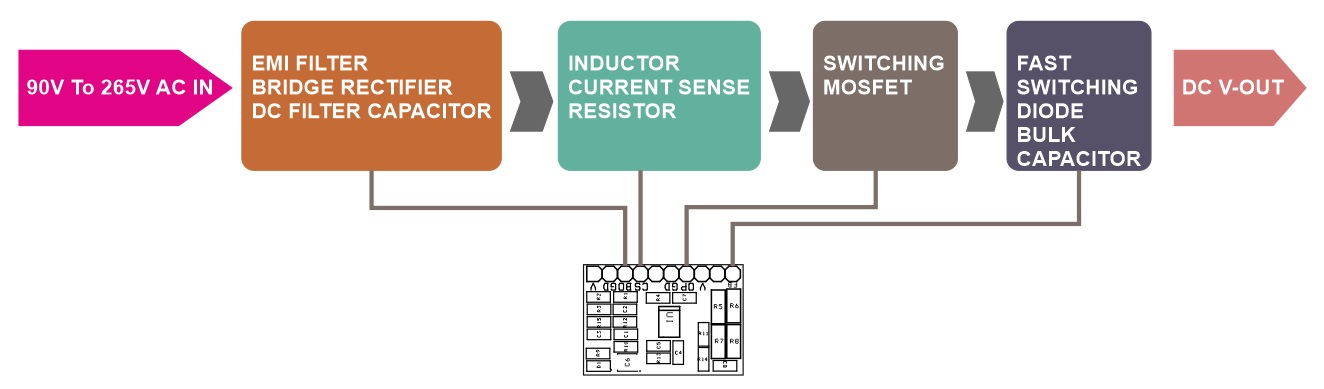

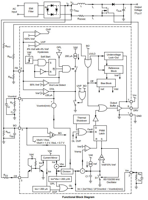

Block Diagram

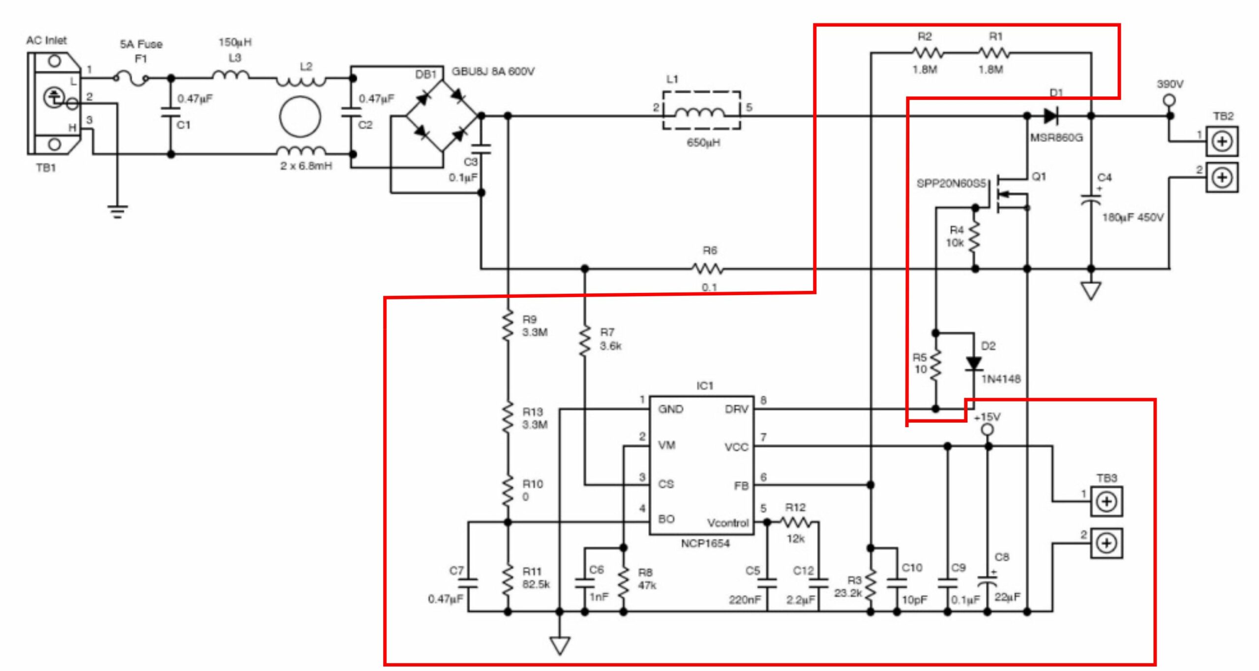

Application Schematic
